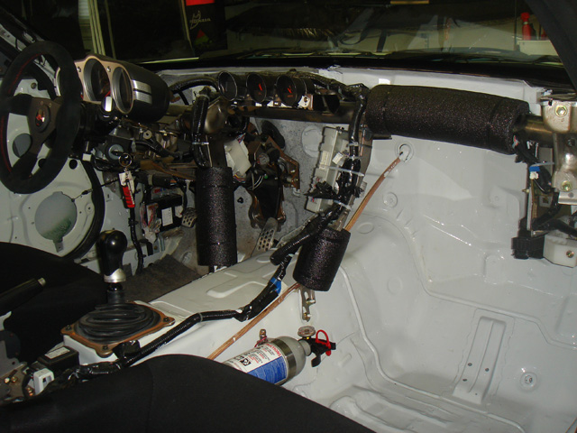

Winter projects included a new Quaife differential and getting an Uprev tune.
http://www.youtube.com/watch?v=bewfDGmB3ks

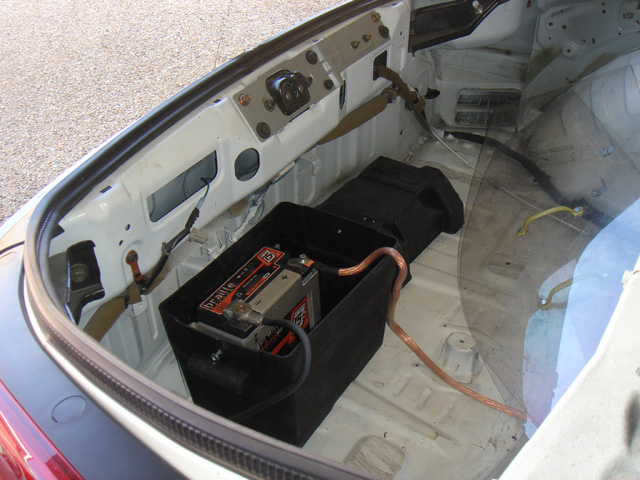

Also removed all of the remaining insulation on the passenger side and relocated the battery to the trunk.
Results with driver (168 lbs) and 1/2 tank of gas were as follows:
total weight 3049 lbs
front 1679 (55.1%)
rear 1370 (44.9%)
LF 886 RF 793
LR 689 RR 681
Now just excited to begin my third season having fun on the track

Nice man! The interior looks nice. I have read many of your posts. I just made it through NASA's HODE program at the end of last year and got signed off to run TT this year. Are you running a C-west from lip?
+1 Interior looks better than new! Repainted? I like what you've done. First time I've seen someone run without the plastic dash even with a gutted car.
