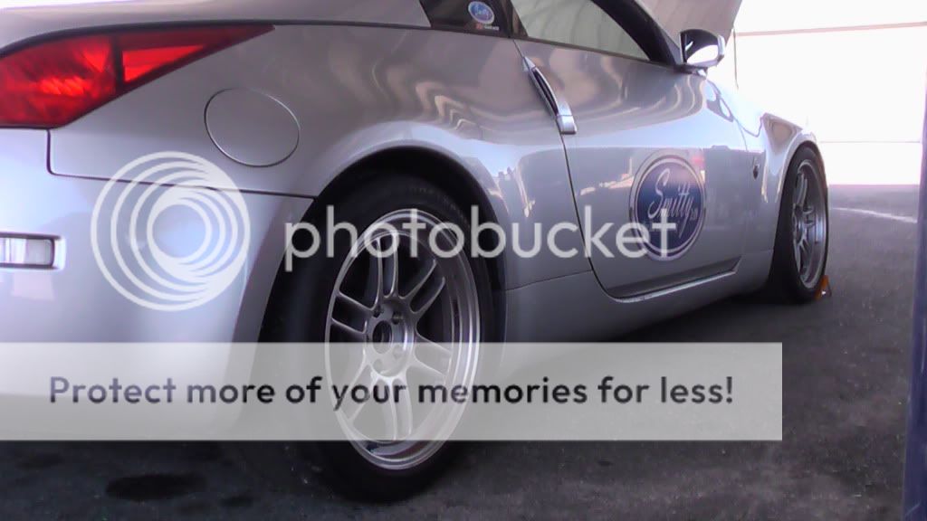

I am running the same setup
RPF1 18x10.5 with TOYO R888 295/30 18 all around. With -3.2* up front there is no rubbing whatsoever. I am lowered on Ohlins around 1". In the rear I am rolled as much as possible with slight pull. I am only running -1.3* camber in the rear and it is rubbing pretty badly. I need more camber in rear though and I am hopping with -1.7* there won't be much rubbing.

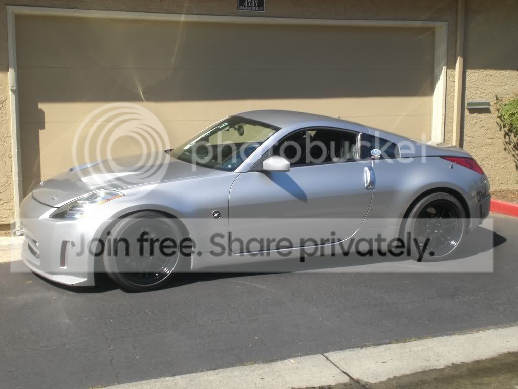

18x9.75 +20 XXR with 275 NT01s
