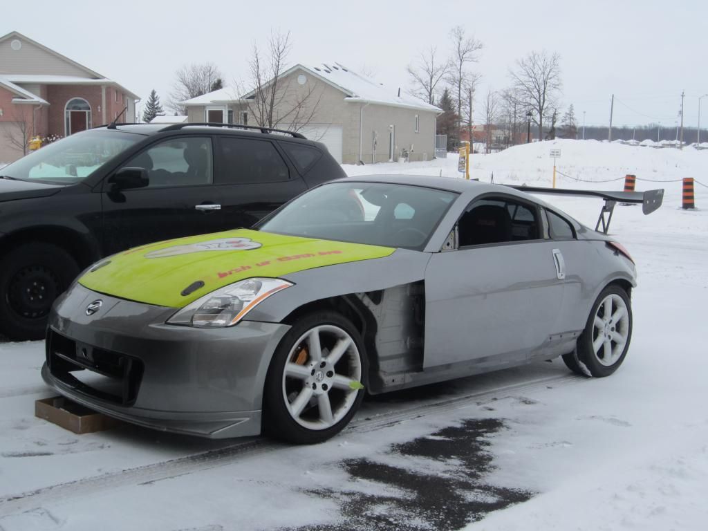

Ok so I started along a little bit. Right now I'm working on getting the template positioned so we can weld up some custom brackets.

hood is gutted. so it's flimsy. just holding the bumper in place with screwdrivers so it's removeable in the splitter making procress.
The fenders are also cut. Cut the sides off to save 11 lbs.
As it sits...
not meant to be pretty but hope to make some custom sideskirts out of alumapanel as well.

Now looking at it of you'd cut the fender to match the lines on the front bumper it would of looked 100 times better! Also blacking out the frame that's visible would help...
I know track car
But
She can look pretty while at it
Good work on the splitter!

Agreed, and probably close that gap in front of the door, aerodynamically probably going to kill you
