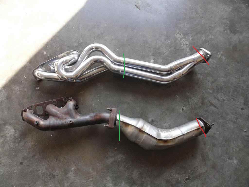

Originally Posted by Z1NONLY
The PPE "long tube" setups (I haven't seen any other kind of PPE header?) seem to derive their name from being longer than the stock setup. From the pics I have seen....more than 6" longer.
Here's an image of a PPE Long-tube next to a DE Headder and cat pipe.
Through the magic of MS paint, i've added a few marks relative on both pipes. Green for catalytic inlet, and red for outlet.
By the rule set, you can combine multiple cats inline into one high-flow cat, as long as the INLET of the replacement cat is within 6" of the outlet of the last original cat.
When i look at these pipes, with all the heat sheilding, it appears that the cat extends down fairly close to the flange, thus the flange being considered the exit doesn't seem unreasonable.
On both the PPE and the factory setup, this would then feed into the Y-Pipe. Being all the factory mount points can be maintained for exhaust, that means the pipes in this section have to have to be relatively in the same places, lengths, etc.
So, by these assumptions, as long as I can make them clear the body, i could put two catalytic converters in the y-pipe, within 6" of the header flanges and be considered legal.
