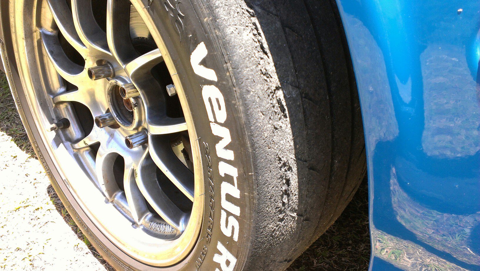

my RS3's after A LOT of track days, around 20k street miles and couple drag burnouts
I believe that bad alignment led to this, as I haven't aligned it in a long while so my predicction is that it "lost" some negative camber forcing the tires to run on the outer strip. They always wore evenly except for the last event, the inside of the tire actually have plenty of thread left.

Forgive my newbie Q's, but am I right in thinking that isn't a tyre pressure issue because the sidewalls look in good condition?

I believe they were around 38-42 hot... I only checked them one though. I got a bit careless on those details on that last event. and the day was HOT AS F**K!
