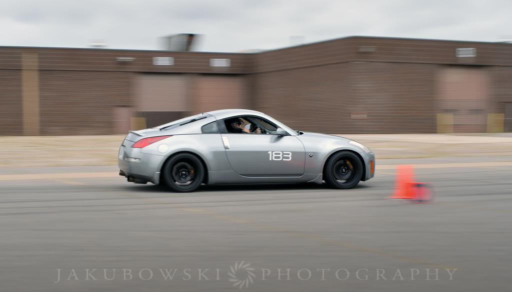

I ran that exact tire/size on 18x9.75 +20 wheels on stock suspension with no rubbing at all.

Looks amazing! Looks like a +20 lines up nicely.
What rims do you run? I'm looking at the RPF1's but man I wish they looked sweeter on the Z.
I run el'cheapos. Those are XXR 530, 18x9.75 +20. They are only like $650 a set shipped to your door.
I also just ordered a set of XXR 535 in 18x10.25 +20 for some 285 Conti slicks

You need to at least roll your fenders.

My fenders are not rolled, and they do not rub

Your at stock ride height.
