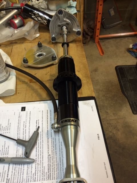

I need to get top mounts for the 8300 Penske shocks I'm having built. Has anyone bought top mounts independently? Possibly for Penske?
I know BC racing and possibly others sell the top mounts, but I'm not sure if they are durable enough for the front shocks, since the BC racing springs rest on the mount and the Penske have a top hat, so all the front corner axial load goes through the ball.

Both actually. I'm looking for a top plate (camber plate) with a spherical bearing. The Penske shocks have OEM size rod ends, 12mm front and 10mm rear and are meant to fit into the OEM top plates.
I think I could get away with using OEM top mount in the rear with the rubber bushings, however I think the front bushings would overload.
In any case, I prefer spherical bearings all around.

Thanks for the suggestions everyone. I contacted Cusco, and they will follow-up with Japan, but don't have any top mounts for the Z available (only have complete sets).
Multiple shops (including ProParts) can make a custom bushing to retrofit existing top mounts, which I was hoping to avoid (want an existing solution).
So most likely I will buy BC racing tops and have a machine shop make custom bushings. Just hope the bearings are a good quality.

Hmm, didn't think to check with KW. Did with SPL, but they don't offer anything and referred me to someone else. Cusco will make a very custom set for $$$$ and ship from Japan. Too much money and too long of a wait.
In the end, I found someone who will make a custom set for me. They look very nice and I'll post a pic when I get them.

Meant to post earlier...anyway found a fellow Z builder who custom machined top mounts. Had to machine custom spacers since my Penske shocks were Penske built and designed, and his were 3rd party, so the shock free lengths didn't match. Easy fix, and 2 events in with no problem.

So the top mount you see here is for the front shocks which are roughly 2in shorter then OEM. I needed a good spherical ball bearing mounts to take the load of the spring and shock. In the rear, I used the OEM mount since the springs are in the OEM position. The rear shocks are roughly 3.25in shorter them OEM.
I setup my car rather low in the rear with no sway bar, so it seems to have enough droop not to upset the car too much. Also im running 1200fr/900rr spring force, and the car doesn't get too tail happy over bumps. Maybe I'm not pushing it enough . The free lengths also don't require me to run a helper spring.
