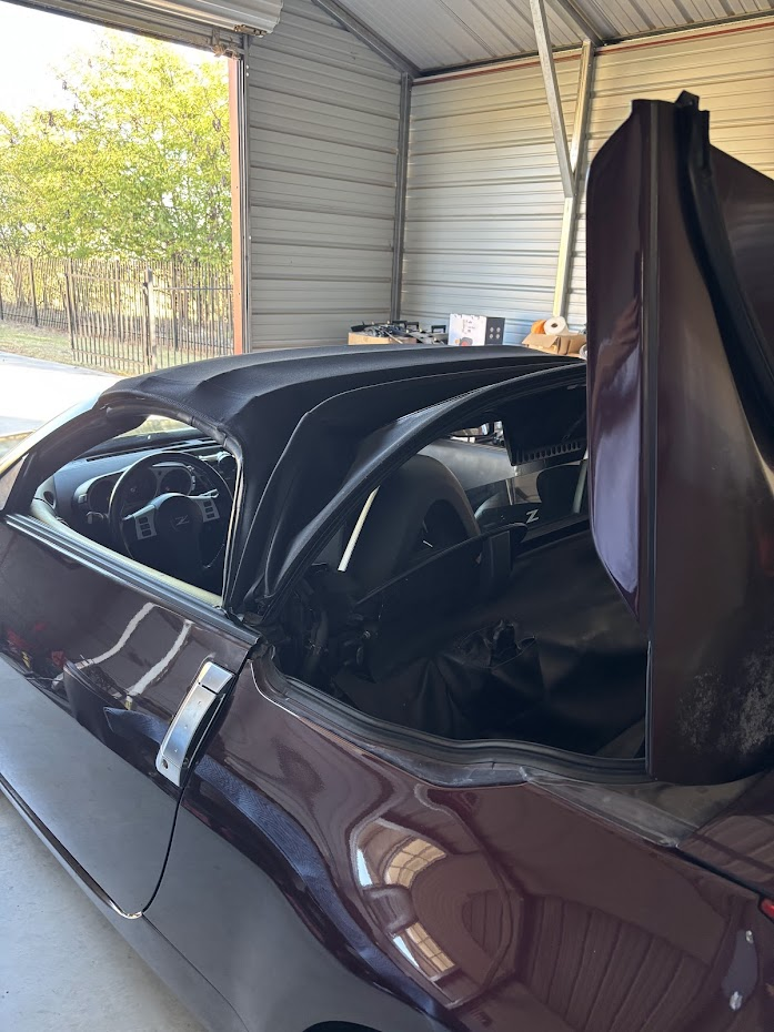

Well, big update, big worry, and big question.
Just to recap, I attempted to fix the pull-down mechanism motors inside the tonneau cover that came originally with my car. That didn't work, and since then I had just been driving it around with an improvised rubber seal (since there was the gap because the tonneau cover pull-down didnt work.)

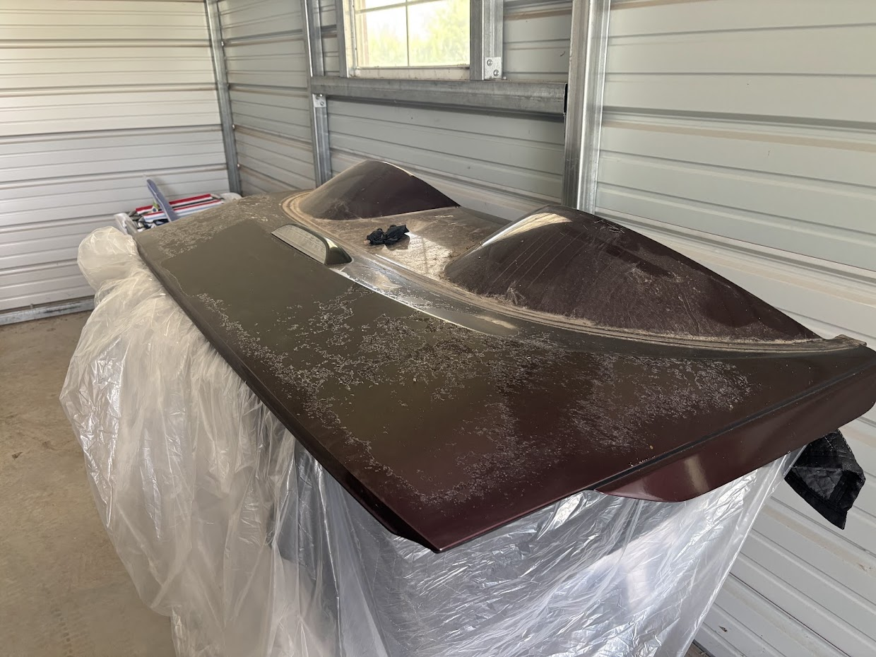

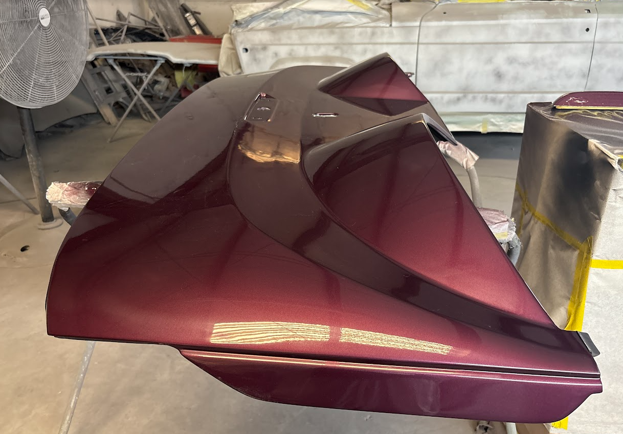

I ended up buying a full tonneau cover with working latch motors from a z here locally being parted out for a good deal. As you can see though, the paint was in horrible condition despite the parts car having not too many miles (150000ish.)
Good motors, bad paint.
So I took it down to get painted and it looks gorgeous, far better than what it was and even nicer than my slightly clearcoat-failed original tonneau cover.

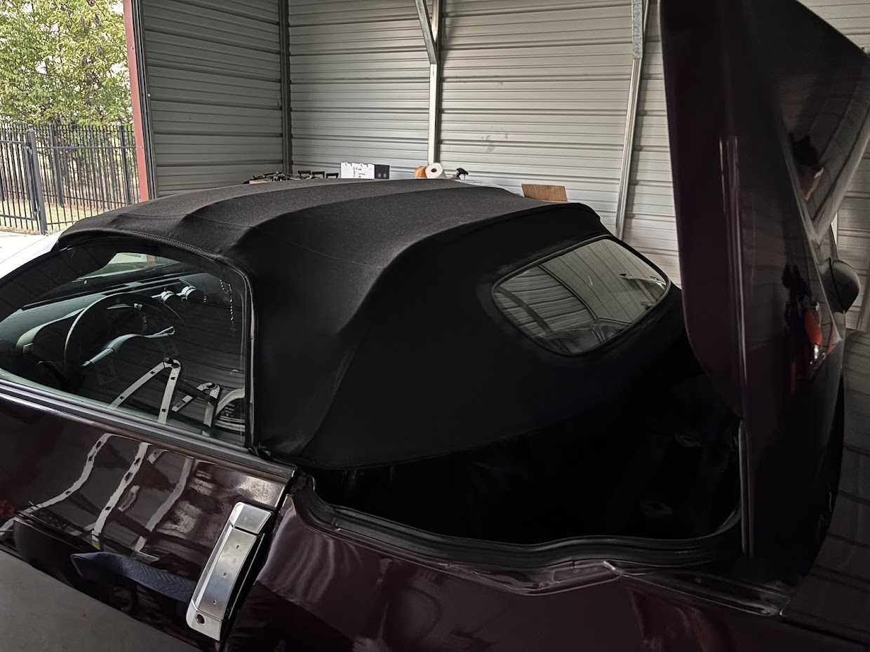

Today, I went ahead and decided to go ahead and install it. First, I decided it would be easiest if I let the motors lift the tonneau cover currently on my car so as to make it nice and easy to replace. Otherwise, I would have had to use allen keys to manually crank the motors and move it. (I believe this may have been a mistake: more later.)
So, I press the "open" button and the rear/glass area of the convertible top begins to move up so that the tonneau cover can subsequently. It starts smooth but then stops, and it takes a few bumps of the button for it to move the rest of the way up perfectly fine. (Sensors?)
Yay!
Yay!
Now, the tonneau cover rises perfectly, so I bolt it off and put the new, beautiful one on and install the actual hook since I took it off when I retrofitted the rubber seal.
In my excitement, I hop in the car, and press "close" so that the tonneau cover would move down and I could see if it latched the convertible top.
Here is where things went wrong.

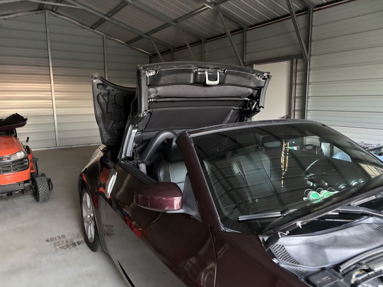

Presumably because the sequence is out of order, the top moves back to the little hole it retracts to (like I had pressed "open" when I didn't,) getting stuck "half open" and then everything bricks, with nothing moving when I hit either button. The car was quite confused since it kept tilting the seat forward, jerking the top slightly, etc.
i hate this damn thing
D'oh!
However, I remembered researching that the top sequence can be reset by taking off a battery terminal and re-applying it 15 minutes later. I do such, and some progress is made when I hit "close" once more. The top moves forward so that I can latch it to the windshield, and then gets completely stuck like this.
Ugh. This is annoying.
Obviously, the tonneau cover can no longer move down because the top is in the way. It's almost like the convertible top thinks the tonneau cover is there, but clearly it isn't.
This leads me to my question: Do I need to manually move the top back to how it looked in picture 3, then manually crank the motors for the tonneau cover so that the tonneau cover is below the top, ready to have the top mount it and then latch onto it?
And, my worry: Is there a sensor that, regardless of me taking off the tonneau cover and putting a new one back on, is messed up and will therefore always cause something like this?
This thing is so damn annoying.
Last edited by MoneyPitZ; Oct 18, 2025 at 04:33 PM. Reason: accidently hit reply too early lol

Moved the tonneau cover down, put the 5th bow/convertible top in place for the tonneau cover to recieve it and latch it. Same **** happened again, where the latch is pulled 1/2 way down, right back where I started a year ago. The top does nothing at this point, all I hear is a clicking when I press close/open and that is it.
