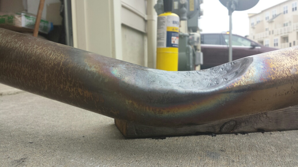

Exhaust was non repairable so I replaced with Berk HFC ~import parts pro~, and Invidia Gemini ~I want to say gt monsters but I can’t remember~ (the perfect combo for me).
