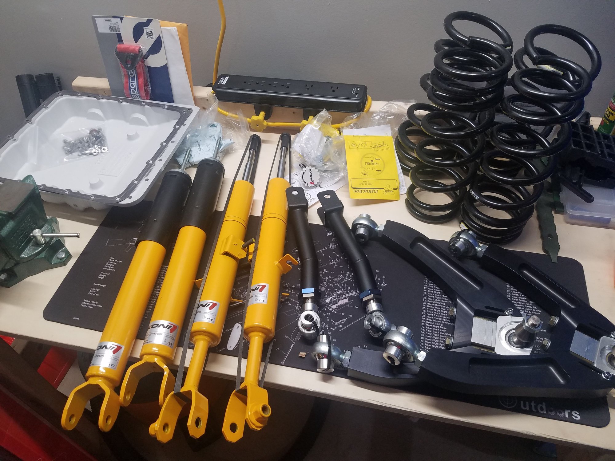

Well my winter projects are starting to come in the mail. I have SPL front control arms, SPL rear camber arms, and a set of Koni yellows on hand. I'm just waiting on the Swift springs to be delivered. I'm going to try the alignment myself, already have toe in plates and a camber/caster gauge.
Also ordered a PML trans pan that I'm hoping takes care of my overheating.
How do these alignment specs look for what I'm doing?
Front: -2.5 camber, 1/8in toe in
Rear: -2 camber, no toe in

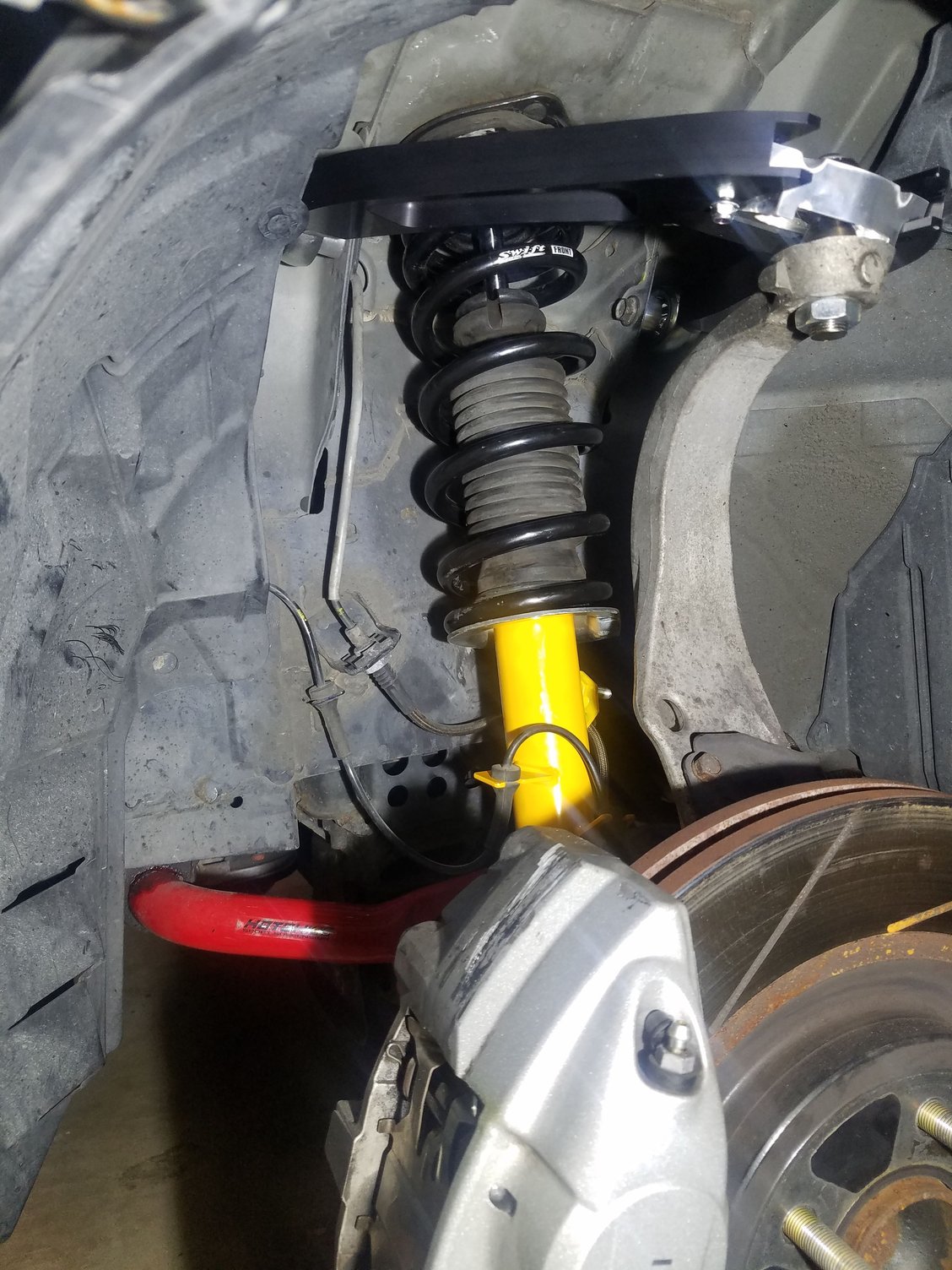

Finished one side last night. Took a guess at the camber but I'm expecting I'll have to adjust it anyways afterwards.

Alright. Got the front end sorted. Camber is somewhere between -2.6 and 2.70. Its the exact same on each side. Just hard to get an exact measurement with a bubble gauge. Toe-out set to 1/16. I'll tackle the rear tomorrow.
