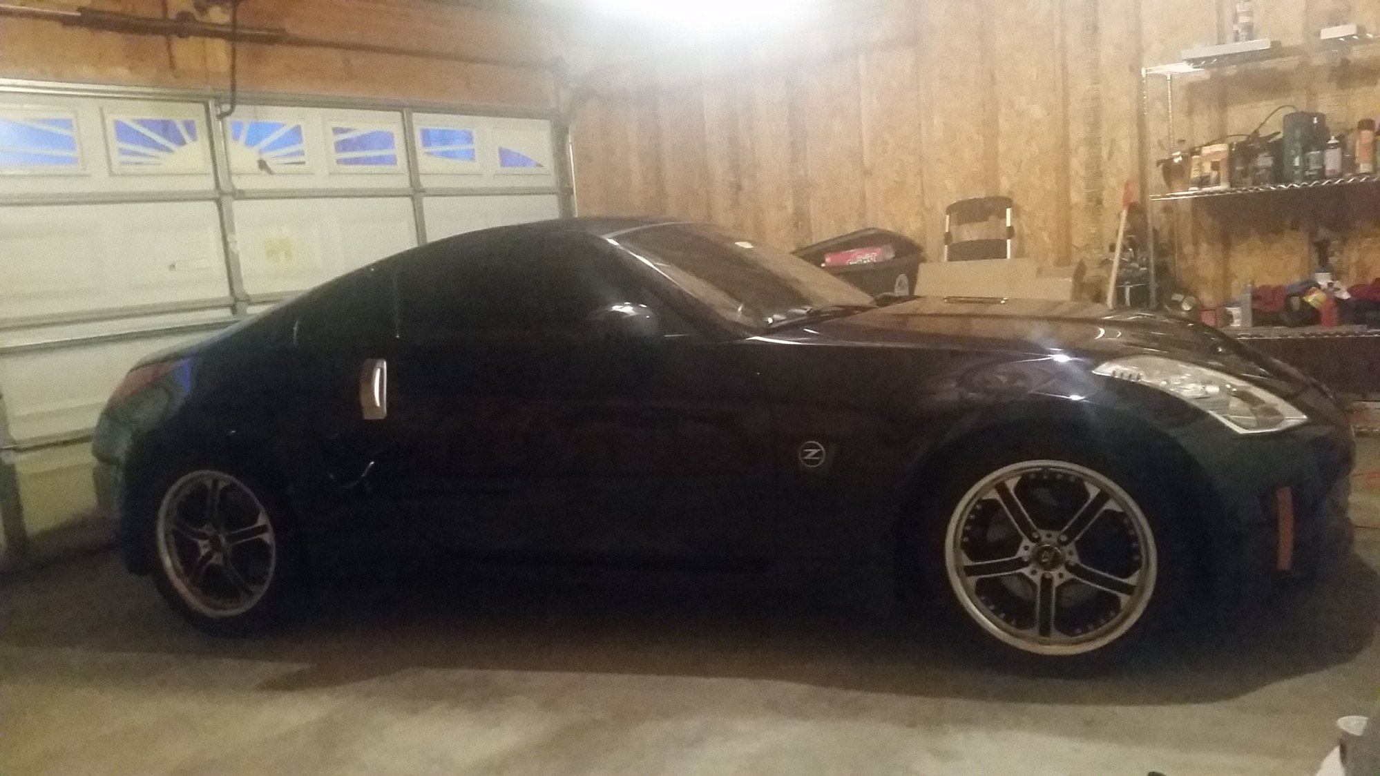

Plain Jane 2008 with ugly rims that came on it.
Hit some scrap on the highway and ended up with a V1 bumper and did white vinyl by myself.
Wrapped it up with 285/265 RS3'S on RPF1's
Diff bushings, Akebono brake kit, Hotchkis sways, and Trans-go installed over winter. I did a Stillen grounding kit as well...but that was because I missed the electronic shift connection point when I was doing the valve body and couldn't figure it out.

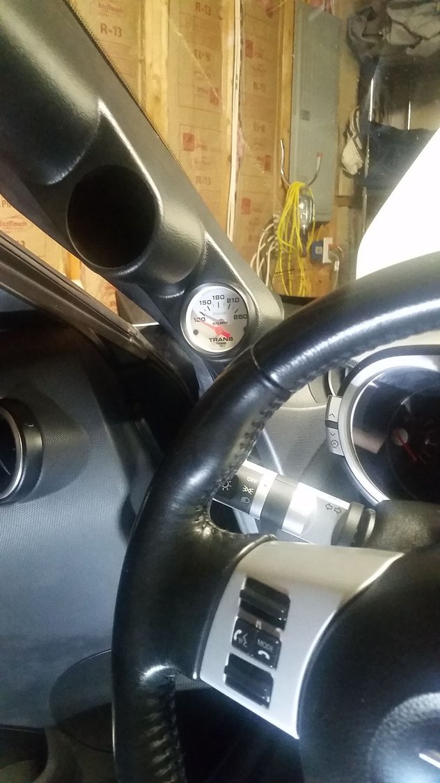

Finished up trans cooler and gauge.

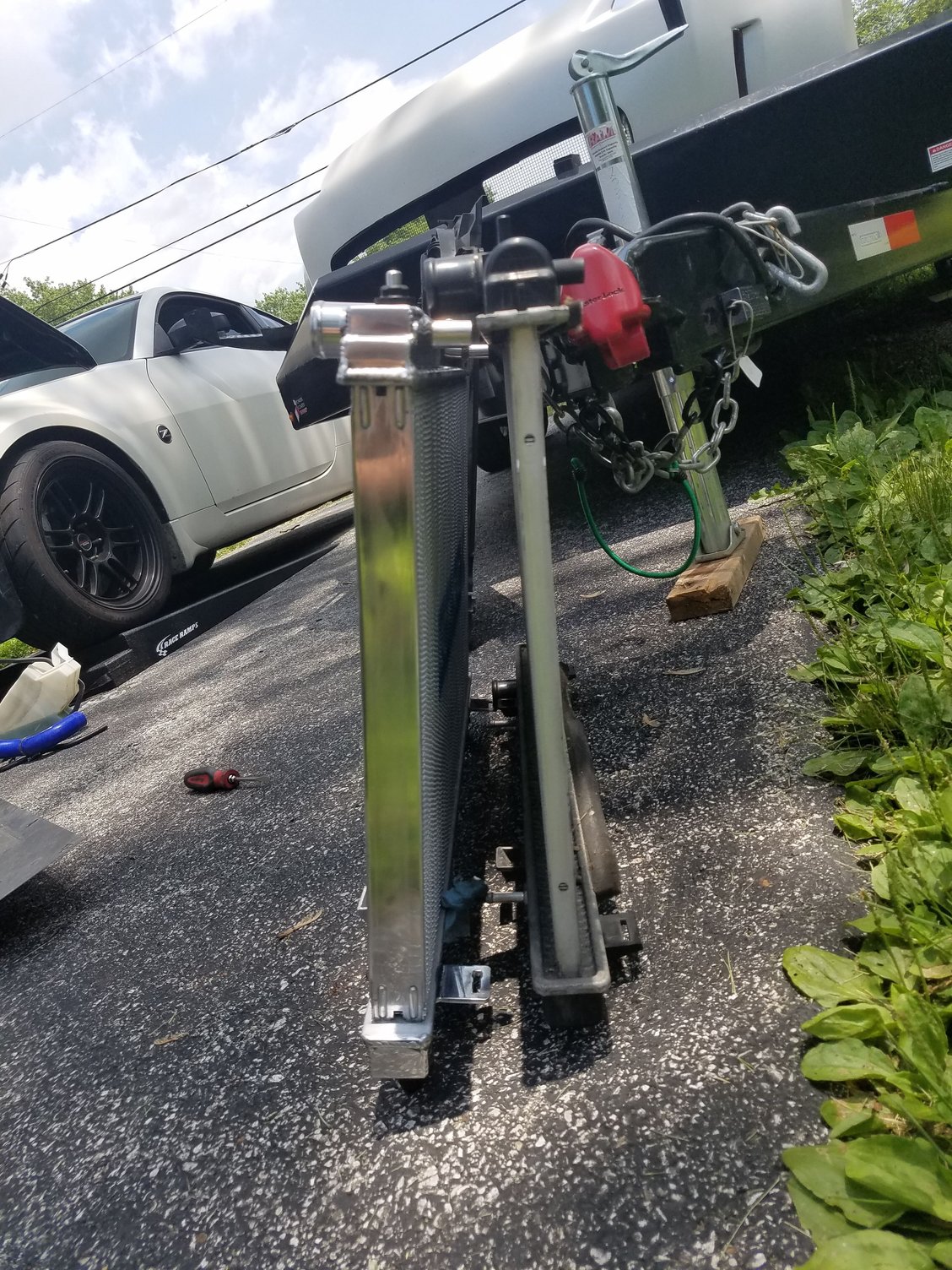

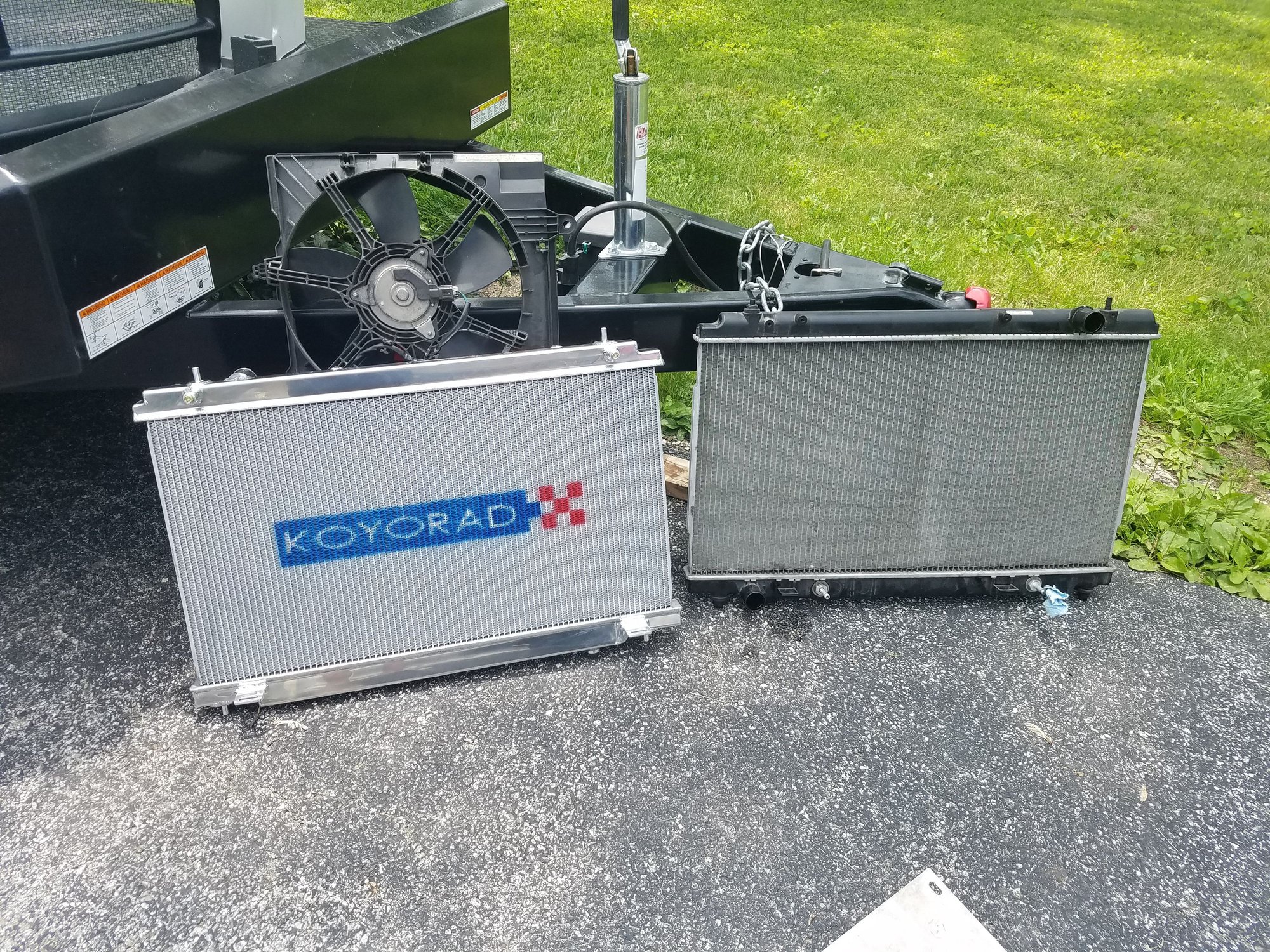

Old Jun 30, 2018 | 03:08 PM
coletrickle74's Avatar
coletrickle74
Joined: Jul 2014
Posts: 403
Likes: 86
From: Chicagoland
Well the stock trans cooler has been bypassed with the new radiator in. Its almost 100 degrees here today and the trans never went over 185. I did notice its moderately overfilled now. Maybe a half inch above the hot marking. Will drain some tomorrow and hope for the best at Road America in a couple of weeks.
