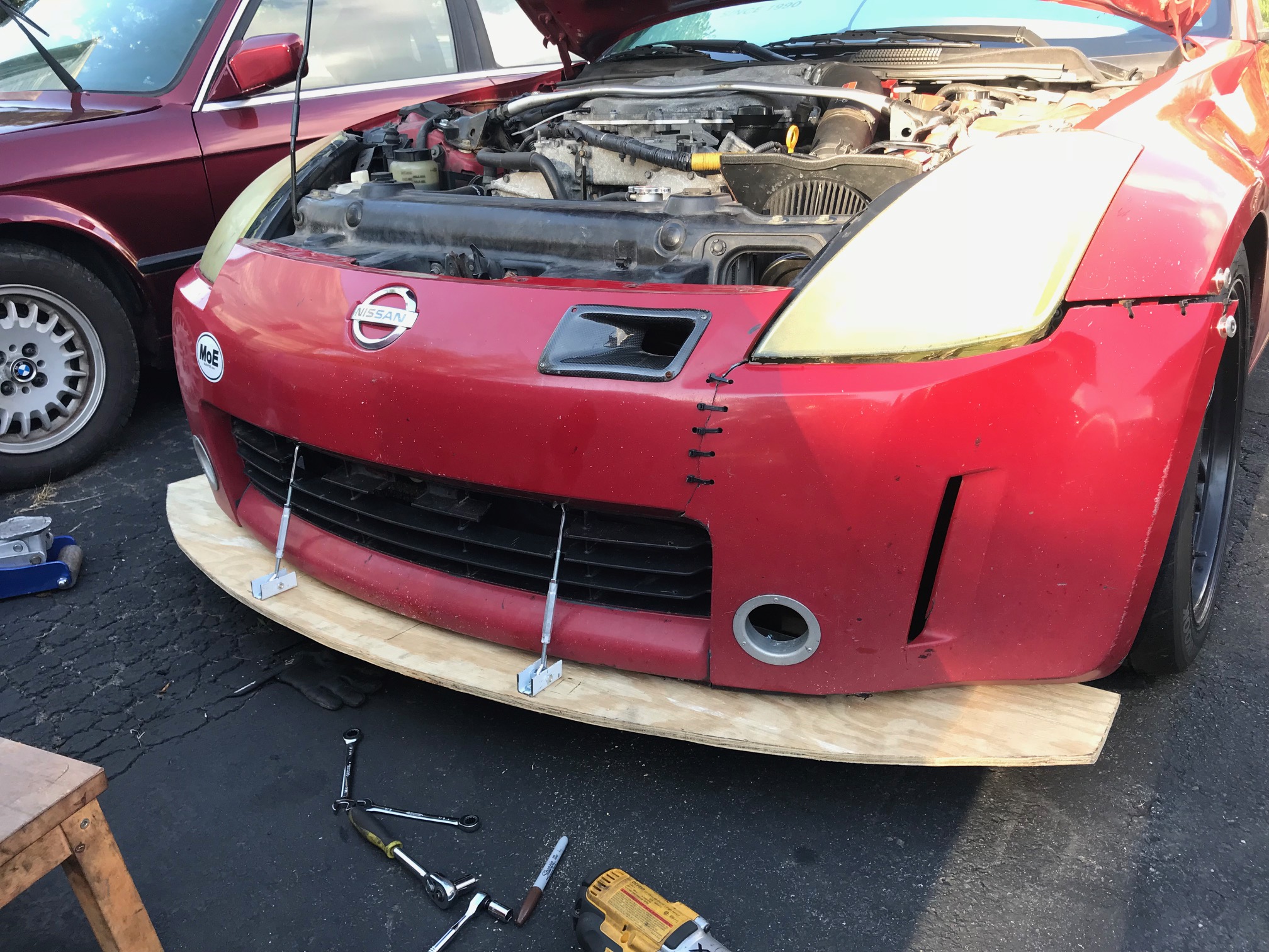

My car is overall balanced, but high speed corner entry feels understeer, so spent some time during 7/4 week to build a front splitter.
Test it last weekend at NJMP lightning course which has high speed corners and connects to long straight. With the upgraded tires, I expected at least 1.5s faster than my best record, but ended up only half sec faster. I would like to have your advice on my splitter setup, the current setup may give me negative impact.
- It is 4" extended from the edge of the bottom lip
- The ground clearance probably around 4".
- It is parallel with the group when static
- There is a ~1” gap between the splitter & bottom of the bumper to let air go through. This is my main concern, I will build something to close the gap.

You for SURE want to close that splitter to bumper gap w an air dam piece.
Just bought a bumper lip, hopefully it will fix the gap and seat right on the wood splitter.

Anything over 3 inches from the ground is pretty much considered useless

mine is 4.5" measured yesterday. Why it is useless if over 3"? any article support this assumption?

Ineffective and allows to much air under the car.
High speed corners are fun with a splitter, especially if there are bumps or waves in the pavement. As the splitter gets closer to the ground it creates more downforce, a midcorner bump can be felt. Also a slight press of the brakes on turn-in will change dynamics a bit more than before
Isn't more air flow underneath the car increase the speed of the flow and cause low pressure to increase overall downforce? or maybe adjust the splitter angel to have the front lip closer to the ground, not sure if that would help.
trail brake does help my turn in a lot, but I would assume a functional front splitter will help dramatically for a large sweeping corner like the last corner of NJMP lightning

Splitter should be kept level with the ground.
Then as as far as height and design, tons of info out there on it.

installed ebay front lip. fill the gaps and seat right on top of the plywood splitter. Since it's not perfect level, there are small gaps here and there. I will tape the brake duct & side marker next time. what do you guys think?

Nice start for sure. I think some garden edging may be a better option than that Ebay lip. It should close the gaps much better as well as leave more of the splitter surface which I believe would create more high pressure on top creating more downforce.
Battleaero just released a pretty stout looking splitter which I ordered. Once it comes in I'll modify it to suit ST4 rules as well as add a vertical dam (which I'm thinking to use garden edging for.) Heck I may just use their brackets and make a whole new splitter.

Read a lot of aero article, built a air dam for $6. Have a last event this year, will see if it works.
