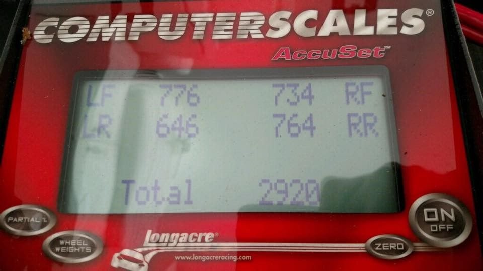

This was pre-corner weighting. I have an LS3, with T101a transmission, RHD conversion, 18x12 wheels, 350mm rotors, 12 gallon fuel cell. and me in the car

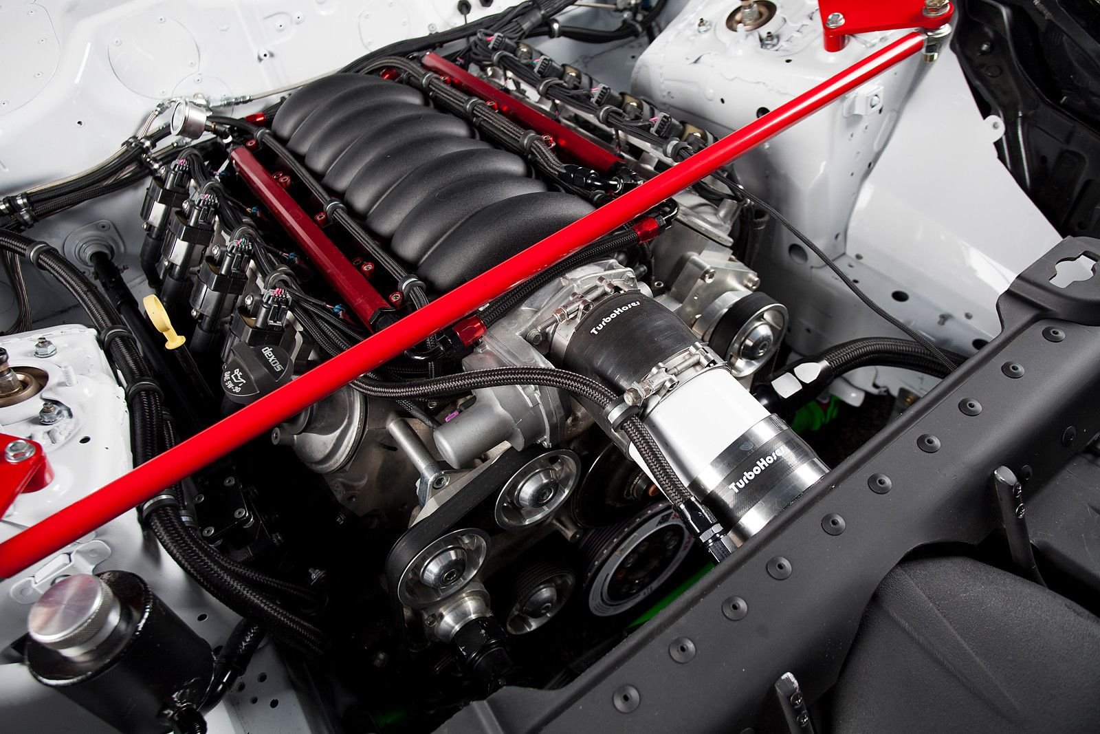

I did remove the false firewall, and i trimmed the corner off of the right head to get it this far back. I also made my own mounts

I am running the C5 Z06 batwing oil pan (another reason for the RHD conversion) and i put a 0.125" piece of stock between the oil pan and cross member to get it as low as possible.

The sway bad and OEM crash bar in stock location for position reference.

Originally Posted by Lightning Guy
hit me up if you have any more questions.
Bloody hell, that's brilliant plus the pics give a very good indication of how far back the engine is. At this stage it's just an idea for me, I do have a near new LS3 sitting around doing nothing. Have you any ides why there is so much variation with the corner weights?
well it went from LHD to RHD and i didn't re-balance it, that measurement was to get an idea for how much new springs i needed, since i am now 335 square.
