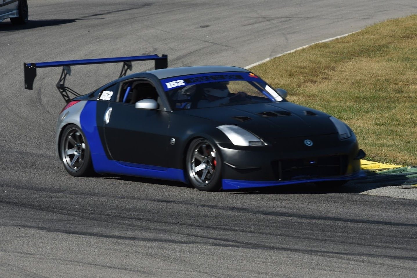

A few more pics from the event

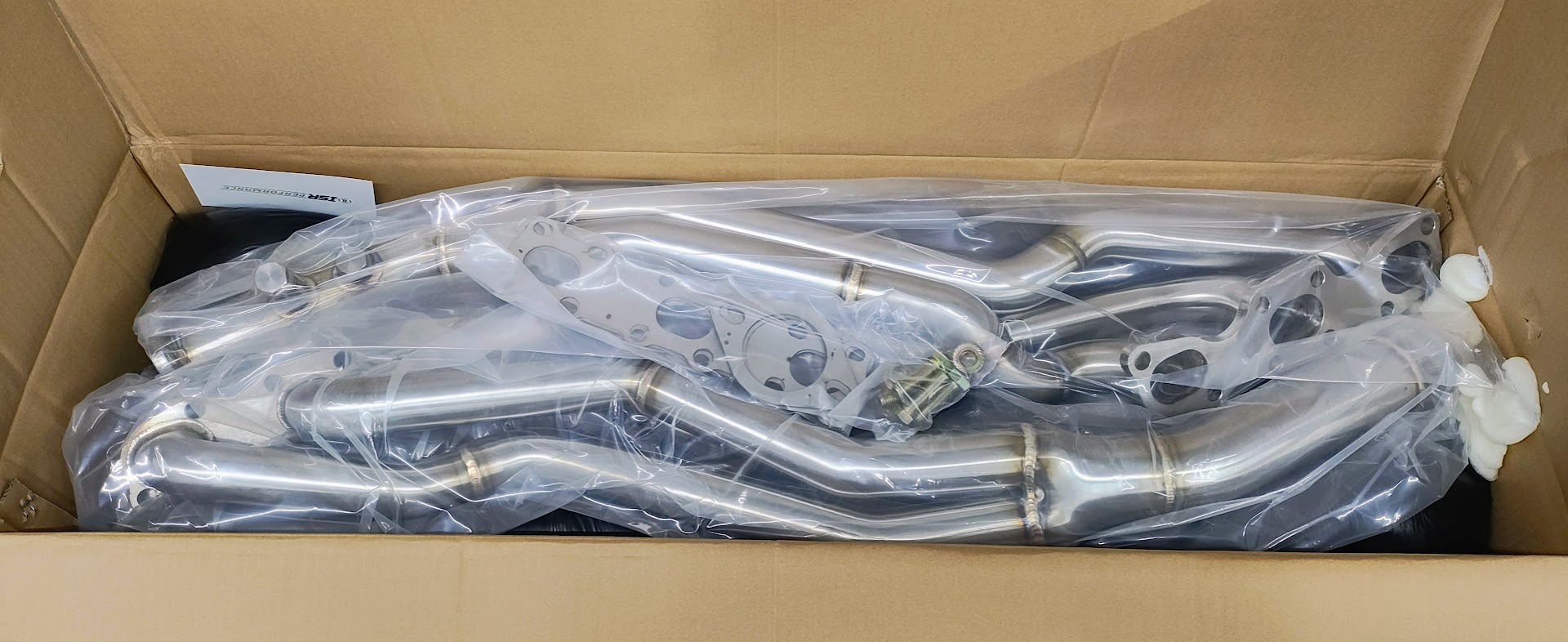

headers have arrived. Probably not gonna get to installing them until around xmas time.

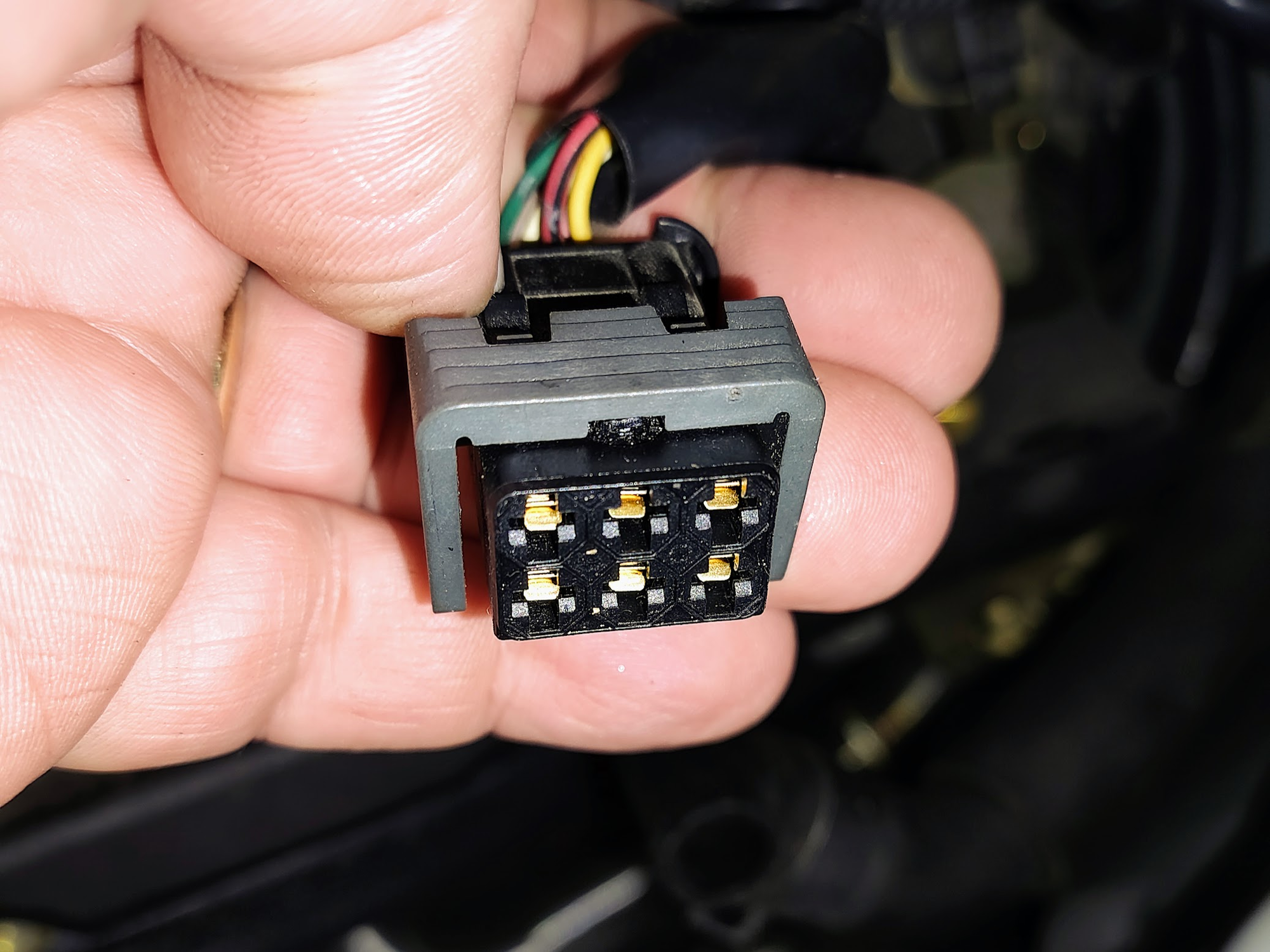

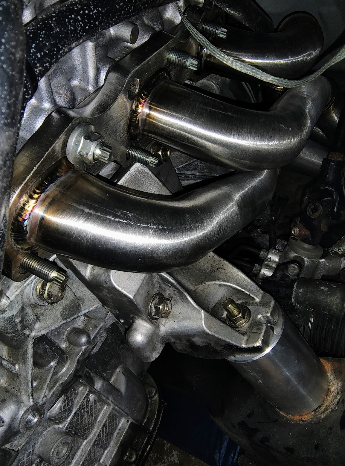

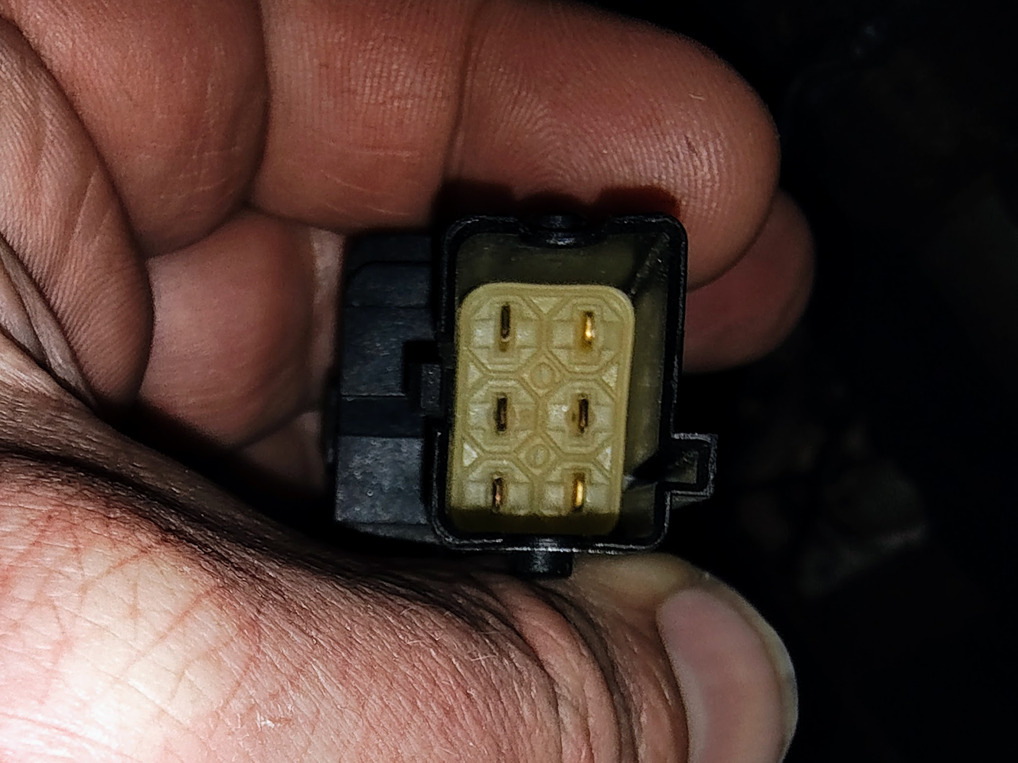

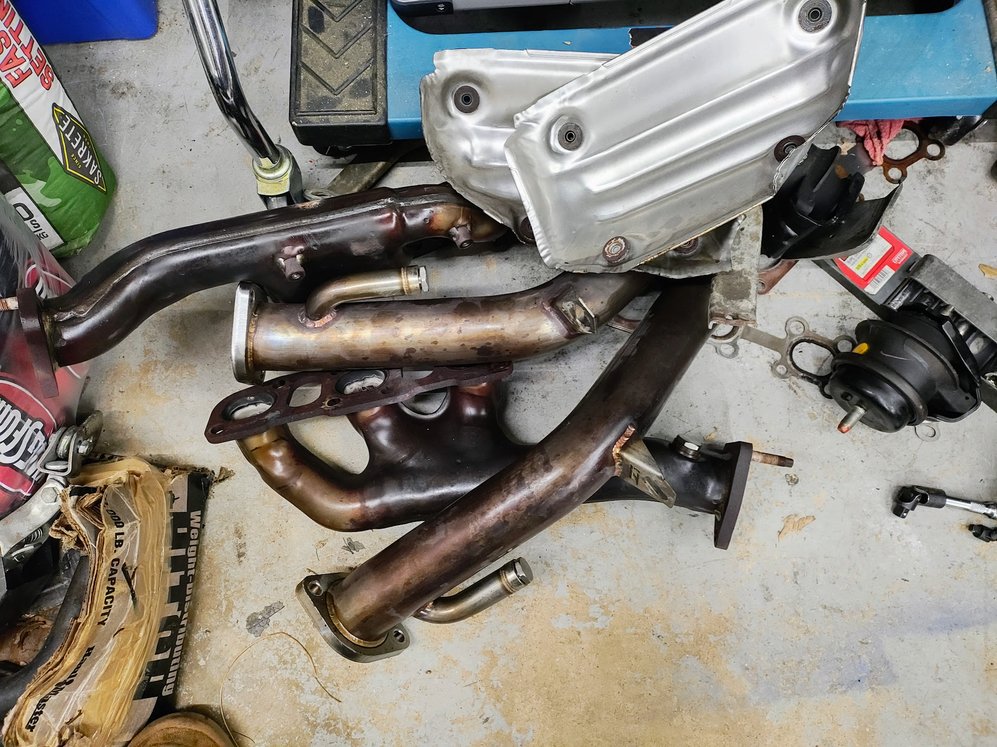

Spent some time today with a buddy installing the solid engine mounts and the long tube headers. All in all it's fairly straight forward if you're doing both. Doing the engine mounts without removing the exhaust manifolds is a nightmare at best.
The ISR LTHs move the primary O2 sensors way down the tube, so the stock o2 harness won't reach. I haven't been able to find any ready made extension harness for them. They are 6 pin connectors. I guess I'll have to extend them myself.
I stopped before putting all the header nuts back on. Not sure if I should use threadlock here, and which one? I might contact ISR Monday and see what their recommendation is.
Now I've got a bunch of parts to get rid of again. If anyone wants the Z1 test pipes or any of the oem parts lemme know.

Test fired the Z today with the new engine mounts, heades and extended O2 sensor harnesses. I can definitely tell the solid engine mounts at low RPMs the vibrations are pronounced, but mostly go away at higher revs. Not much sound change considering I had test pipes before already. Happy to see no codes from the extended O2 sensors, seem to work fine as before.
