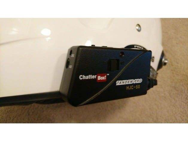

I managed to break off the helmet mount for my chatterbox, so I created and 3D printed new one. If anyone is still using the older chatterbox design, you can download the mount from thingiverse here
https://www.thingiverse.com/thing:4228395

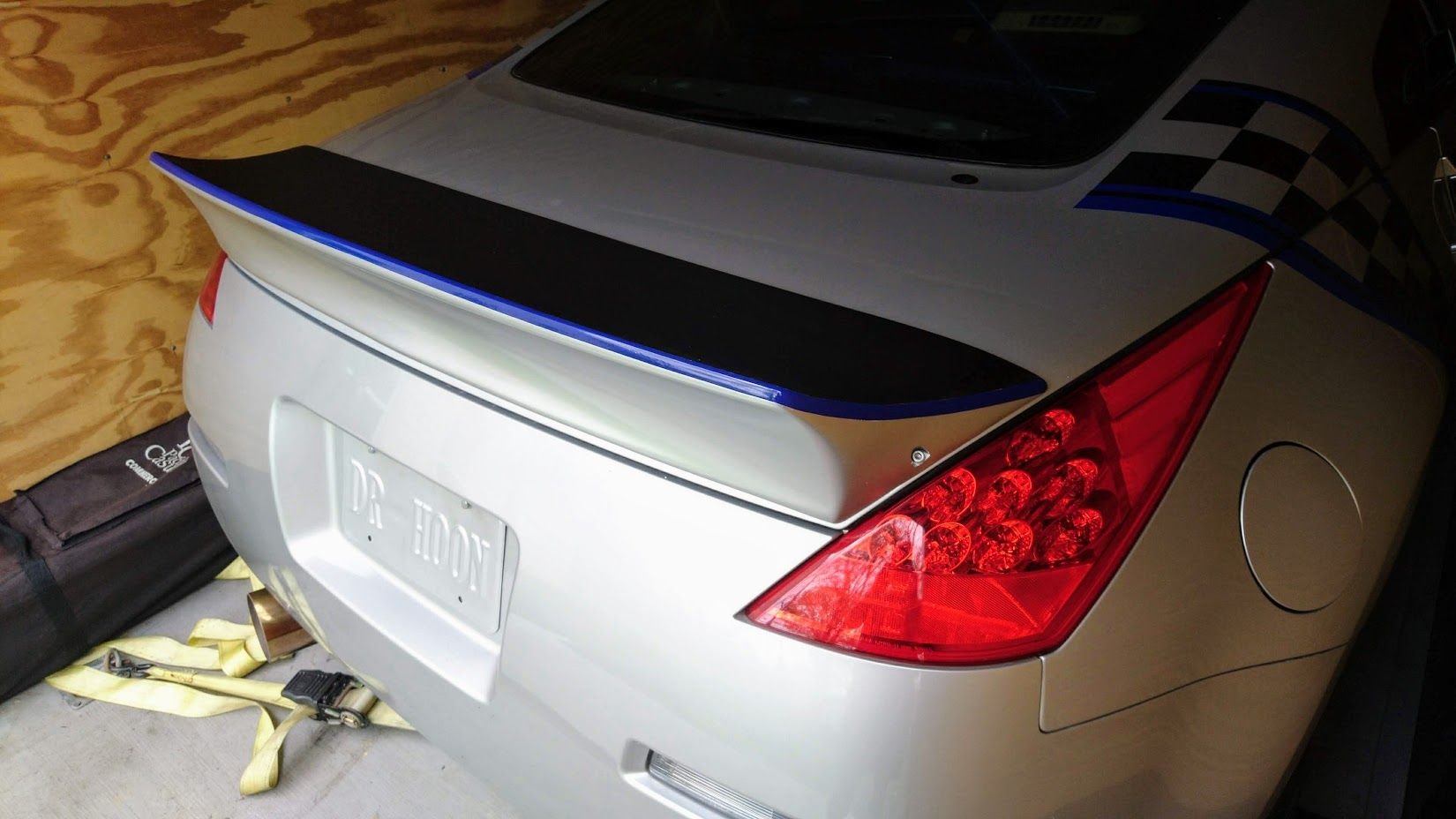

It's weird having all this downtime in the middle of spring. I've been accumulating parts, about ready to start slapping them on the car. First, a duckbill spoiler. I was planning to leave it urethane black, but the finish on it is not the greatest, so now it'll get painted matching silver being going on the car.

A bit of work on the spoiler this weekend. Test fit and drilling mounting holes
Base silver
Clear on the sides then flat black on top
and blue stripe down the middle
Mounted
