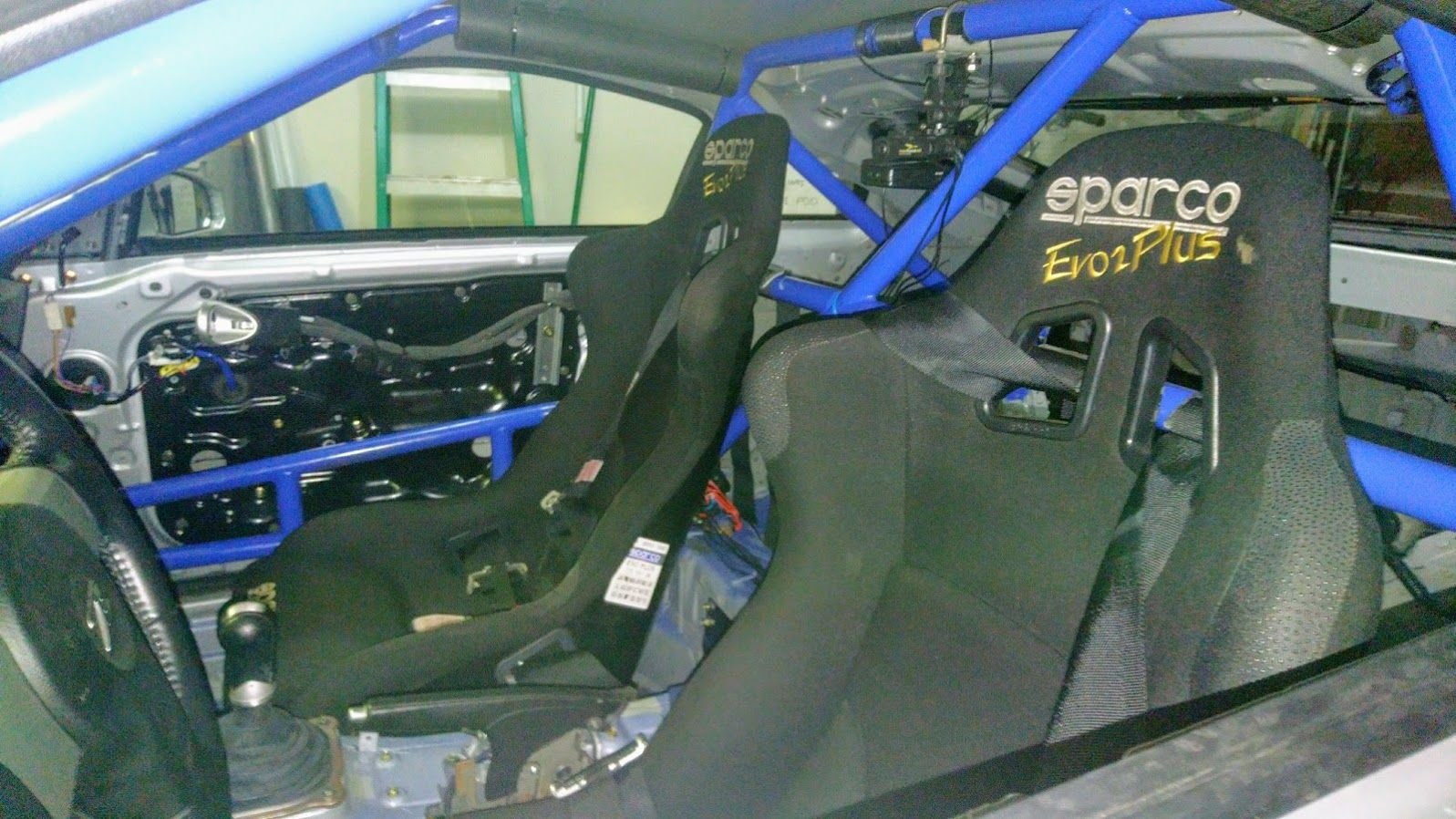

Spent a day in the garage to swap the brakes and install lower pass seat mount.

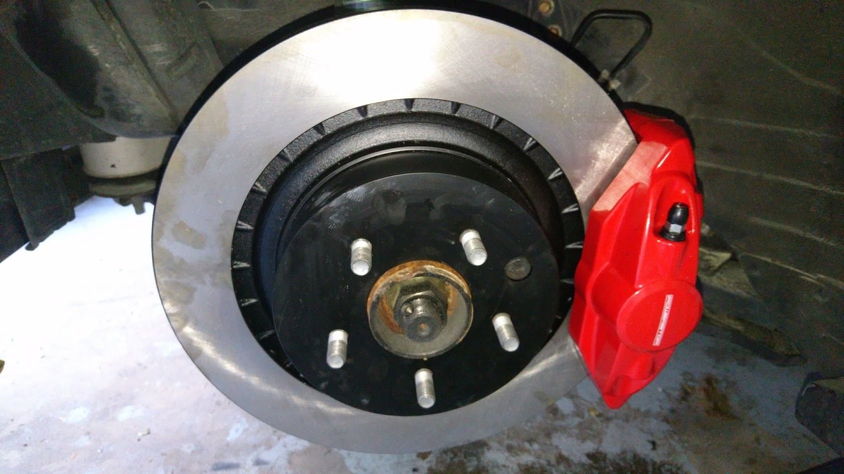

It took my expert eye, but I think I found the issue with the rear caliper
That was the pass side that caught on fire, the driver's side wasn't much better. Good news is that there didn't seem to be any other damage from the fire, the axle boot, the ebrake cable, all the plastic bits are ok. So I was able to go ahead and install the new setup.

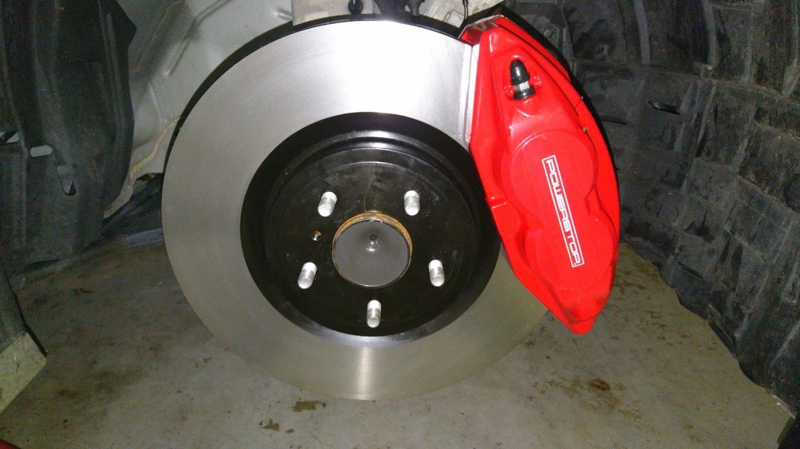

And front
I ended up with PFC 01 pads on the front, which is always my preferred choice, but had to go with gloc R10s in the rear, wasn't able to find PFC fitment for it. Apparently they did have it once, but no longer produced and pretty much unobtanium.
Good wheel clearance with my 18s too
Remounted pass seat. Still a bit higher than the driver's side, but now about 1-2" lower than before. Way more headroom.
Still got all the rear control arms to replace. That'll have to wait for another weekend.

Here a pic with the old seat mount to illustrate how much passenger headroom was gained

Had to take the front brakes back apart cause something was binding. At first I thought maybe the rotor thickness was different and the tire was hitting the upright but that wasn't it. It looked like maybe the dust shield on the back was rubbing but once I took the rotor off I realized the adapter bracket mount screw was rubbing on the back of the rotor. The kit includes both flat and locking washers for all 4 bolts that hold the plate and the caliper, but if you install both washers on that bolt it sticks out too far and rubs. I removed the flat washer and now the rotor spins freely. Would've been nice to know so I didn't have to waste a couple hours troubleshooting this.

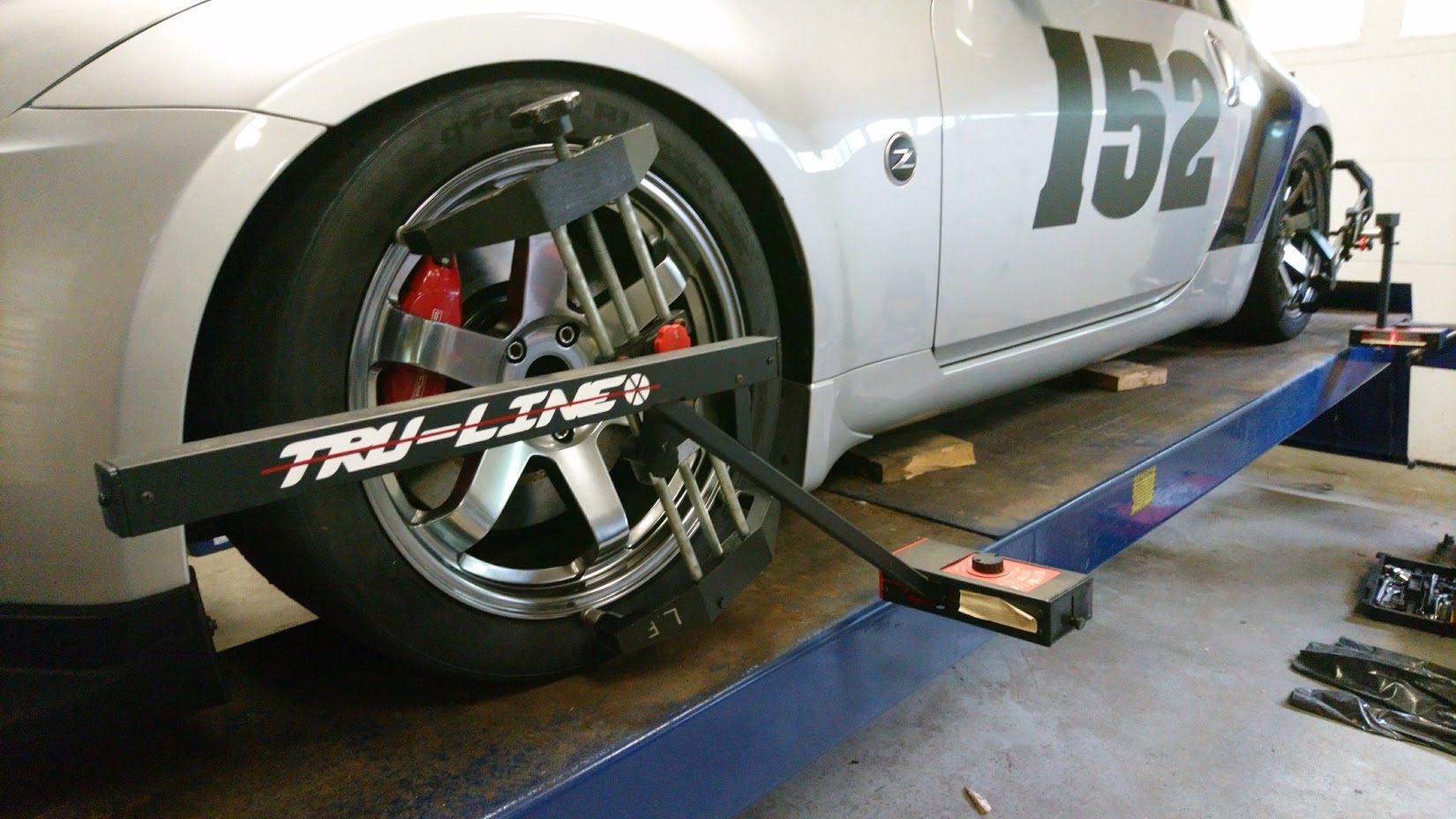

Once this was sorted I swapped all the rear suspension links and did an alignment. Since I was running short on time I didn't change the front specs, 1/8" total toe in and 3.5-4 degrees of camber, but I did adjust the rear to 2.5 degrees of camber and 0 toe. These measurement are using a lot more exact tools, so yes, apparently my cheap *** camber gauge was lying to me showing >5 degrees of camber. I'll watch the tire wear and I might reduce the camber a bit more if necessary, but it's good enough now.

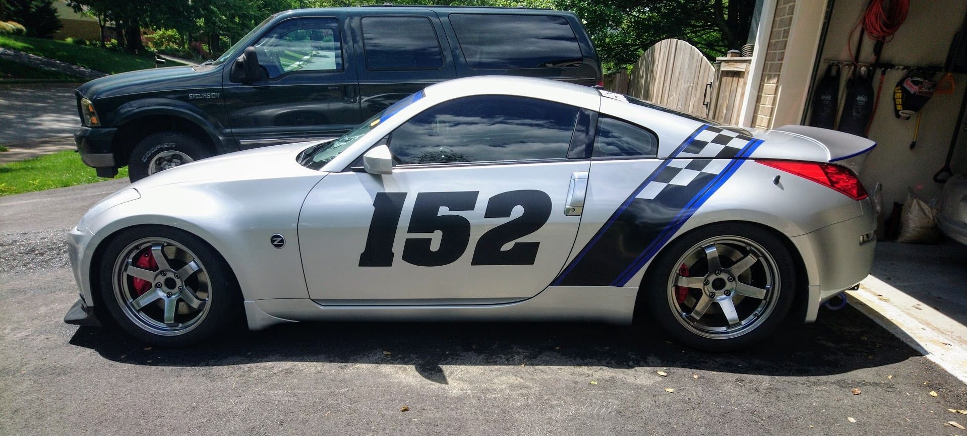

The big race numbers look great, for anyone else who is looking to make a similar impact I saw a pic of a bare white S30 which had big red numbers Made a hellava difference.

Thanks. It's just a bit of cheap vinyl. I might keep it or I might decide to go with something different later. It works for now.
