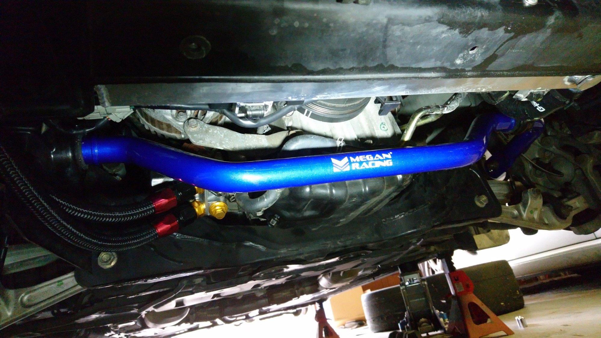

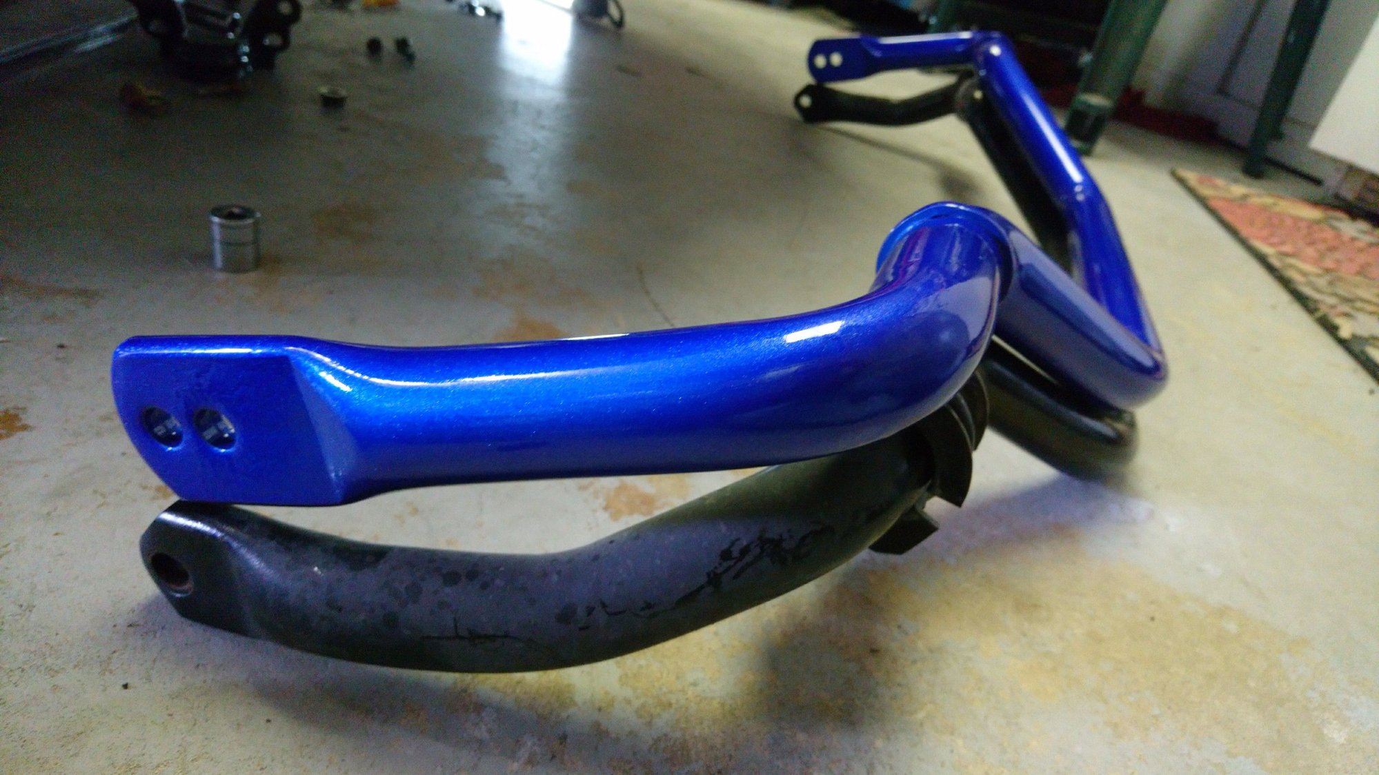

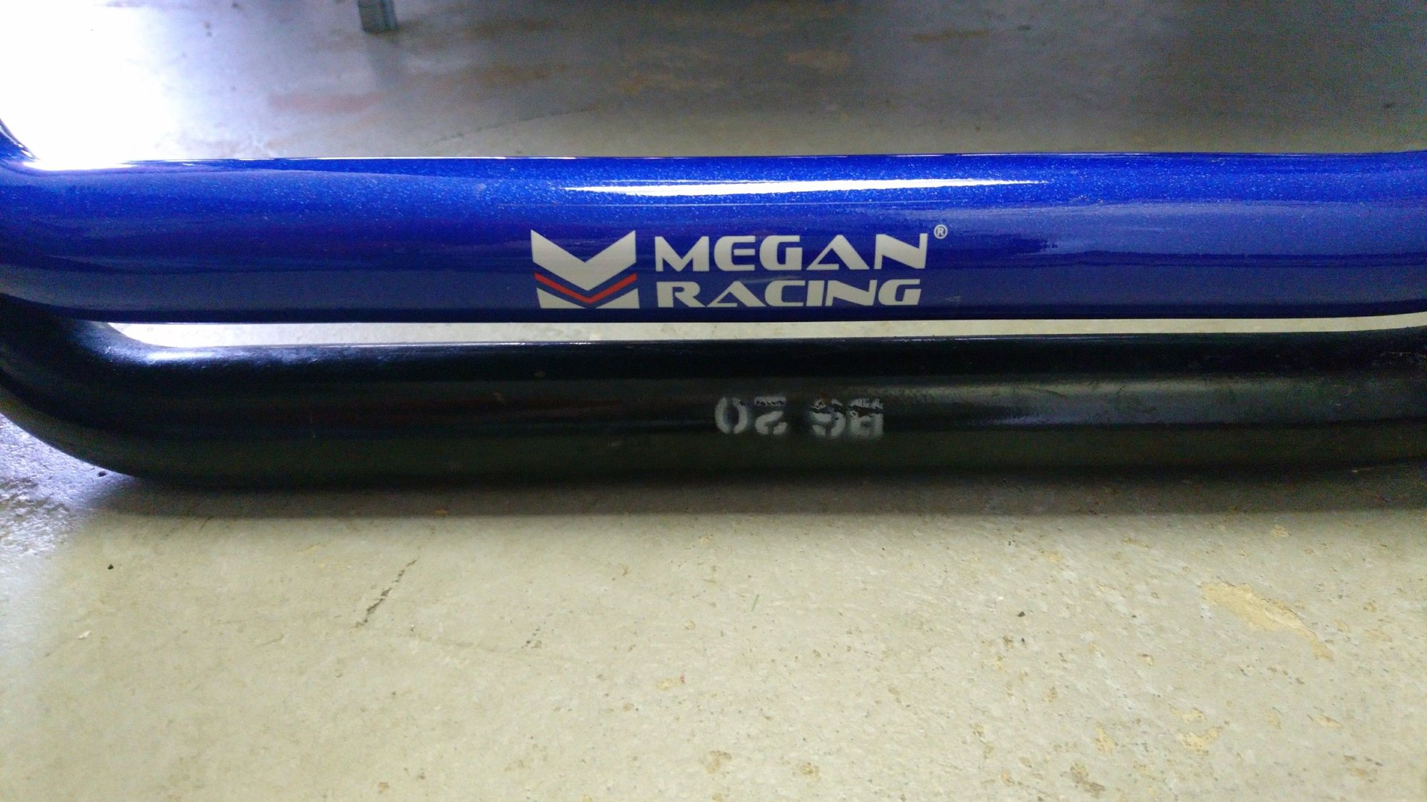

I got the Megan Racing front bar installed. It's only maybe 1mm thicker than stock, but it's 3 lbs lighter and it has addition stiffer mounting holes. I went ahead and set it to stiff and reinstalled the stock rear sway bar. If I get too much push I can change the front setup to medium at the track pretty easily.
Yeah, the stiffer the suspension the less need for sway bars. Some race cars with stiff coilovers can run without sway bars altogether. But for a stock soft suspension this is at least a bandaid.

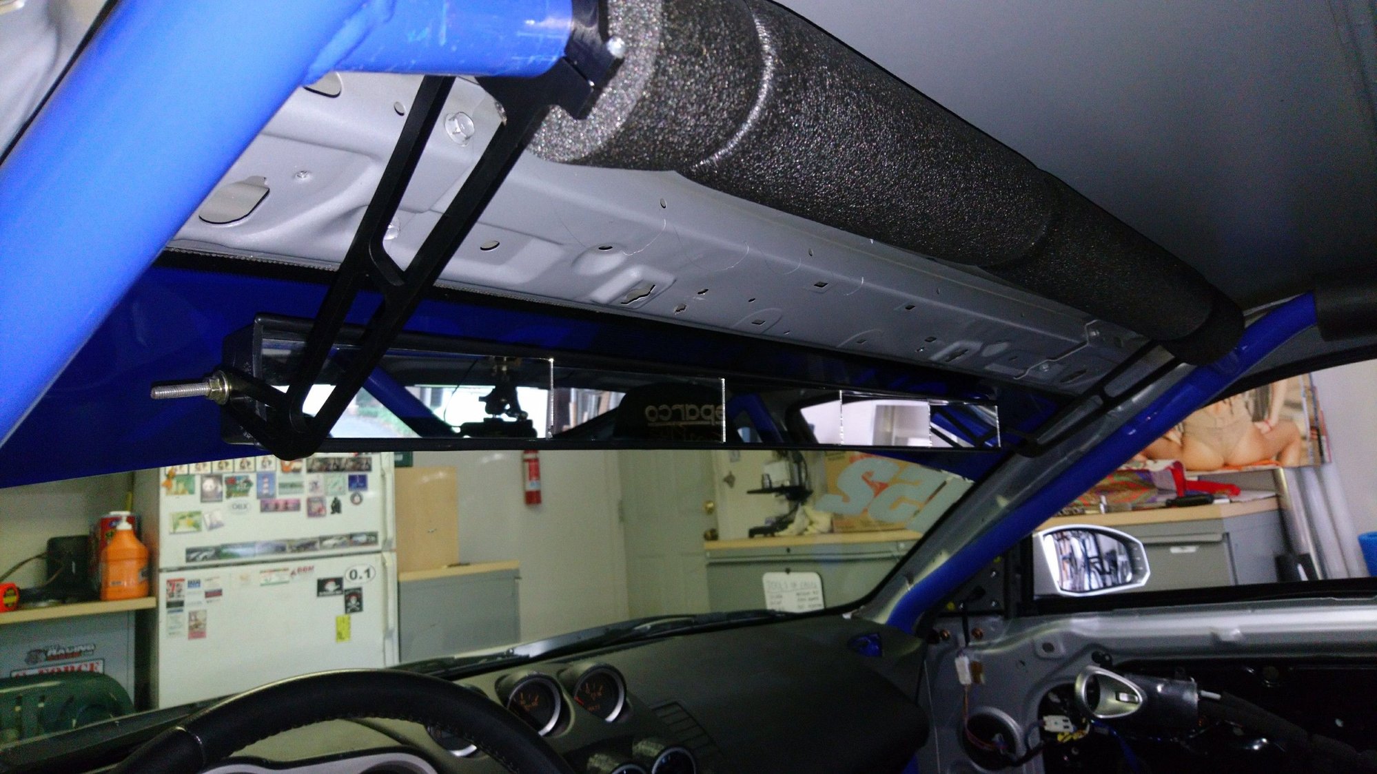

I also reinstalled the race mirror using some better brackets. These weren't cheap, but they allow the mirror to sit higher, closer to the windshield and further away from my head.

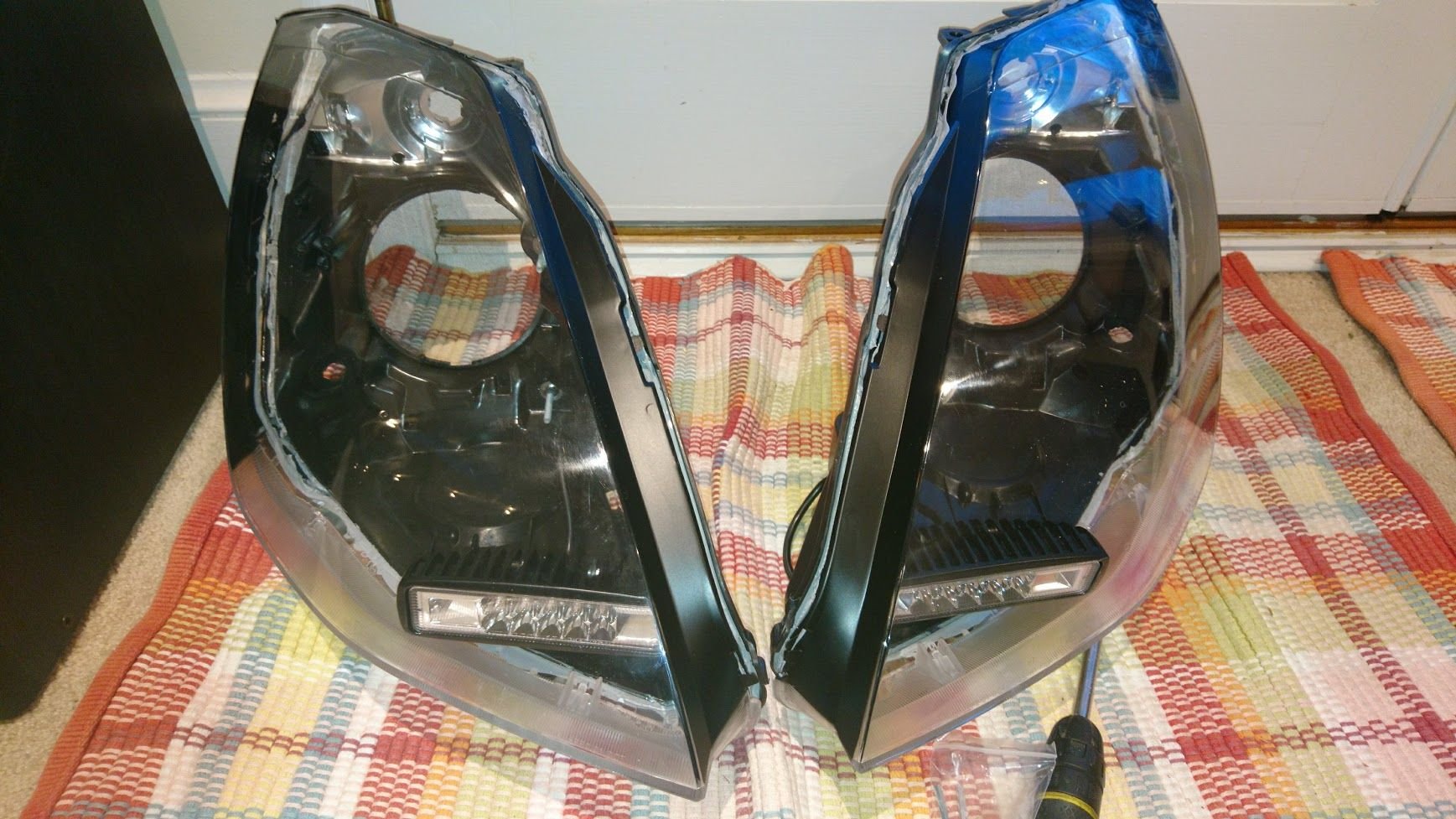

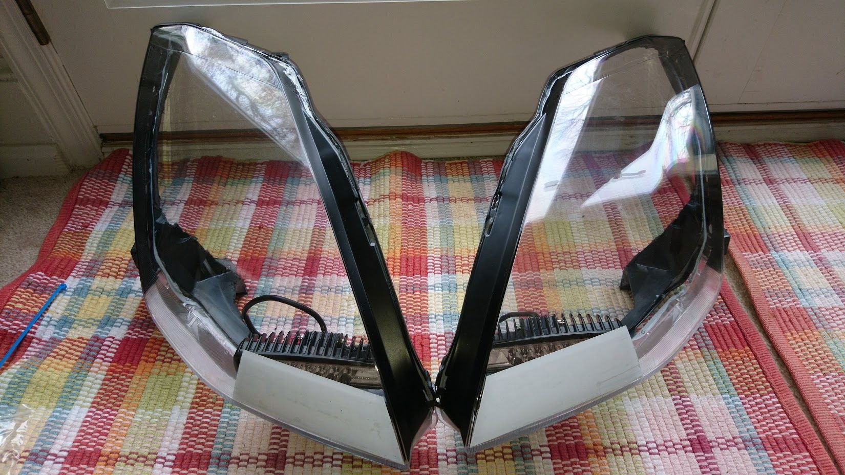

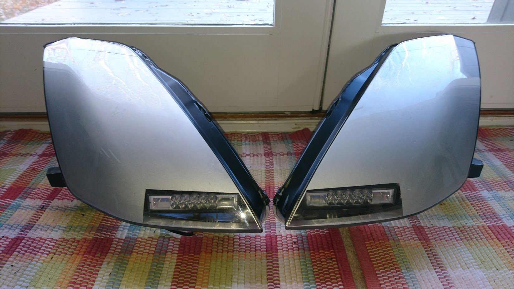

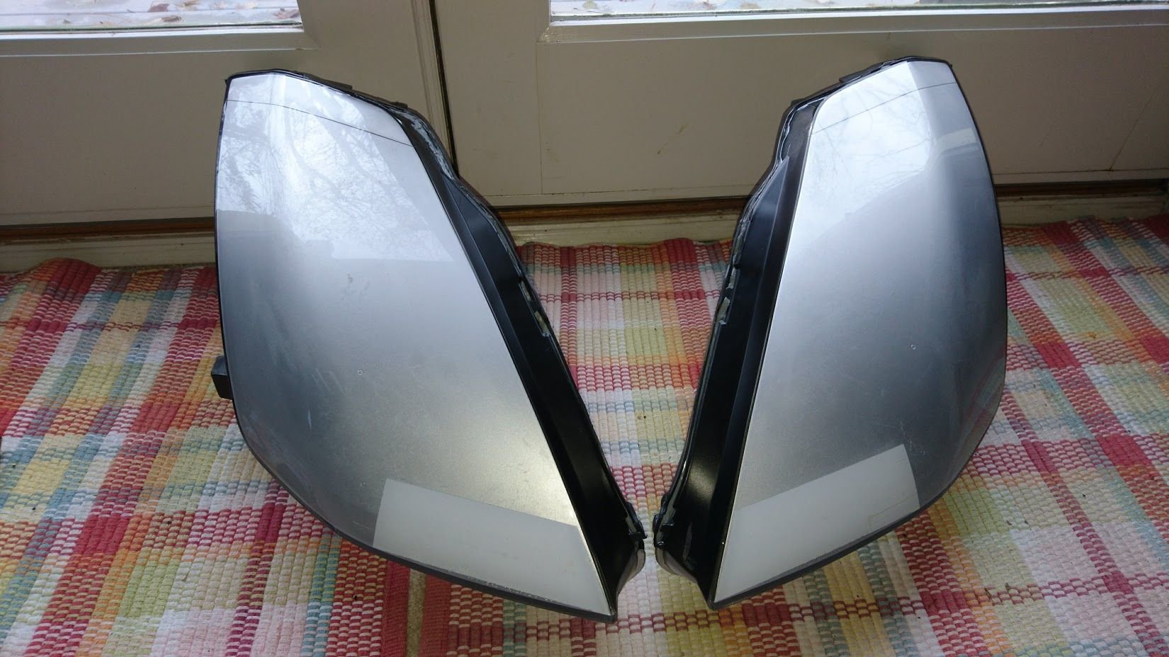

Made some headlight covers from cheapo ebay headlights. Decided to include some lighting, so built in a small LED units. Significant weight reduction vs. stock HID units.
gutted
cut out everything except for mount points
painted to match the car
with LEDs in place
LED test

Headlights $138 from fleebay https://www.ebay.com/itm/For-2003-20...t/273588061997
I wouldn't recommend these for anything else than covers lol
LEDs $16 on Amazon each
Amazon Amazon
Paint $13 on Amazon
Amazon Amazon
Total $305 and I can sell the stock hid units for more than that, plus save some weight in the process.
For off-road use only since no turn signals and no real headlights (unless I connect the blue strobes to the turn signals lol)
