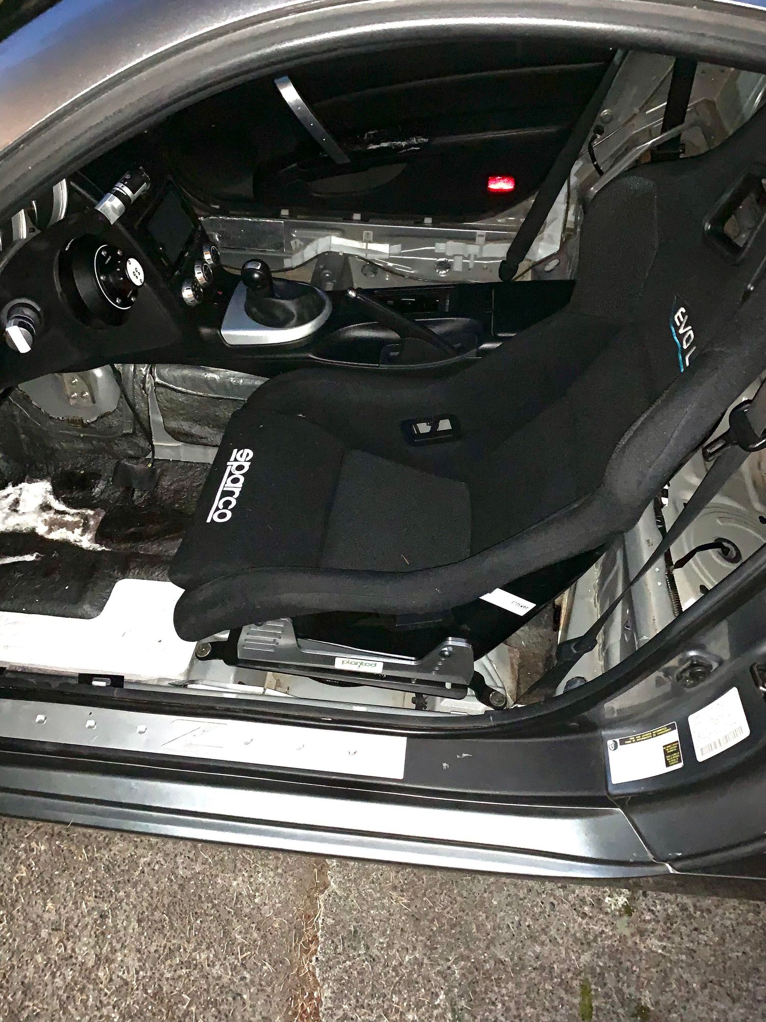

Getting the seat just right and installing it took much longer than expected. I had to go buy 2 kinds of drill bits because the first wasn't the right kind, as well as go buy different hardware to make my 3pt seat bet work. Needless to say, I was finally finished at 9:30p and exhausted.
Mounted on the bracket
Installed in the car

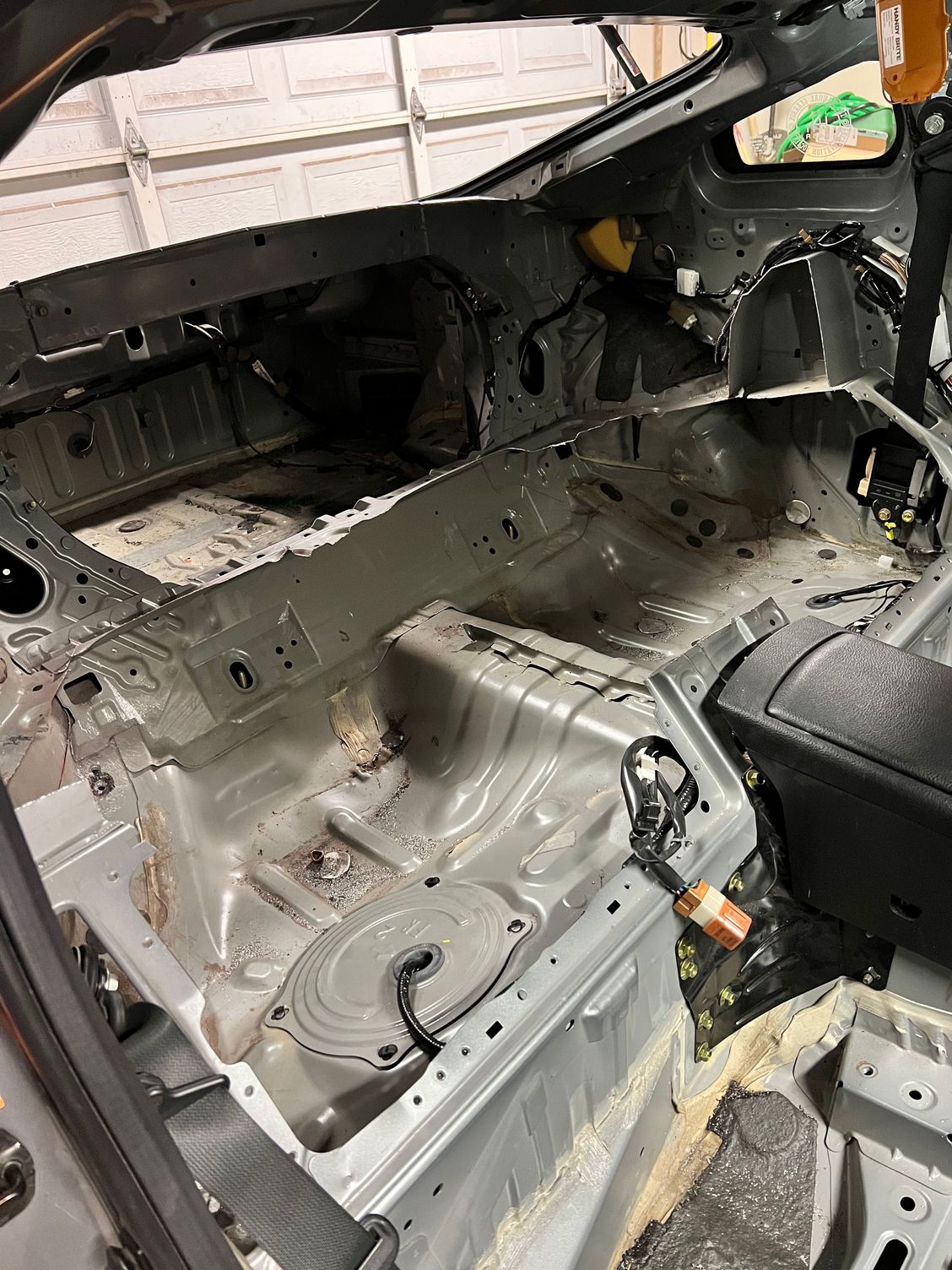

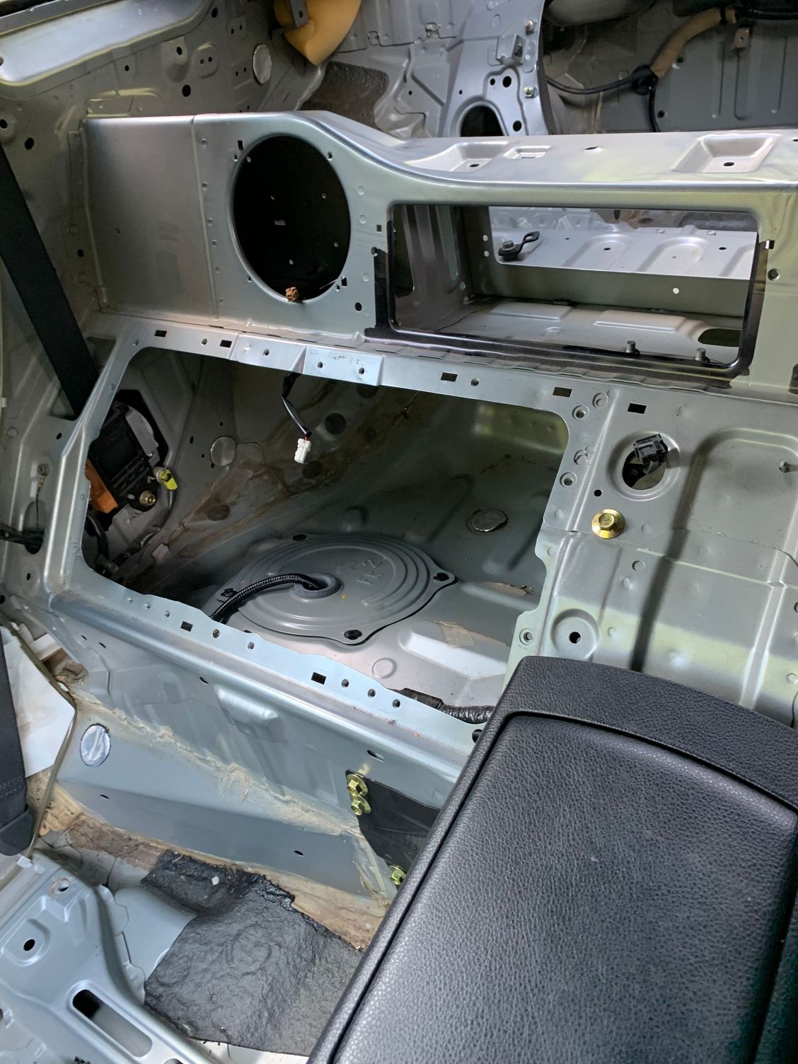

The biggest thing I needed to get done was remove the sheetmetal of the speakers/cubby space behind the seats. I took a sawzall and spot-weld drill bit to the car and pulled out a whole bunch of crap.
Still had some stuff to remove but the bulk was gone.
Some of the sheet metal taken out.

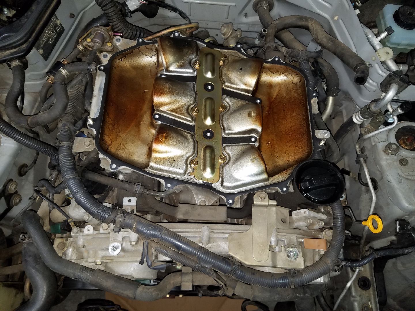

As I got home from Quattrofest, I waited until 425 Motorsports was ready to install the cage. Since I had about 6 weeks until they needed the car, I figured I'd do some deferred maintenance. I ordered a valve cover kit from Z1, new AC condenser and high pressure line from CZP, and picked up a new clutch line from the dealer. I was hoping to do all this work during thanksgiving break with my Father-in-law, who has built many cars in his time. I figured he would be a good set of eyes to watch me in case I screwed up. With best of intentions, we only got the valve covers done, but that was what I was most worried about doing myself. It was fun working with and learning from him. It'll be super helpful when he moves onto our property later next year when his tiny house is built.
Nasty oil in the plenum.
Look, I did a thing!

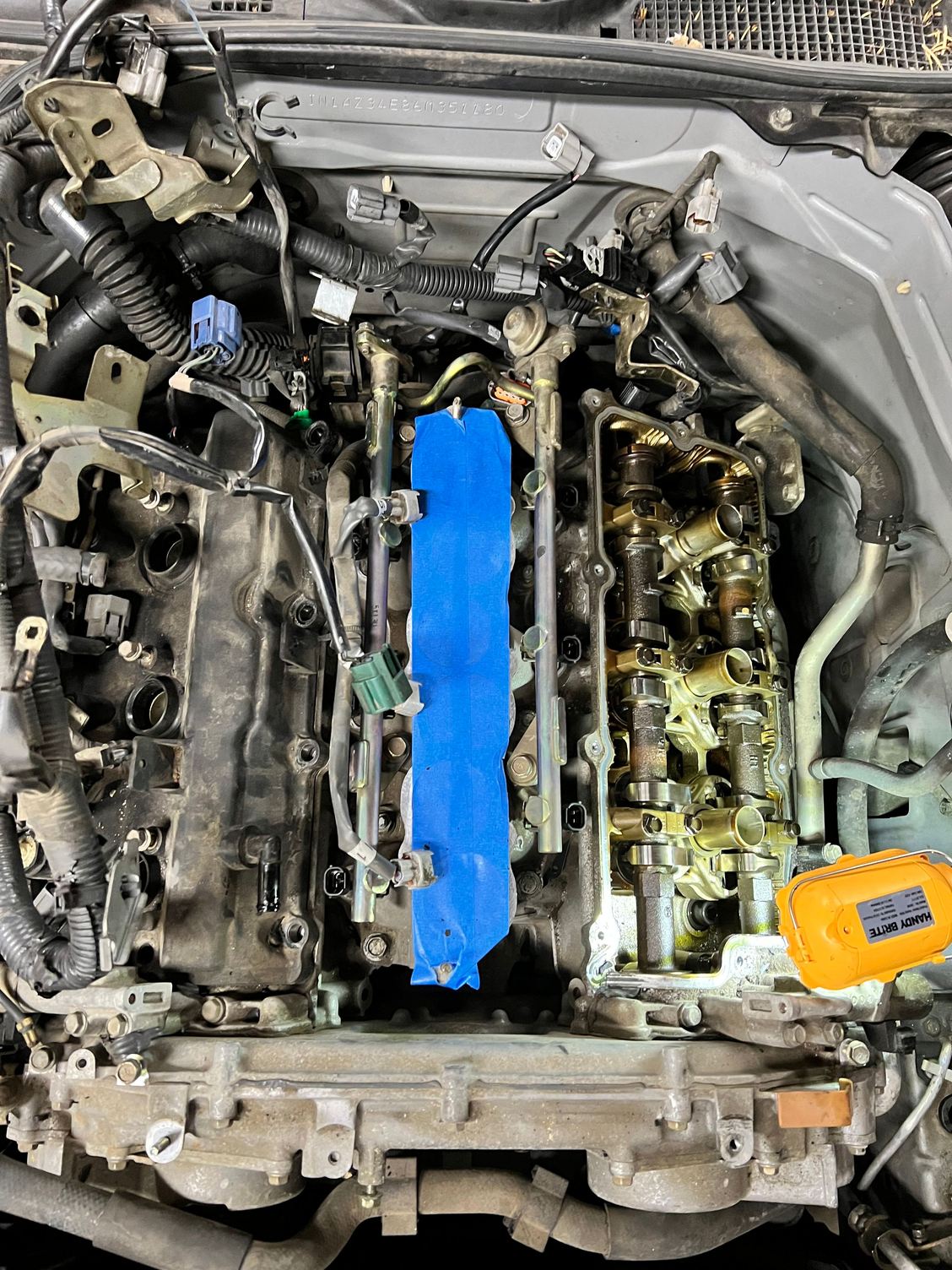

Replacing all the gaskets because we can.
Valve cover off about to be reinstalled.
While we were reassembling, I installed new sparkplugs as well. It couldn't hurt!

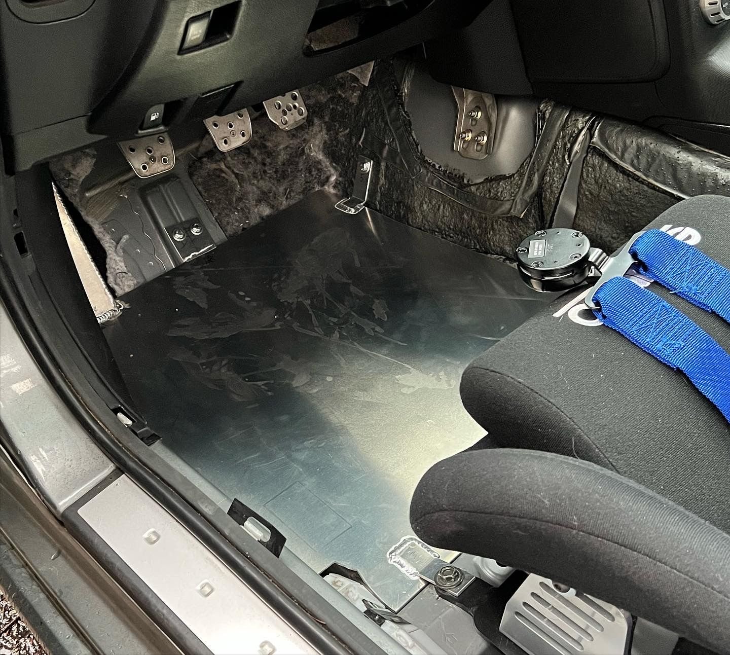

It was finally time to drop my car off to 425 Motorsports for the roll bar. After 2.5 weeks at the shop, I picked up the car a few days ago. It's amazing! They built a false floor for the driver's side foot well, custom roll bar, and rear strut brace.
Custom "false floor".
Rollbar and strut brace installed.

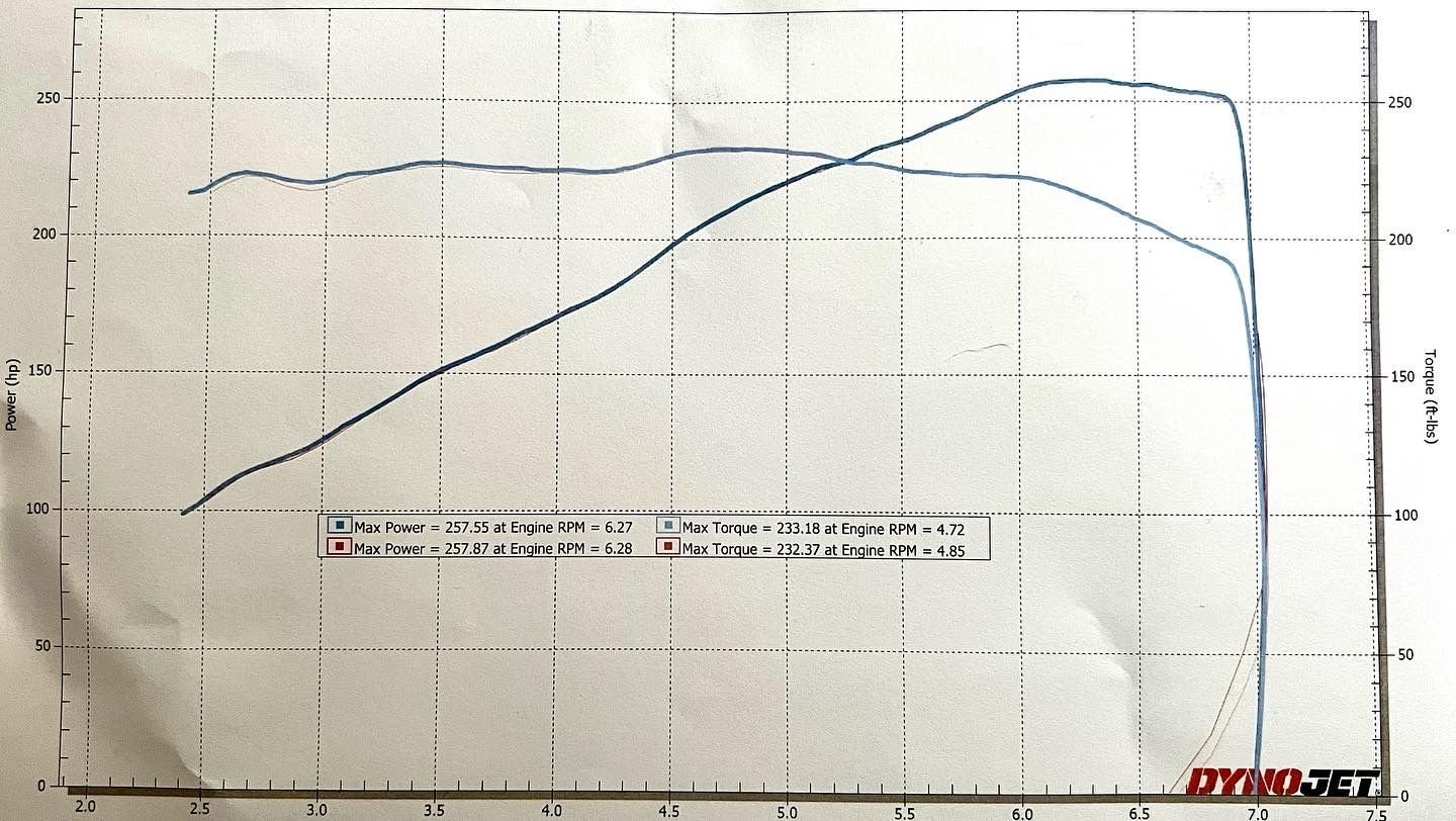

Dyno day was a lot of fun. Was run by the Avants car club here in Seattle and was held at CarbConn in Kirkland. Cool dudes running the shop and lots of sweet cars. Everything from an 04 Ford Lightning to multiple Porsches, 911TurboS, GT3, GT4, etc.
Getting the Z on the dyno was exciting no doubt. Since it had 300hp and 285lbft from the factory when new, I was expecting around 200hp and 190tq to the wheels. The car has 160k mi on the clock & was run without oil for a while (unbeknown to me). I have done a lot of "catchup" maintenance but I still didn't have high hopes. My hope and dreams were shattered because the car put out 257hp and 233lbft to the wheels. Almost exactly a 15% drivetrain loss from the crank when new. I was super surprised and extremely happy.
Dyno Results

damn those are solid numbers! what suspension parts did you go with?

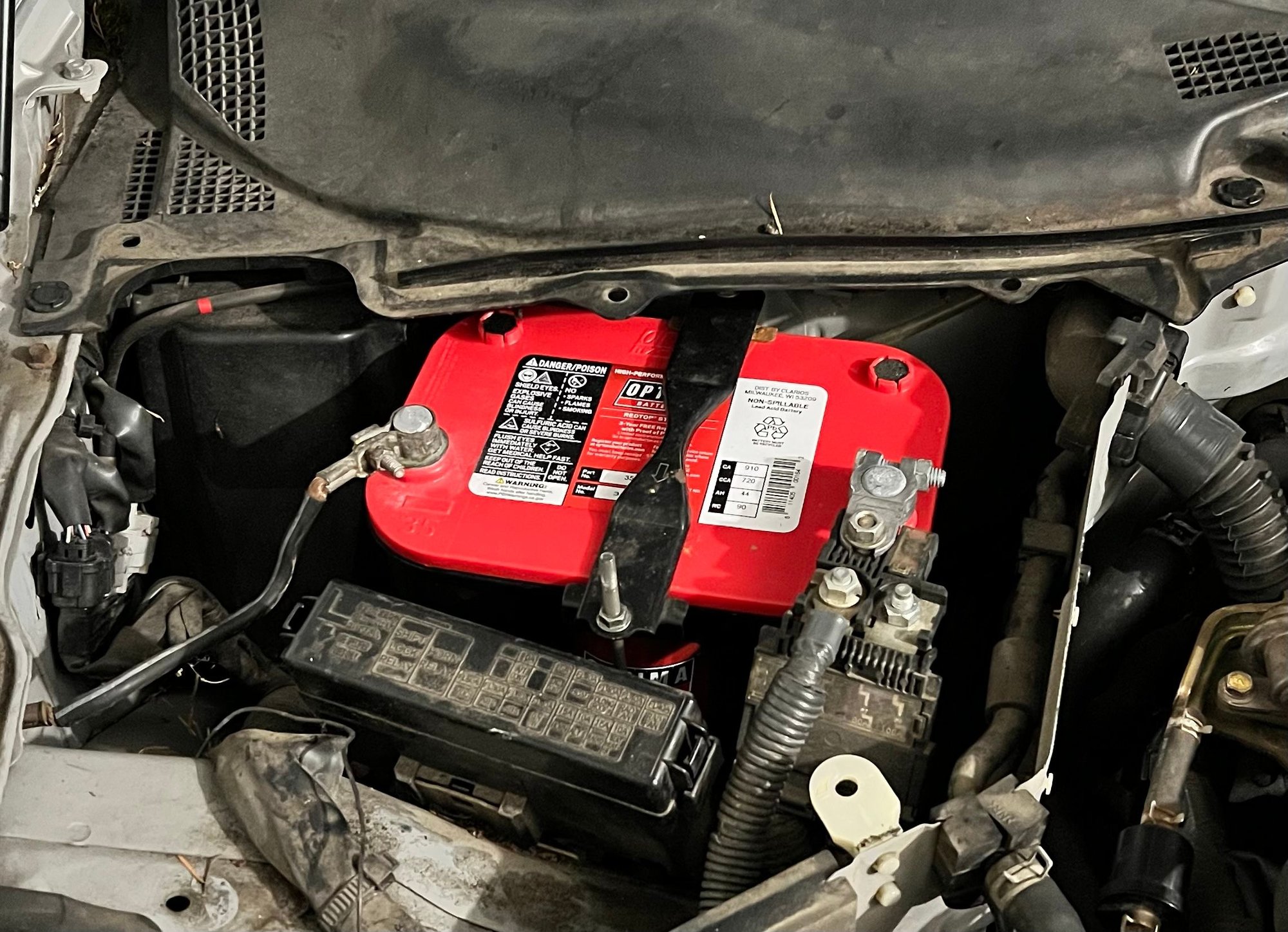

To add additional excitement to Dyno Day, my batter was completely dead and needed to be jumped to get home. Luckily I was able to find a Optima Red Top at an Advanced Auto Parts and get that installed before moving the car from the garage to the shop last night.

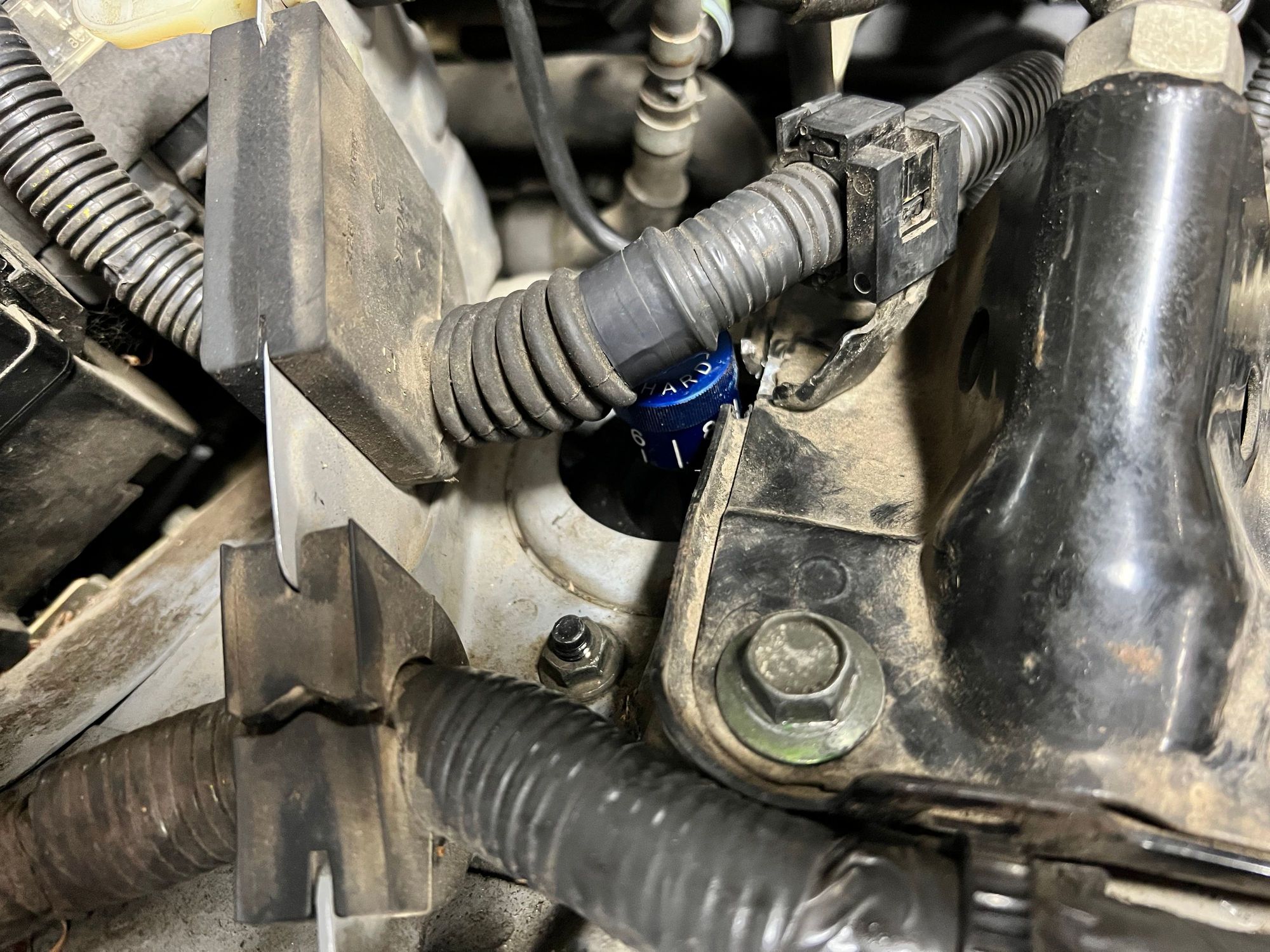

I had to do some fab work on the strut tower brace to get the adjustment **** to clear on the passenger side. It ain't pretty but it works!
I was going to install my new front sway bar, but one of the bolts has decided it doesn't want to come out. So after 30min of trying to get it out, I decided to call it and just sprayed in WD40. I'll try again today before I drill it out.
