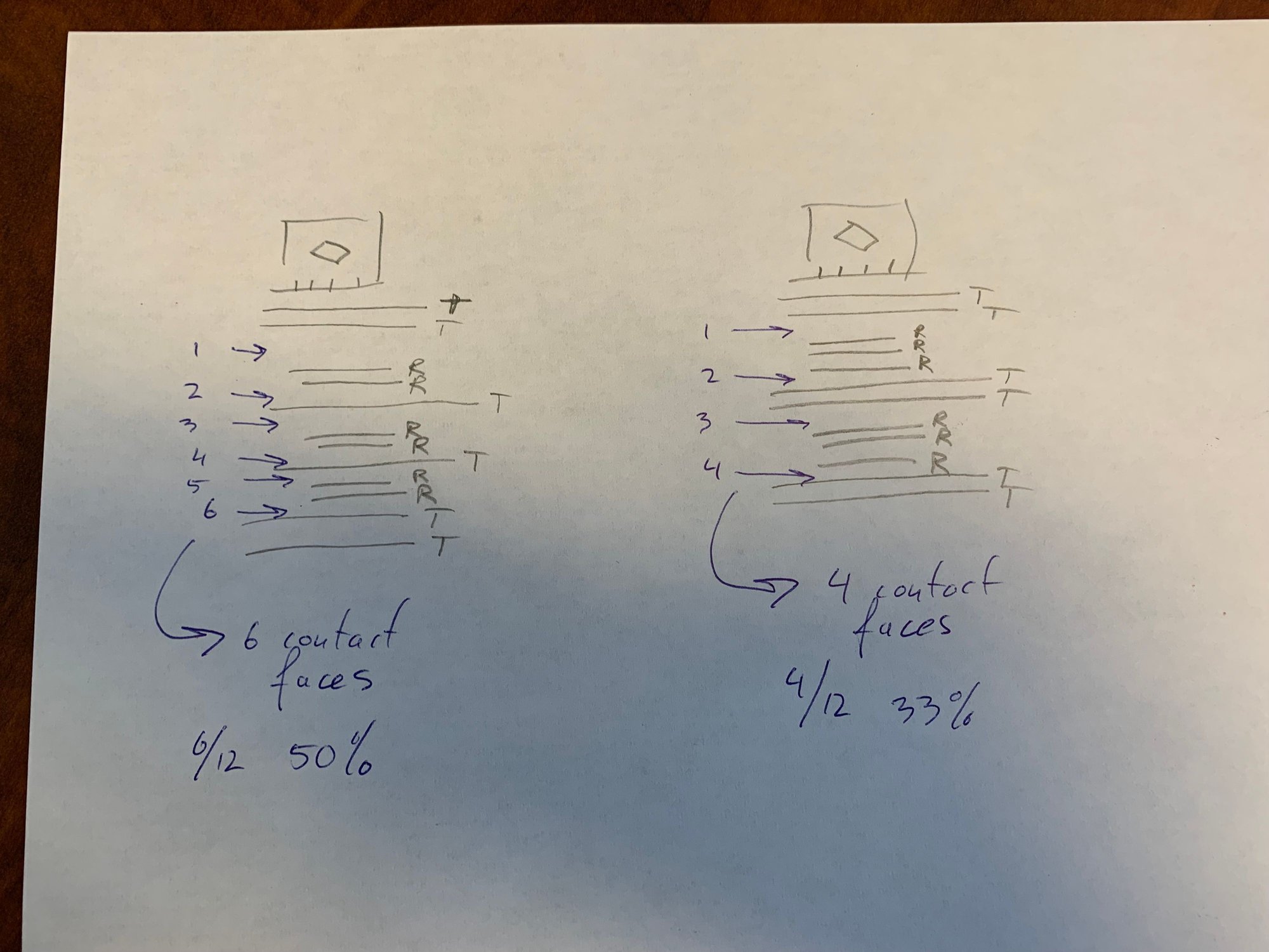

I just started my install of a Tomei 1.5 LSD and decided to restack the clutches for a softer lockup. From what I've read and seen the Tomei locks up really hard at 100% and is probably too much for a relatively stock powered car on sticky street tires. Also I'm not too keen on having it chatter and skip like a madman on every parking lot.
Does anyone have experience with this diff and restacking the clutch plates? Any recommendations on what I should try as a first go with this lsd? I'm probably going to aim for 60% lockup, but would love to see what others think.

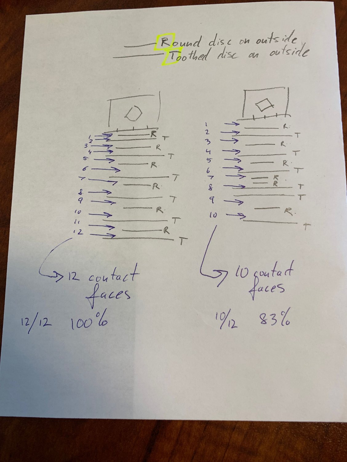

That's very interesting to hear because that would suggest you have 10 contact surfaces vs the original configuration of 12 surfaces. Drawing on the left is factory configuration of the Tomei, drawing on the right would be yours based on my understanding:
I've seen a few threads about people complaining about just how loud LSDs like the Cusco or the Nismo are even configured at only 6 contact surfaces (60% or 6 out of 10 contact surfaces). So to hear that you have a relatively quiet experience with 10 contact surfaces vs those guys at 6 is surprising. What oil do you use? Are you using any oil additives? Friction modifiers?
I actually found an oooold Sports Compact Car article from when they ran Project 350z (only way to find it now is on the webarchive) and they installed a Kaaz LSD which also has 12 discs per side (and therefore 12 contact surfaces). They didn't get it to behave until they reduced the contact surfaces to only 4 AND added new sticky tires. So I was actually going to do the same, reduce it down to either 6 or 4 contact surfaces. I'm stuck on this decision. The configuration would look like one of these two:
I'm now leaning to 6 contact surfaces if you've had no issues at 10.
Excellent diagram.
I swapped two pairs of plates. Meaning that I have 8 contact plates. I run Motul gear 75w140. I have 285/30r18 Pilot sport 4S rear tires.
https://kaazusa.com/product/nissan-f...z-lsd-1-5-way/
This KAAZ diff is basically identical to the toemi setup. I used the 65% option.

no worries, I welcome the discussion. If you do ever take the nismo apart for a clutch re-stack I would love to hear about it.
I put the diff back together , unfortunately forgot to take pictures. I ended up taking the 6 contact face option per side and essentially putting the round discs into 3 groups (each group provides 2 contact surfaces, for a total of 6). The one difficulty I had was that getting the housing to slip onto all of the discs without them moving around and binding between the two housing halves (top and bottom) was tricky.
I'll try to pull the diff out of the car tomorrow or this weekend latest and do the swap. Hopefully I don't need any shims because I need this to be back together and tested before my track day later this month.
Really glad GreyZ chimed in with his experience with 8 contact surfaces as based just on that old Super Street article I was going to go with 4, but now I think I'll try the 6 first and if its still loud or a bit too ON/OFF at the track especially on long sweepers then I'll just add some friction modifiers or a different oil (Motul 90PA seems to be a favorite). I might actually go so far as to bring some friction modifier additive to the track later this month and add some in between sessions if the diff doesn't behave.

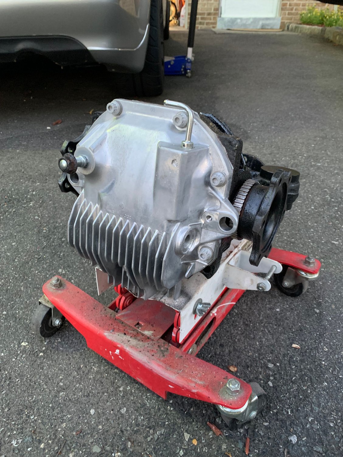

ok, update time:
LSD install is done. Couple of neat things along the way.

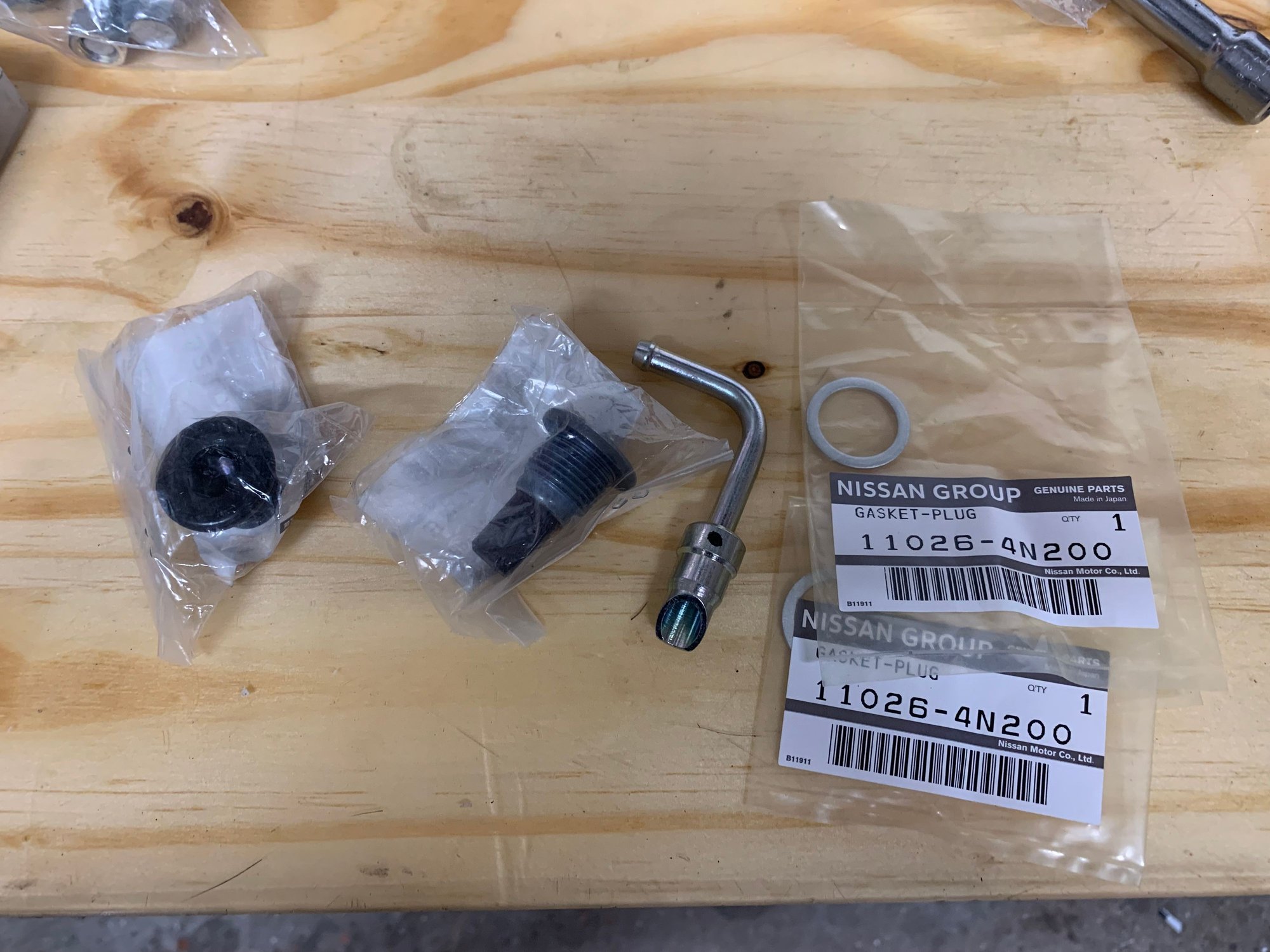

Ended up installing a bunch of new hardware since all the old stuff including plugs and oil overflow were either rusted or not really usable anymore:

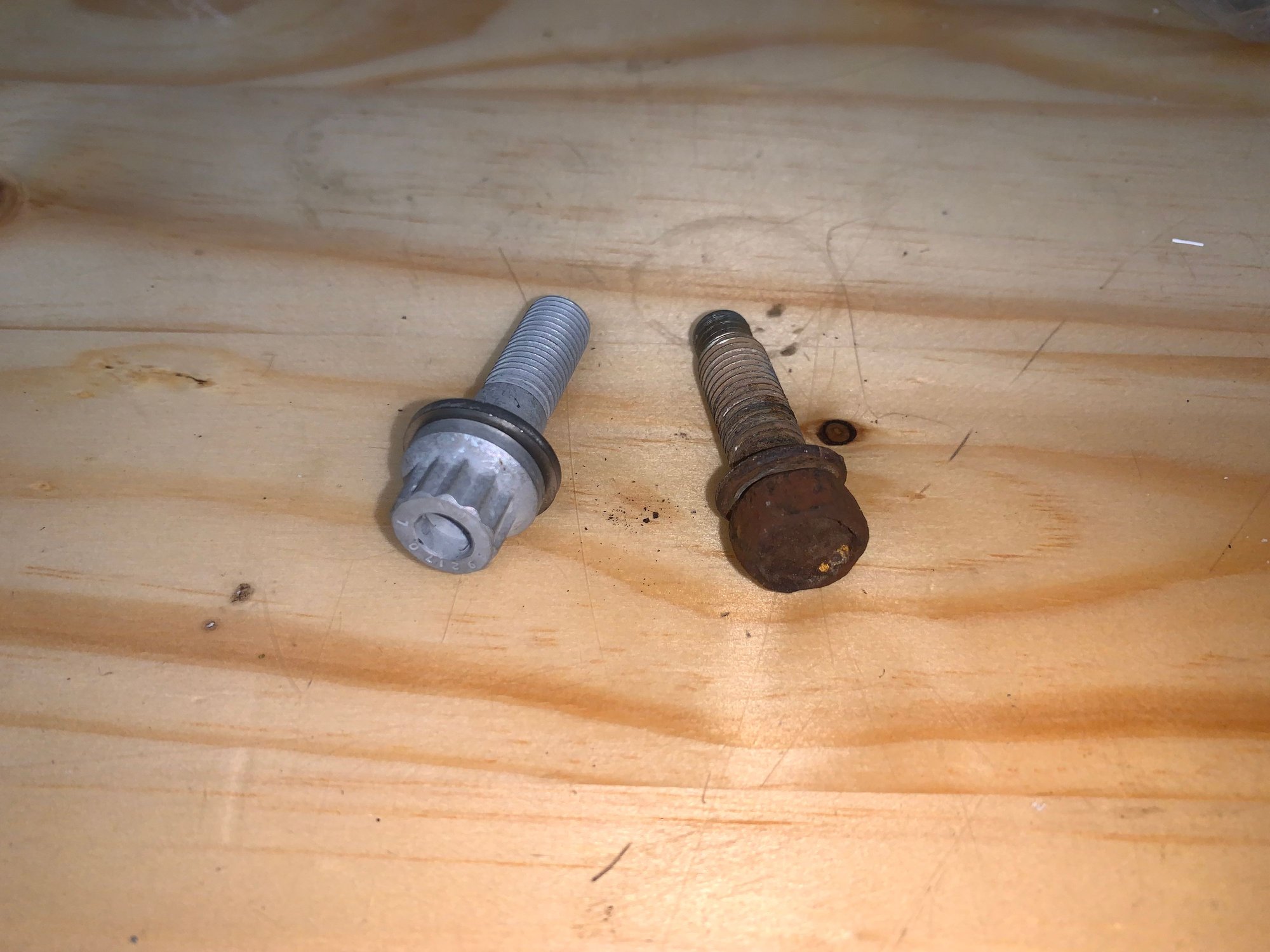

This included all new half shaft hardware. All my old bolts were rusted. Honestly the rust is one of the primary reasons I keep switching to titanium almost everywhere.

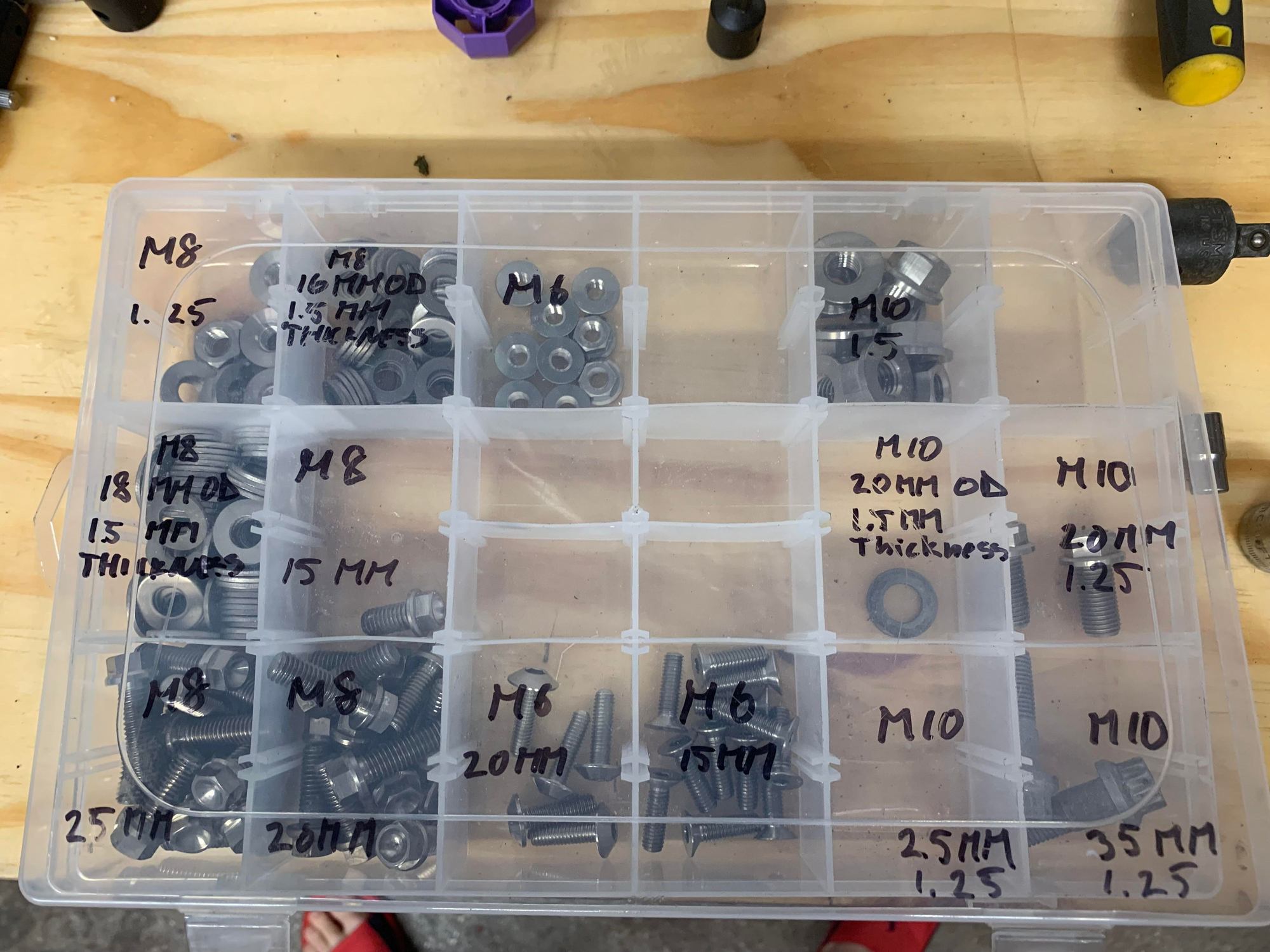

Old diff cover bolts were rusted and disgusting, so I replaced with titanium m10 1.25 bolts. These will never rust.
So apparently there is a gear oil specific gasket maker. Had no idea before, but used it and it seems to hold up fine:

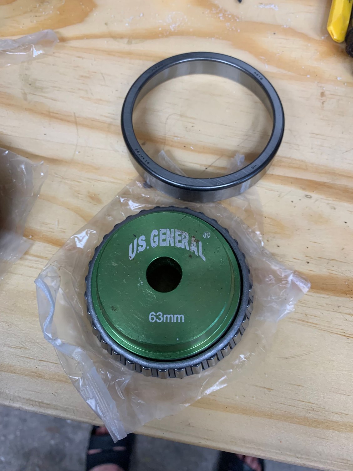

Pressing on the new bearings was easy. You need about a 63mm flat disc to push them on:

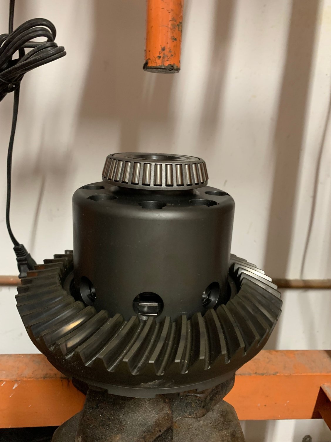

I have a small harbor freight press at home that made this part easy. Absolutely no difficulties pressing the nissan bearings on:

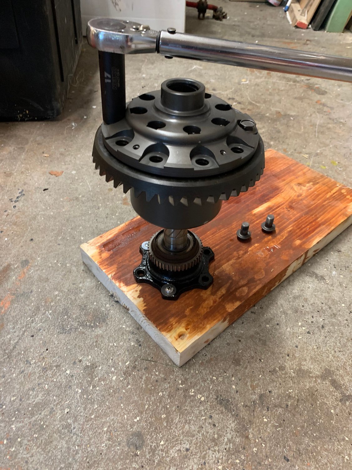

Next came the ring gear bolts. A bit of blue loctite was used:
I don't have a vice, so what I did is bolted down one of the halfshafts to a plank of wood, placed the diff on top of the shaft, and then had zero difficulties getting the ring bolts to the right tourque spec.
I also marked them up with a 0 deg, 45 deg, 90 deg marks on the bolts after torqueing down. This way I can get the last 33-45 degrees the FSM calls for with my impact gun:
The last ~45 deg of rotation to properly secure the ring bolts:
old ring bolts look good, but per FSM, these are done:
