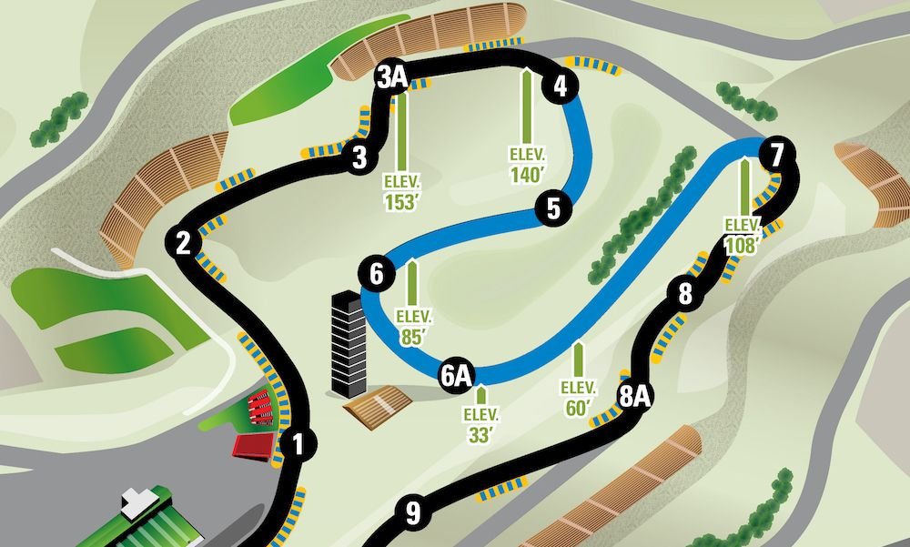

awe, damn... NASA norcal is running Sonoma with the NASCAR bypass next week. dammit! that skips turns five and six and goes from four straight to seven which would be FKG awesome. (lol, That's the route you take when you spin out at 4 and wind up in the dirt and just continue on to 7...). and I just got the Garmin catalyst which I could try out for the first time... I'm really torn... I don't want to spend the money right now. I'm in the midst of upgrading two cars and paying off a bunch of bills. and I still don't have the damn camshaft position sensors installed in the Z. I've been insanely busy working 5 days a week. I know that's a normal shift but I also run the business in addition and so its 50 hours of driving plus everything else... like doing my own oil changes on all of the vans... $40 versus $110. I'm not a cheap *** but both jiffy lube and my local favorite shop keep tightening the hell out of the filter and drain plug and wrecking the air flow panels underneath. pisses me off when shops do that. so I do that myself. anything more difficult I let the shop do it. like $1,000 alternator last week and a $2,000 AC compressor 2 days ago. this **** is expensive but I don't have time or the inclination to do that kind of work myself. they had to pull the radiator out of both vans to do those jobs. just saying, the track is relaxation and the cost is negligible compared to some of these expenses, but... I've already blown to track days this spring due to problems coming up. as much as I want to go next week, I think I'd better not. odds are I'm going to throw the money away by not being able to go at the last minute. this has been a shitty year for my personal time. but I just meant to share with you guys that the NASCAR bypass would be amazing. I am so tempted to sign up and just go even if the car is not 100%.. The problem is when I start making compromises like that, then I'll run into problems, breakdowns, failures. it's better to not extend yourself too far out. and I feel very stretched right now. so, I think this year might be just a scratch for any kind of track progress. damn, what a frustrating year it's been. getting the car done and then not being able to drive it....

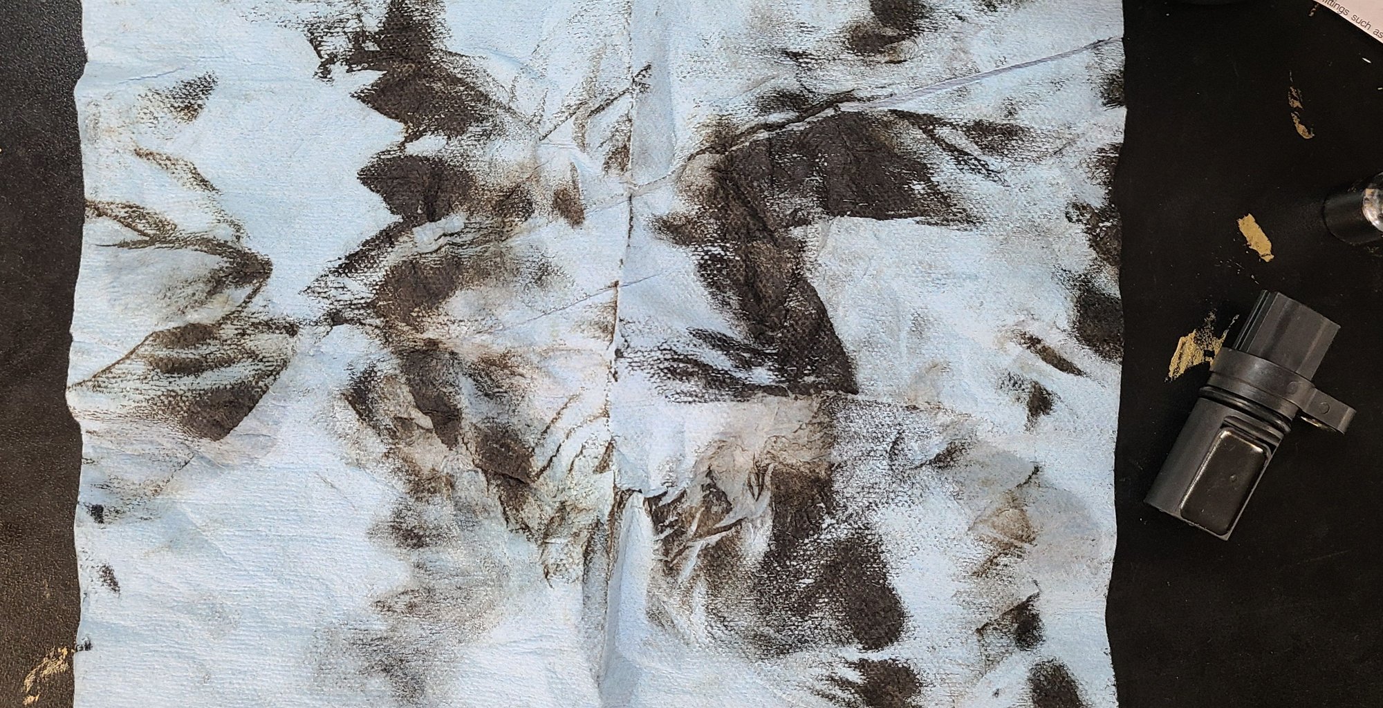

I got the CPSs installed and after warm up ran the car pretty hard for 40 miles to simulate one track session and not a single code light. for the first time in this car, I revved it up to 6K while simulating a track run on the nearby highway that has low traffic in the early mornings. I've never shifted at 6K in the Z. let alone 6600. I know, don't say it, just I've taken it easy on this car because it had 90K miles. so today I said screw it and revved to 6K, and was pleasantly surprised by how well the car performed. it has definitely been held back by the CPS errors.
2 years ago that showed up for the first time and I just cleared the code and didn't do anything about it. I know, that was dumb. now with the new sensors installed, it feels like the car has a lot more power. I don't doubt that the computer was pulling timing. for how long? I don't know but lesson learned... which is why the car felt like it could easily hit 6K for the first time.

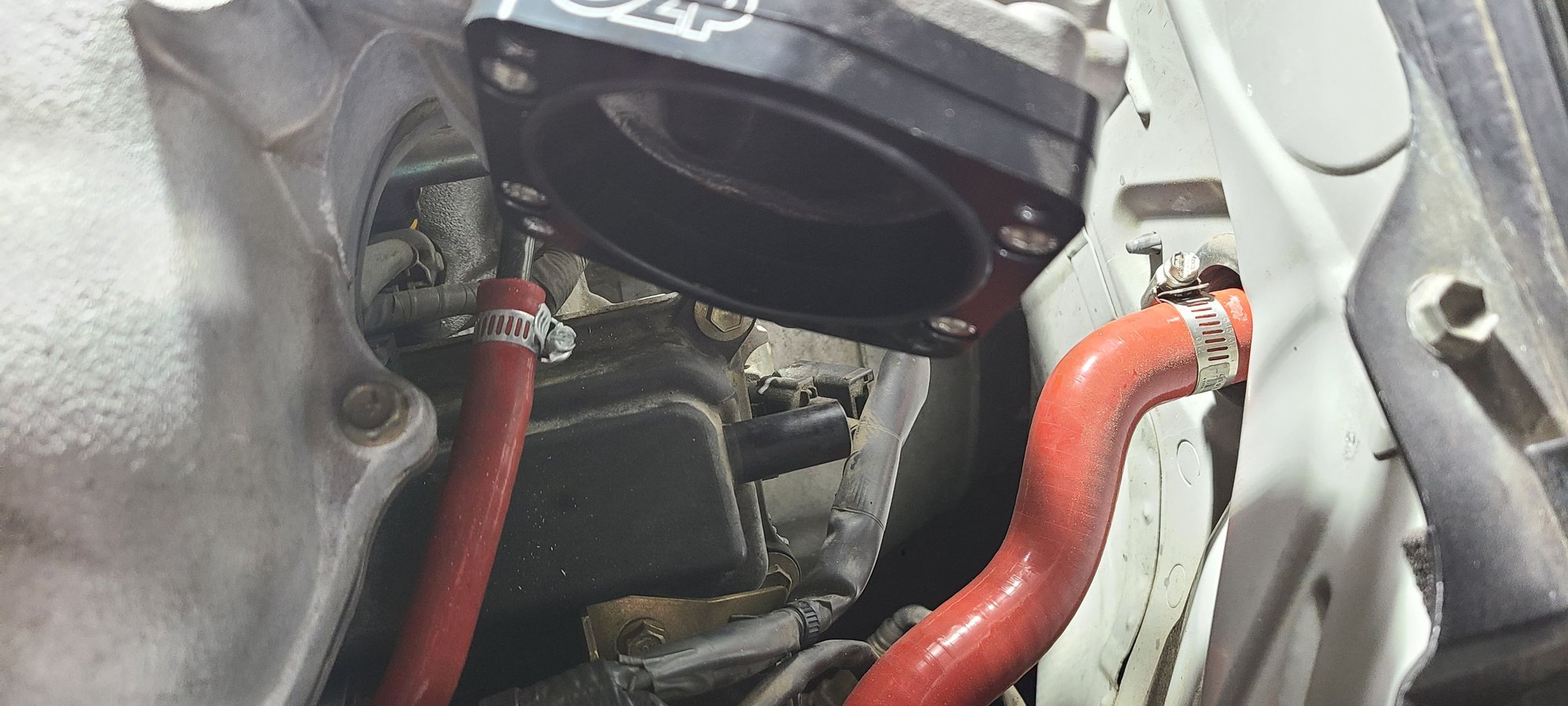

while I was doing the install and the TB was out, I noticed a lot of grime inside the intake tube just past the TB. so I definitely need a catch can. this is a lot of **** in the intake.

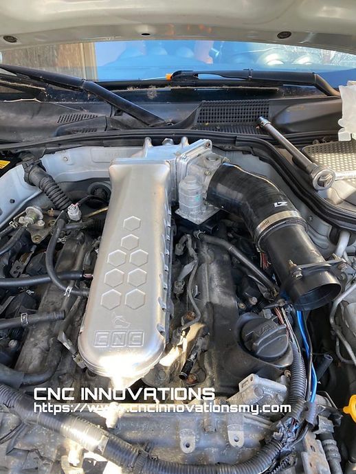

Just found this company that builds custom intakes. they have a complete upper and lower manifold. I'm sure this has been mentioned elsewhere on the site but it's new to me. The upper and lower can be purchased separately or together.
https://www.cncinnovationsmy.com/search?q=350z
https://www.cncinnovationsmy.com/pro...with-rotatable
these valve covers are also nice looking.

damn those are some nice looking intake manifolds! never heard of that company.

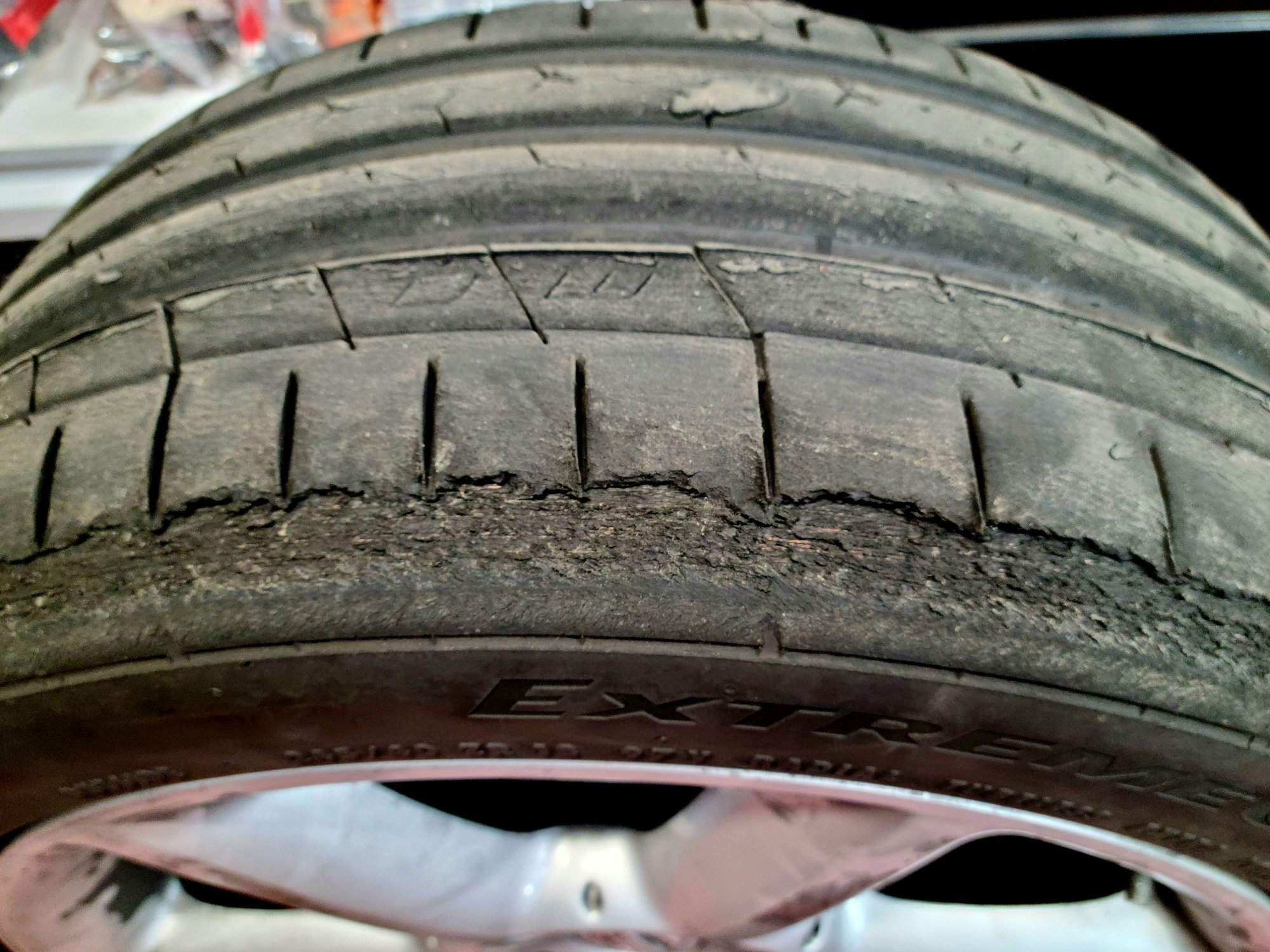

The clutch is already starting to go. not slipping yet but I can feel the loss of friction. The VLSD is clunking BADLY. and there's something going on in the front right, an intermittent vibration. Don't think it's the wheel or caliper because vibration stops on clutch in. could be the new engine mount. maybe I forgot to use loctite? ugh.. it's tough getting in there. the y pipe has to come out at minimum. when I installed the mounts, I had the steering rack off also so it was comparatively easy then.
I am at the phase with this car where there are still some OEM parts wearing out that makes it seem like an endless job, that the car is forever needing attention, but these are just worn out parts. a new clutch and diff will make a huge improvement, I'm sure. I have to address all of these issues before installing FI. so much for the build being done....

Unless that custom intake clears the strut brace it's worthless for anything besides a drag car.
