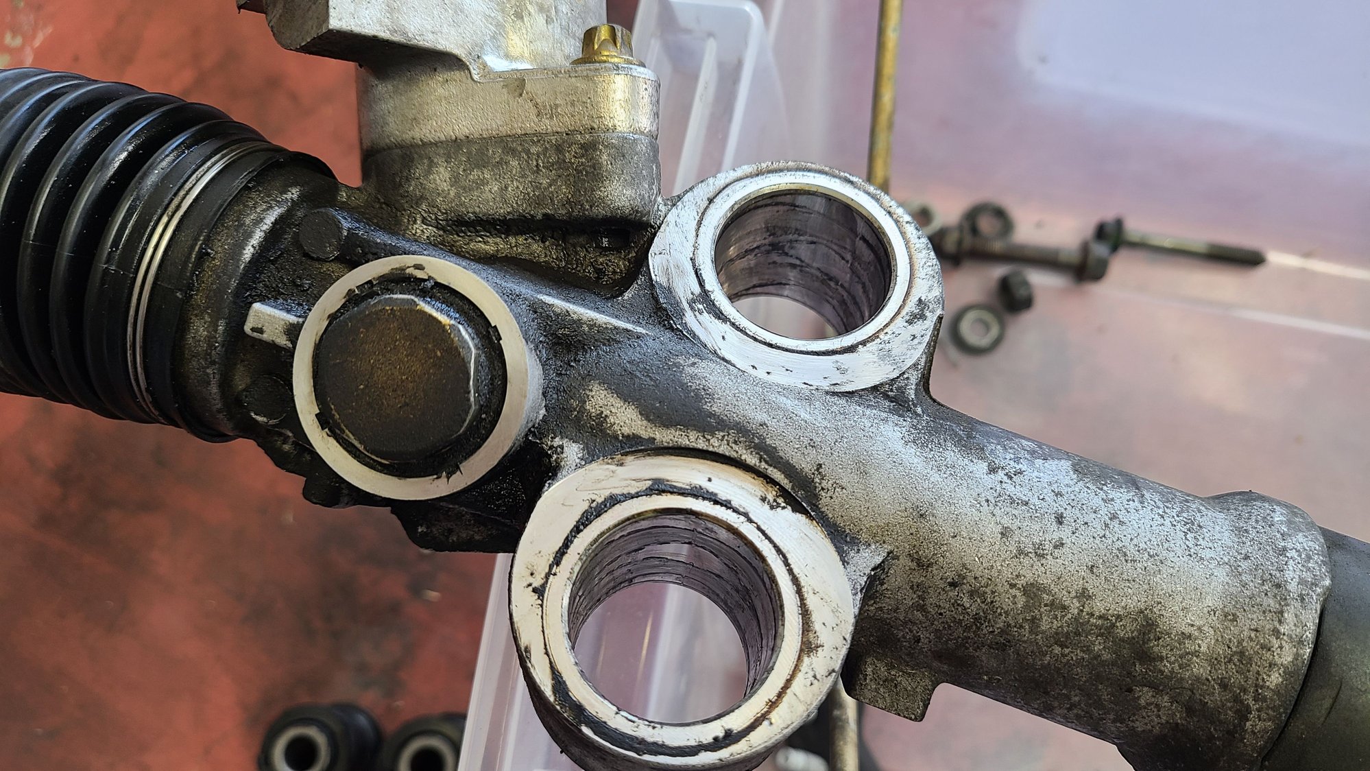

it took half a day to install them with a press. worth the effort. just be sure to center the wheel before you take it off. and be sure to top off the PS fluid afterward. I forgot to do that and got air lock in my PS pump which I thought killed it but the fix for that is turning the wheel all the way left to the lock and then all the way right to the lock and holding it a few seconds, that seems to clear out the air.

thanks for the info on the steering rack, I'll def. do that this summer when its too hot to run. Good luck on the VDC stuff, im glad I got the base model

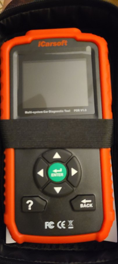

I have an iCarSoft POR for the Cayman used mainly to clear the oil change notification. do you have one of these for your 986? anyway, yeah, a custom device for the 350Z is a great idea...

No, I don't have one for my 987, I just live with the oil change reminder popping up for the first few seconds the car is turned on. What else can it do besides clearing this message?

iCarSoft is set to your car's vin so it's definitely not just a generic Porsche code reader. flat 6 had to send me a replacement when the first one wasn't programmed for my car. it can do all kinds of useful things, similar to that Z1 scanner. like, retracting brake pistons, engaging ABS for brake bleeding, running smog tests, etc.

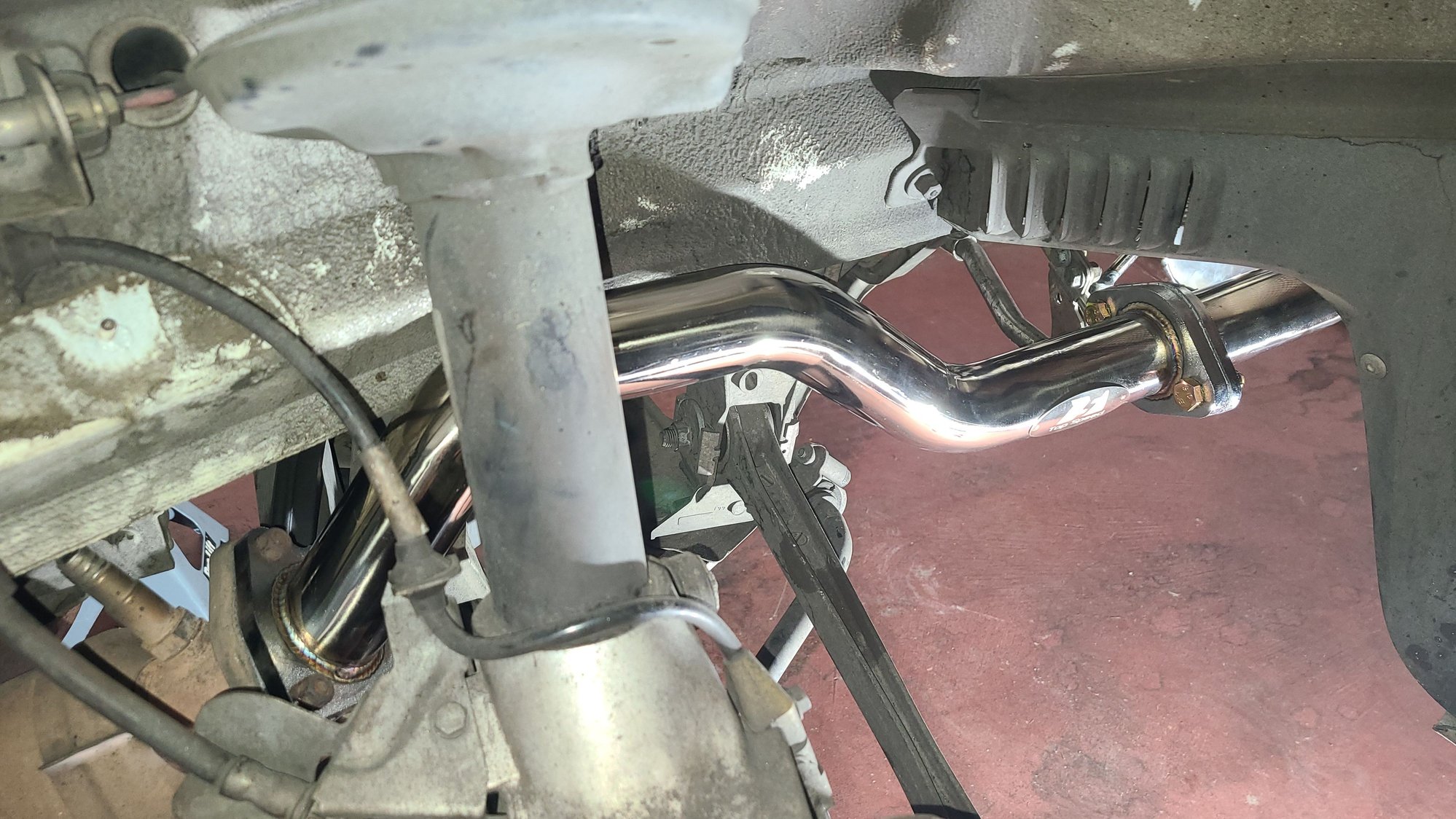

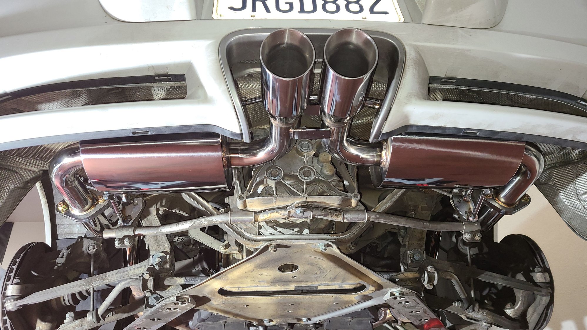

after buying the car last year, a recurring engine light kept coming up and the code was exhaust related. I don't recall the actual code now. I replaced the cat back and the code hasn't returned. I think one of the secondary cats was clogged. since those aren't required for smog, that's one good reason to replace the factory cat-back.
this piece was only $500 from topspeed1 which I don't understand because the competition is $2,000+. it cleared the problem and it sounds good. made in Texas. I think people assume it's poor quality because of the price. but the welds were all good.

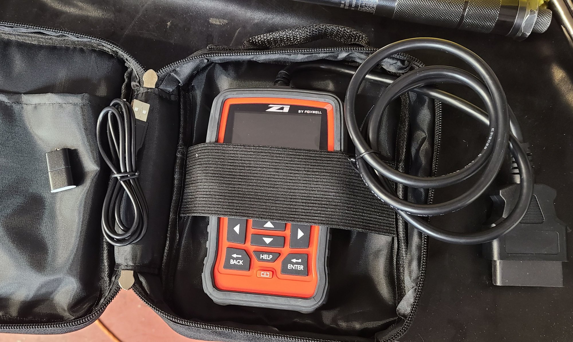

The Z1 Foxwell arrived. It's very helpful. Essential for a track car.
in the Nissan specific menus, there are error codes stored for each module separately from each other. The steering position angle sensor was throwing a code so I realigned it. Don't know if that worked or not. there's also a code in the ABS system.
you can also play with the systems, toggling switches.
there were no generic OBD2 codes.

p.s. The VCS off and slip lights are off now. so one of those two Nissan codes triggered those two lights which I don't know, I guess it was the ABS. could have been the steering position sensor. just went out for a drive and the car is a terror on public streets which are just silly. this car is like a tiger in a cage. If I turn off VCS, I can totally drift U-turns in 2nd gear.
sorry about the gushing here folks but it's been a long time on jack stands and I am enjoying the hell out of this car finally. again. thrilled that the dash lights are off. that foxwell device was a good investment.
