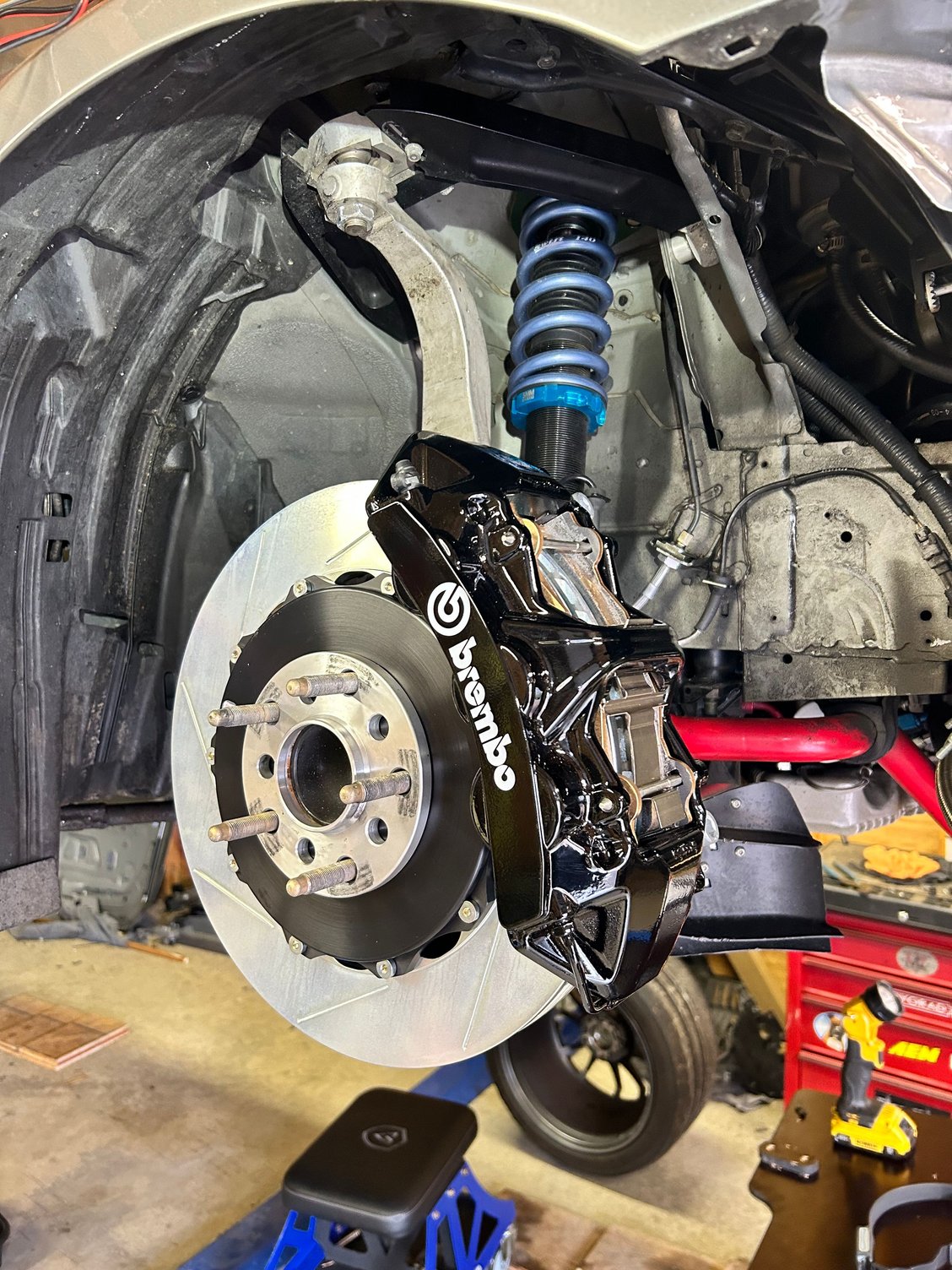

just got back from VIR, had a great weekend. here is a few pics of the event. had a great battle with this mustang and GSF. I couldnt resist buying a pic of this amazing gt4rs. I ordered the AP racing 6 pot front brake kit and the 9 lives downforce kit for my winter project on the car. I also had a titanium exhaust made I'll post some pics up.

Finished up another weekend at VIR. Ran DE3 which was awesome. passing anywhere on track. Car did great, the new brakes are insane. Still experimenting with the aero, I had to remove the splitter because it was bottoming out, not enough bracing. Managed a 2:08, which is my personal best. Still plenty in the car.
