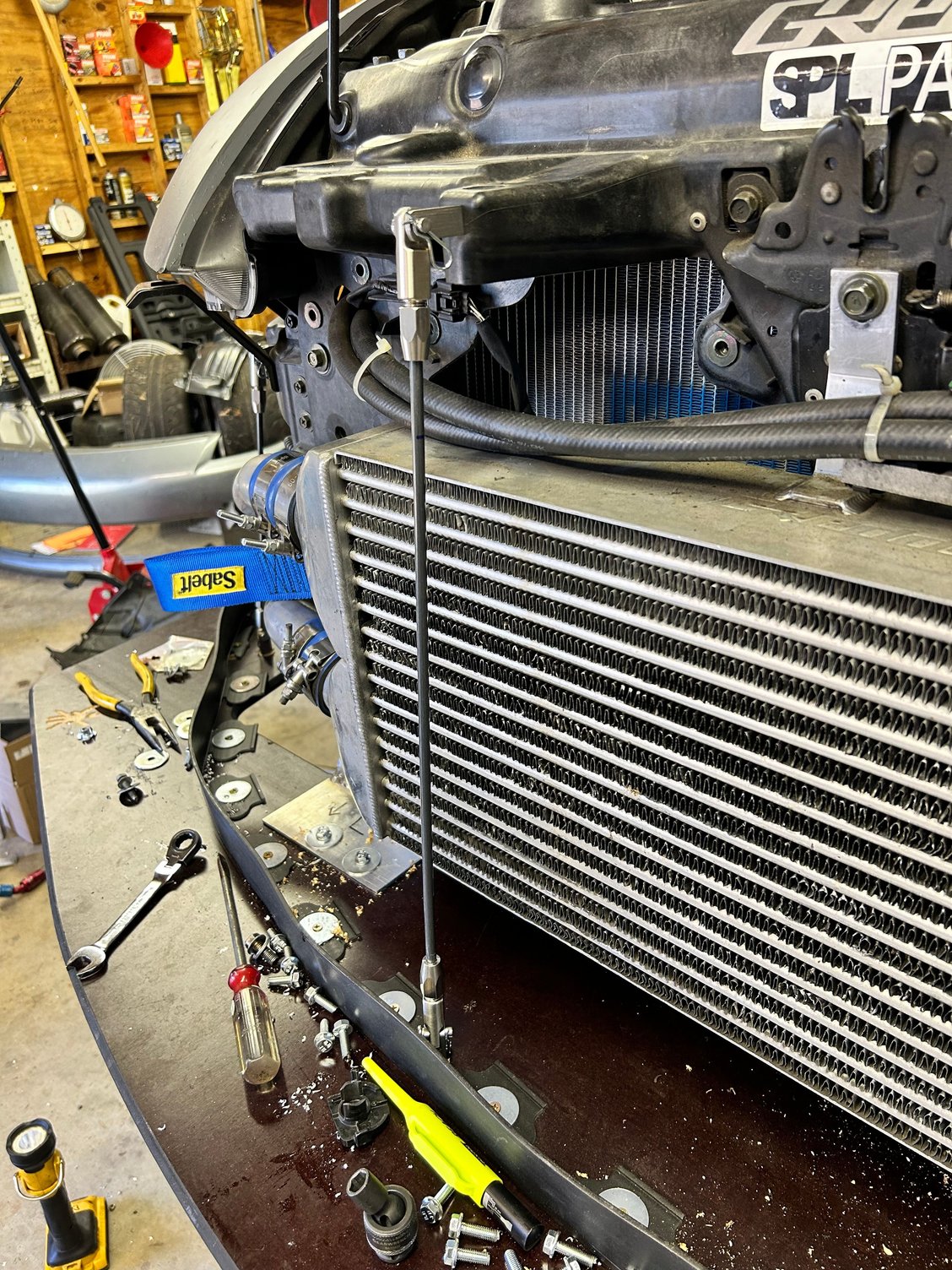

Originally Posted by isy_nismo
Pls Could you share details on the fron splitter? Mounting brackets etc.,....
Im running the 9 lives medium downforce kit. I have their sturdy boy brackets and then mounted 4 professional awesome supports on it the stiffen it up a bit. They are really nice because they can flex a bit and pop back into place. Here is a pic with the turbo setup. I got some titanium biscuits to put under them on the bottom and some on the sides.

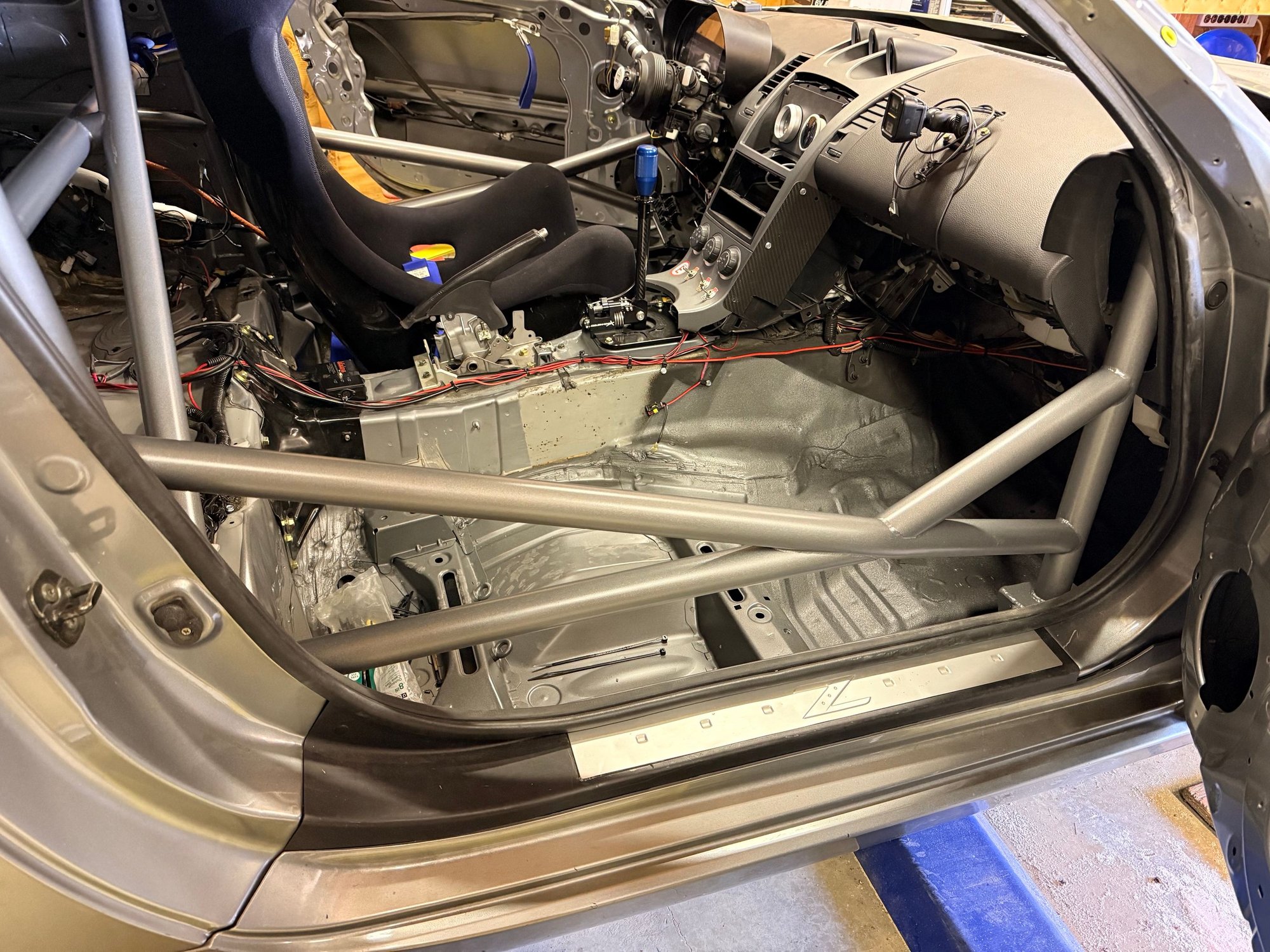

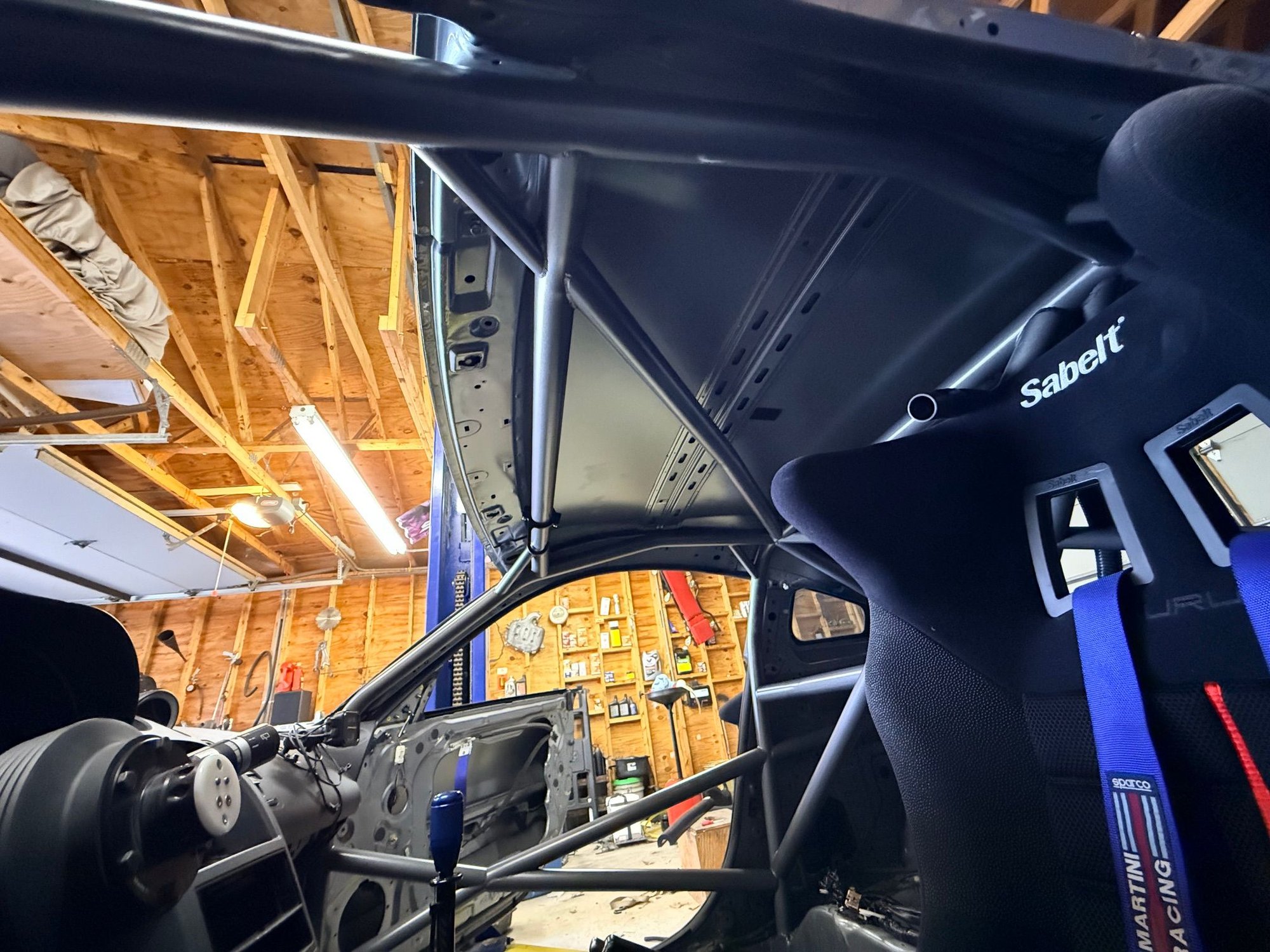

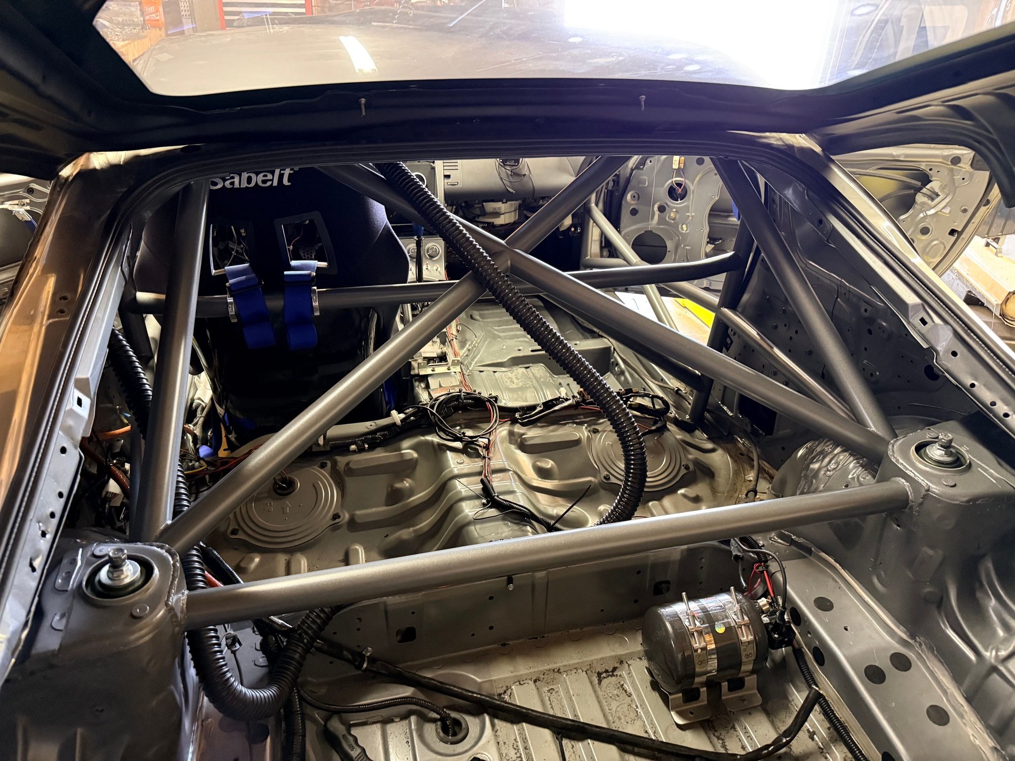

got the cage in. ended up doing chromoly. It turned out really good I think. Did a event at VIR a few weeks back with PCA, car felt great. My alternator ended up dying Saturday am, so I had to swap it out and was back out in the afternoon. Im in the process of swapping out the rear subframe bushings to SPL solid and changing out to 4.09 gears. My OS giken diff started to open up on me, its been in the car for 10+ years and most of that was boosted. Sent it off for a rebuild and figured its a good time to change the gearing...I hope it will make a nice improvement in acceleration.

10 years is a long time for a diff! that cage looks sweet. I'm headed in that direction.... how did you like going N/A after having the turbos for so long?
