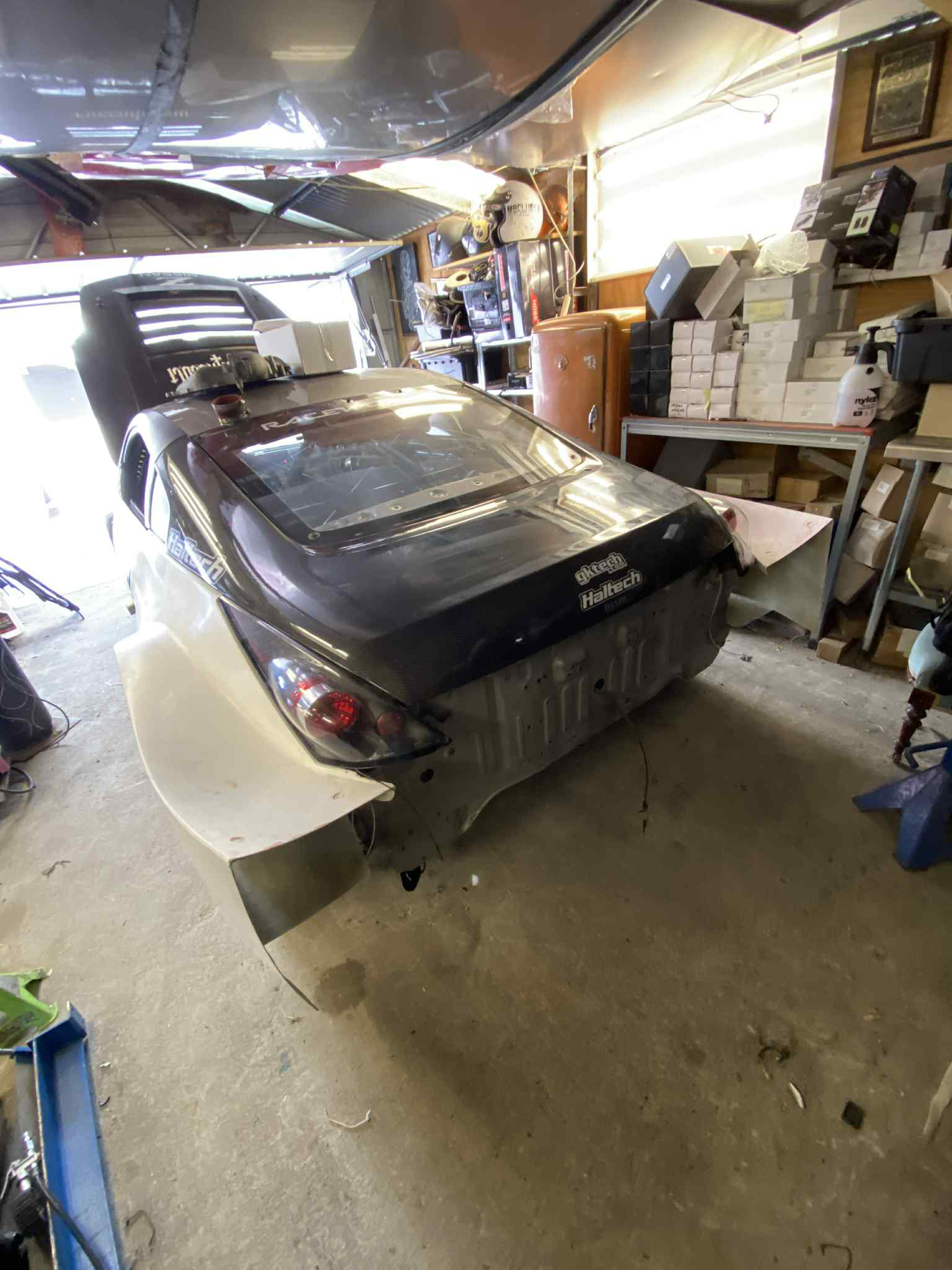

I thought id start a new thread as i sold my old 350z racecar, and was starting to post on that with this new build.
So i have a 350z with a vq35de, full national spec cage, and this was being run by my old man, with twin turbo setup.
The car was pretty tired, and after much thought i sold off the twin turbo setup as it was a ***** to work on, and i like to make things as easy as possible to service etc at track
Here is the car when i picked it up from the old mans, i had previously done alot of work to the care, but it had sat for awhile and really needed some love anyway....

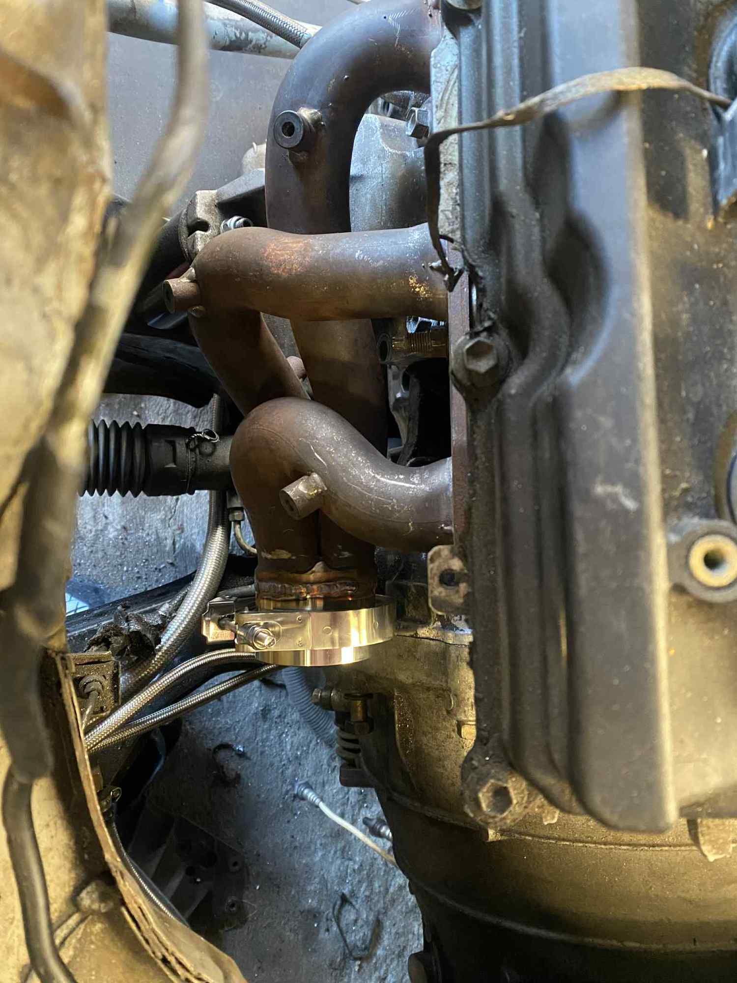

i ended up using some 370 headres and welded v clamps to them for the home made turbo manifold

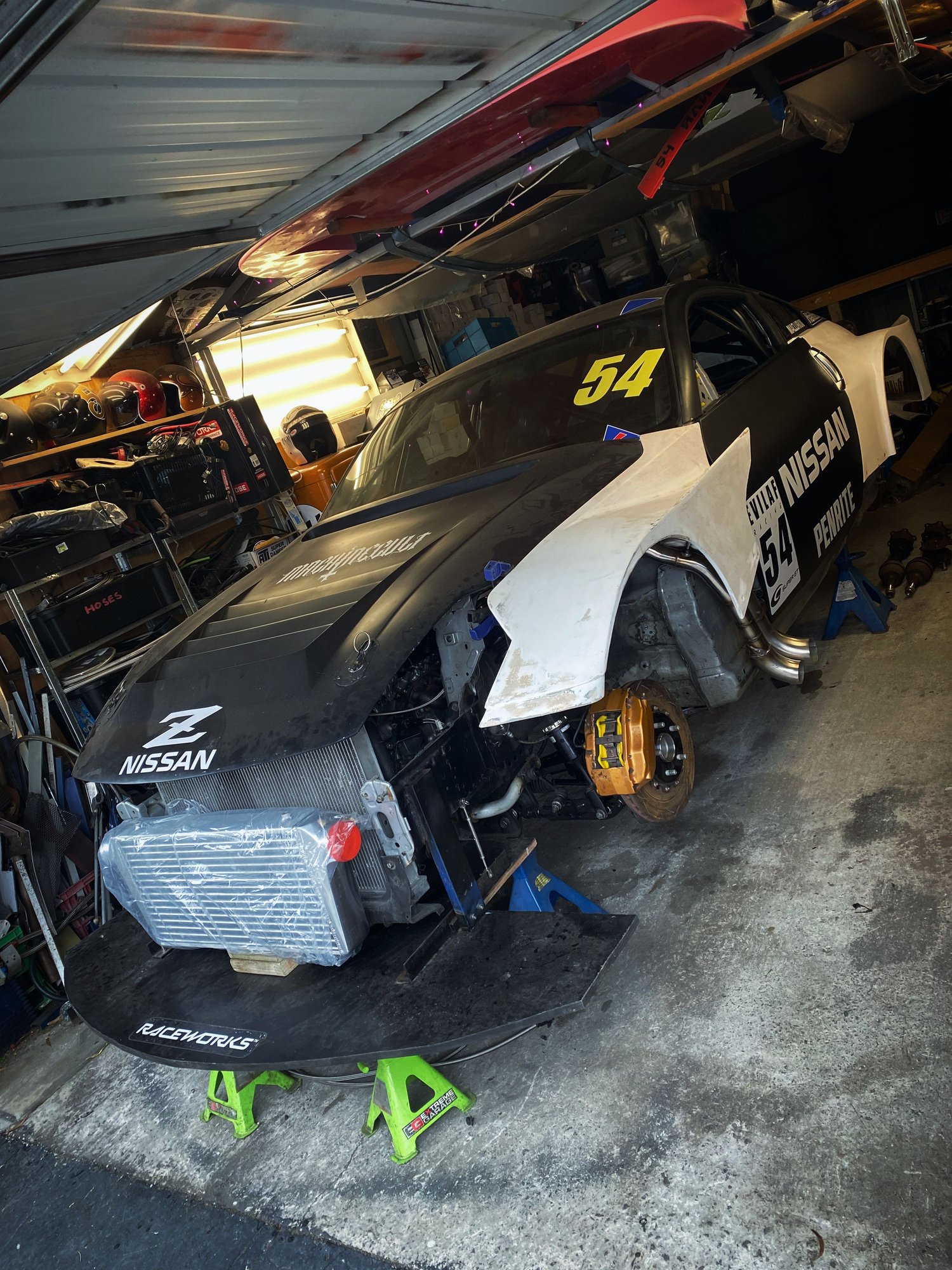

mocked up and had welded my intercooler piping, never done any of this myself before, its been an adventure

couple more jobs done, blow off valve welded on and made an offset bracket so i can run oem alternator and an ati dampener
