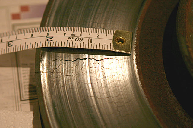

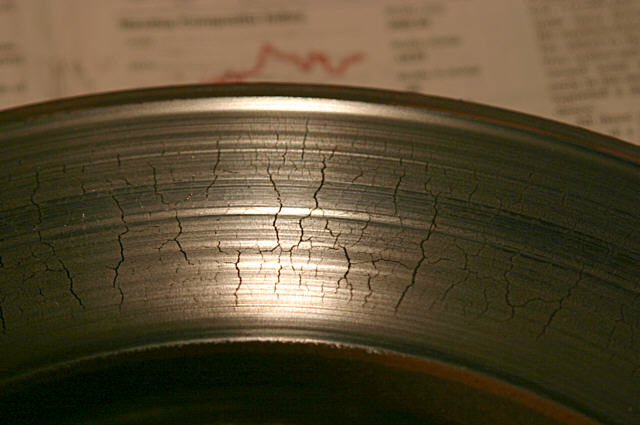

Finally, I put new dba one-piece slotted rotors (from BJ) on the fronts over the weekend. So far so good. Get a load of the cracks in the old ones!

James - nice rotors! What pads are you using?

With over 18,000 miles, (2,655 on track) those rotors have seen the stock pads, three sets of Ferodo DS2500s, and two sets of Carbotech Panther Pluses. I like the Panthers, but I used them up pretty quickly. I may try the Panther XP8 or XP9 next.
I think some brake cooling is definitely needed. Any recommendations?

As for pads, you know I stick by the Cobalt VRs... something I didn't know until recently is that Carbotech uses only a 3-4 ton press to mold the pad material, while Cobalt uses a 10 ton press. The result is a more dense (less porous) pad that wears much better.
