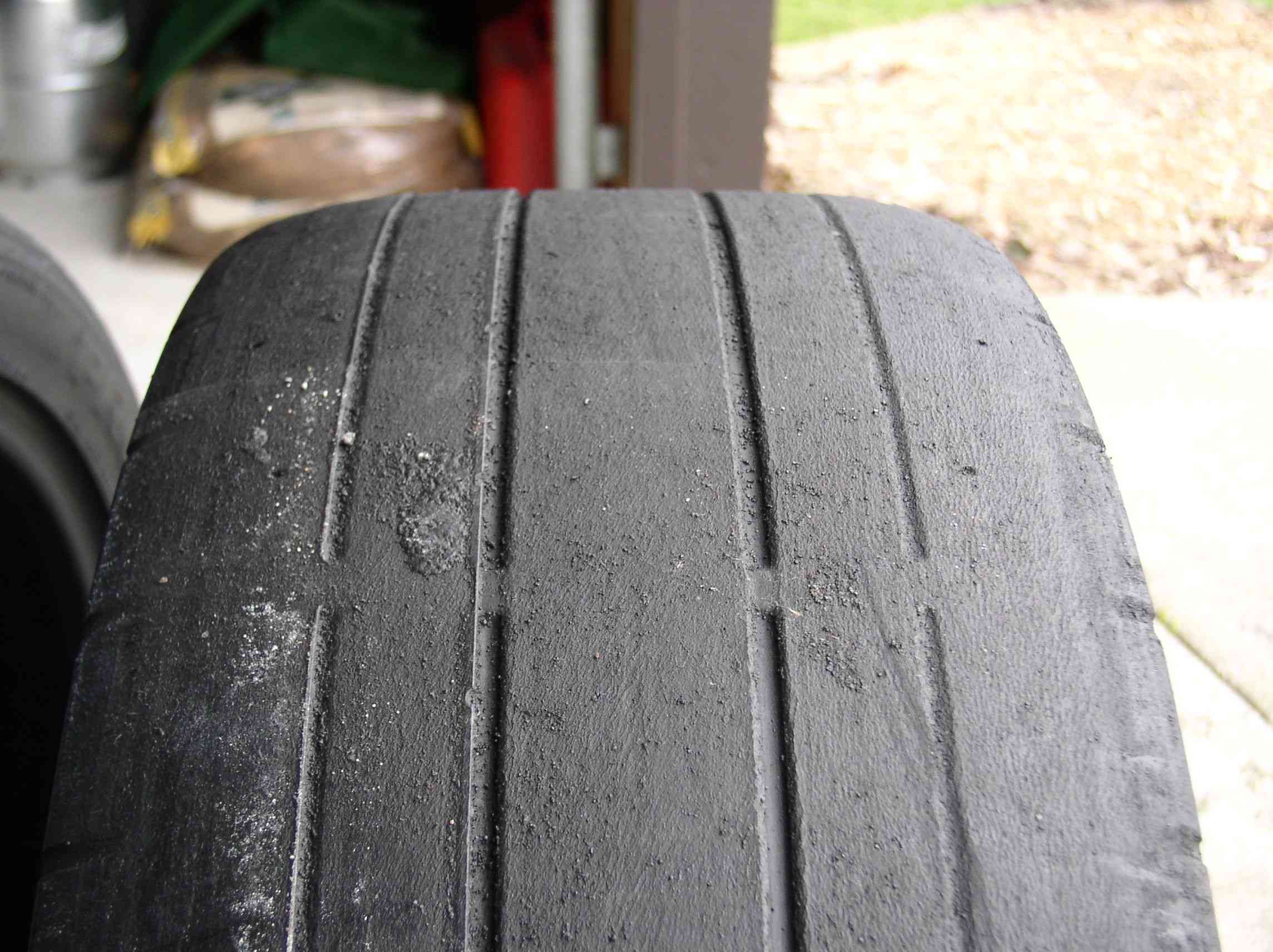

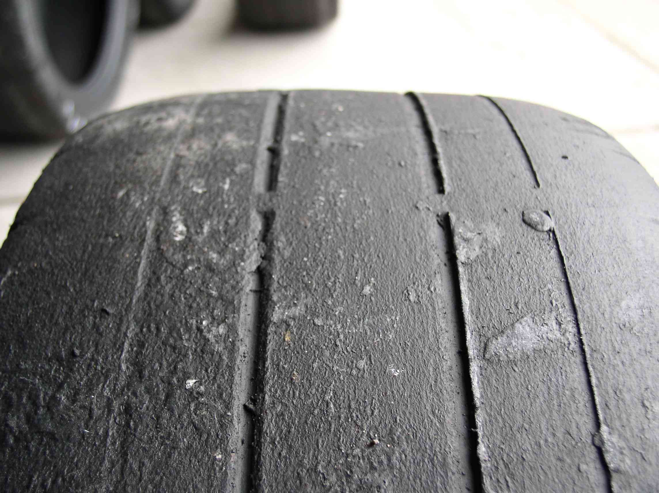

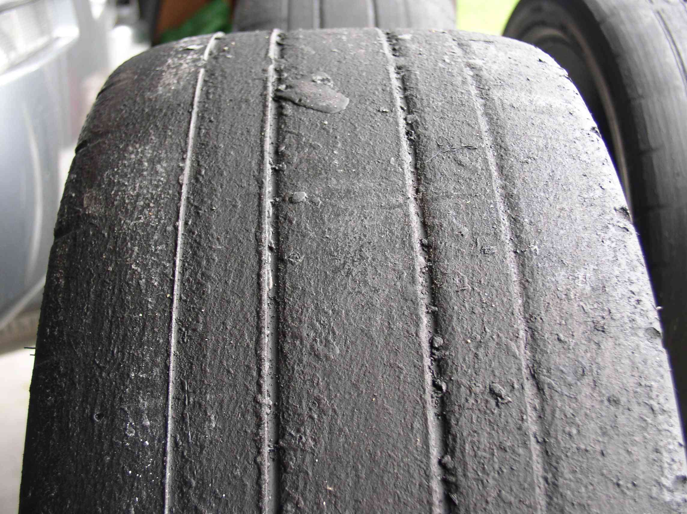

These are the tires I received from John Berget Racing. Is this consistent to what you have received? They are the best tires he had at $70 each, full rubber... First picture is the best tire. What do you think ?

These are shaved RA-1's that have been heat cycled. They look like they have about 1/2 the shaved depth still left. Once you roll on them one time they will clean themselves up, so don't worry what they look like right now.

Those look good. They're almost at the point where they'll be their fastest.
On an RA-1, any time you see 4 grooves, you've got a lot of rubber left.

What will be the first sign telling me that there is not much rubber left ?
Also, for dismounting or flipping them, you mean moving a right side tire to the left side while keeping the rotation in the same direction ?

just take one tire, remove it for the rim and flip it so the outside becomes the inside.
Drive the tire until you see cord or they dont grip anymore
