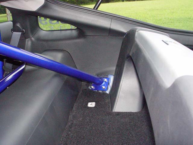

They basically sent me larger versions of what's on their website. This thread has some better pics.
https://my350z.com/forum/attachment....&postid=411364
Can anyone comment on this question?
It would seem like in the event of a frontal impact, the mounting point shown below would take most of the brunt of the force. Would this hold??
