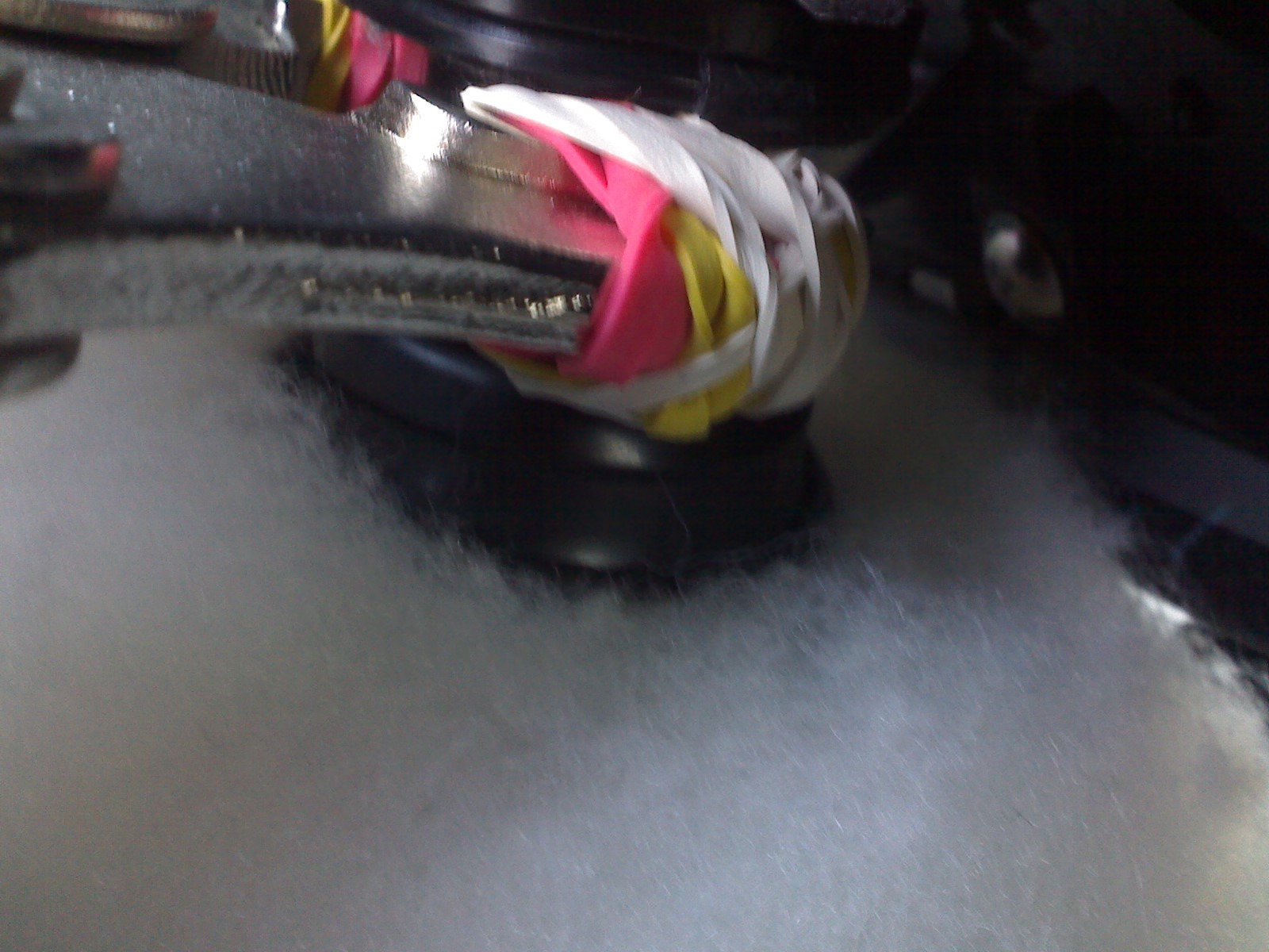

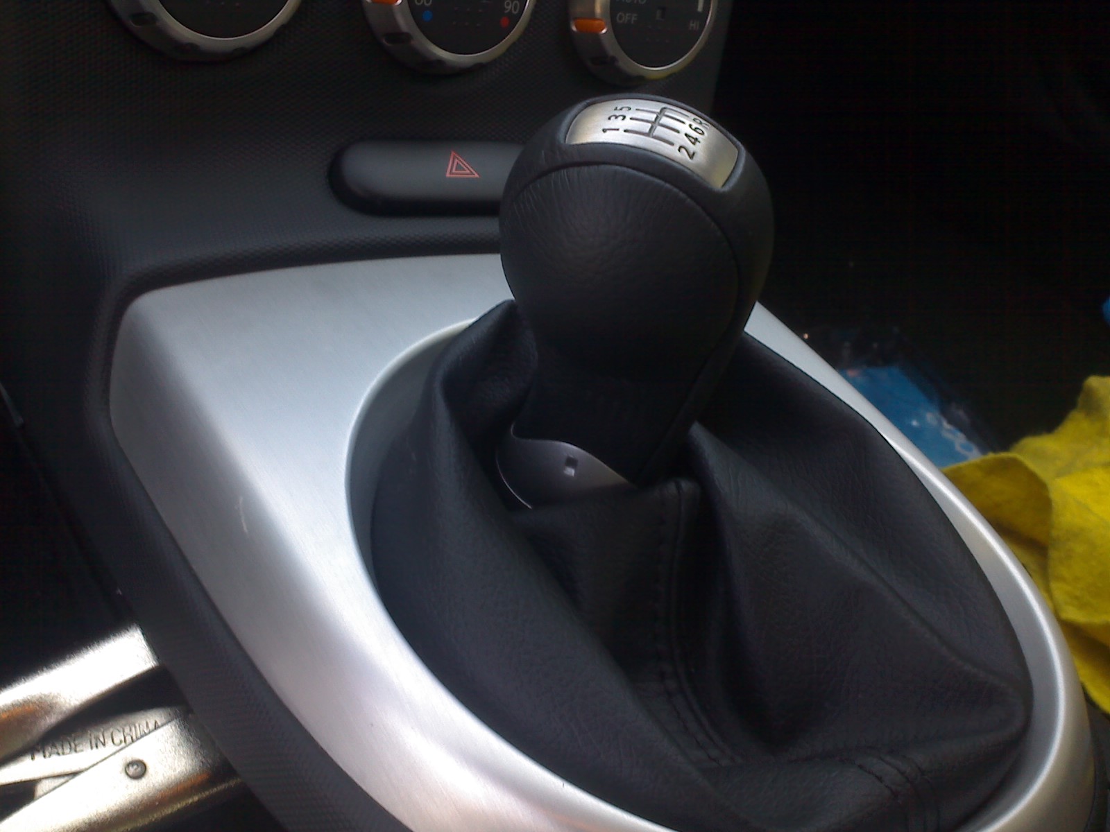

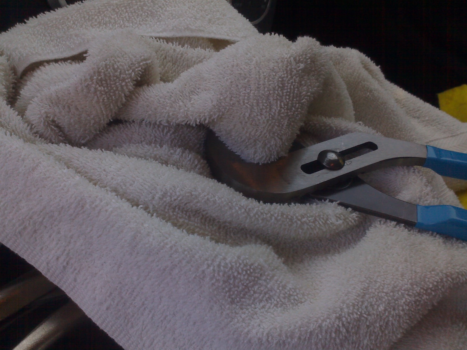

Ok here we go.
It finally worked.
For those with the rubber thing over the shaft: just roll it down to expose the shaft. What i did then was i wrapped around 25 rubber bands on both sides of the vice grips. THIS WORKS GREAT! after that, i just attached them on the shaft. I used channel-locks on the ****, double wrapped a towel around it. And then i just twisted the ****. The vice grips held on the to the shaft perfectly. Here are some pics:

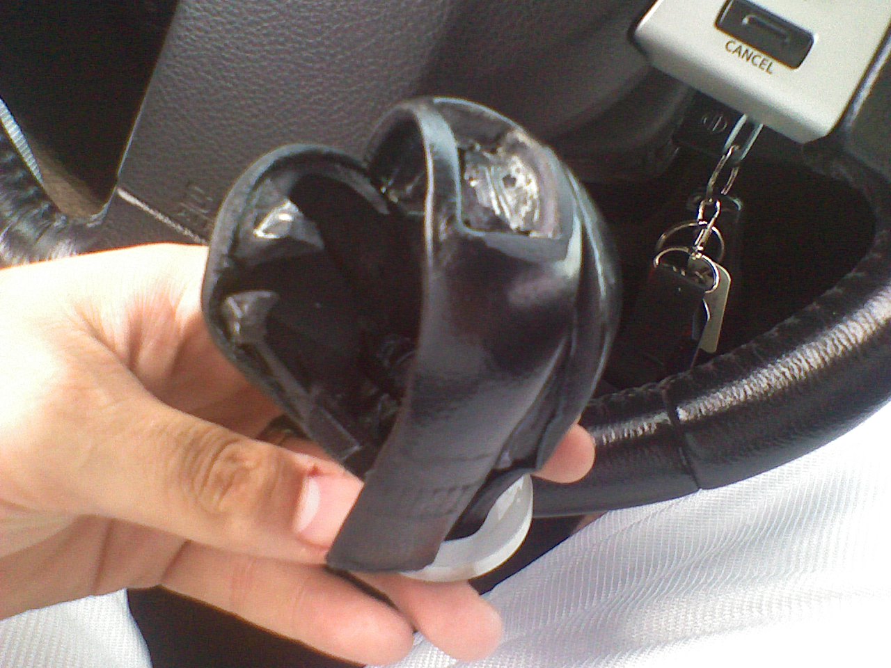

Default I had a Hell of a time removing mine :)
Nothing on this forum seemed to rmove my shift **** so i resorted to TWO vice grips and brute force. My OEM shift **** is now destroyed but i got the new one on and car is fine!!!!!! here ya go check out this one.
