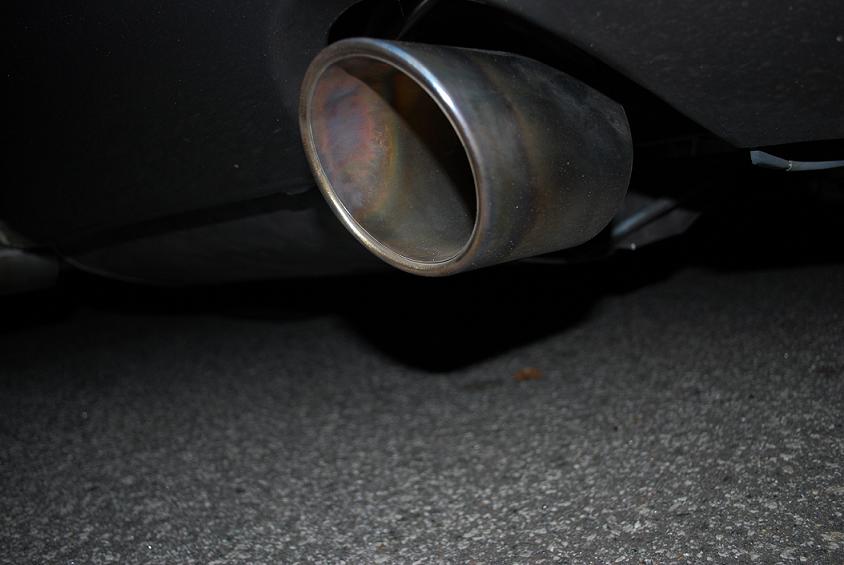

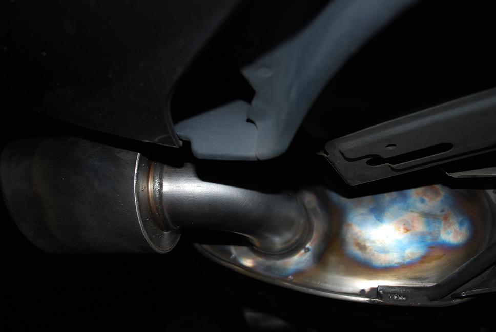

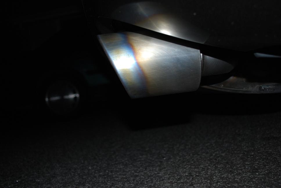

I did this when I had my stock muffler. I thought about doing my EVO 2 this way but have'nt done it yet.
I stripped the whole thing one day with pb blaster and some scotchbrite pads then I took a torch to the tips, around the welds and the sides.
Attached Thumbnails DIY.Titanium Lips for stock exhust!!!-kgjcfkgdf-004.jpg   DIY.Titanium Lips for stock exhust!!!-kgjcfkgdf-005.jpg   DIY.Titanium Lips for stock exhust!!!-kgjcfkgdf-003.jpg   DIY.Titanium Lips for stock exhust!!!-kgjcfkgdf-006.jpg
