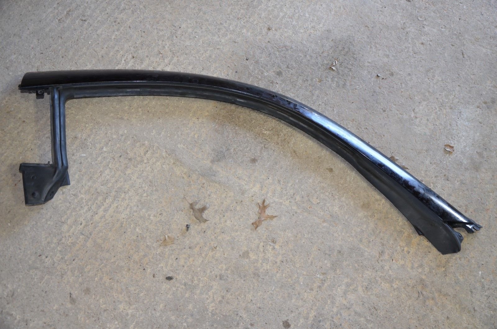

This is the piece in question, it runs from below the fender in front of the door to the top of the B pillar behind the door.
Roof trim, above door.

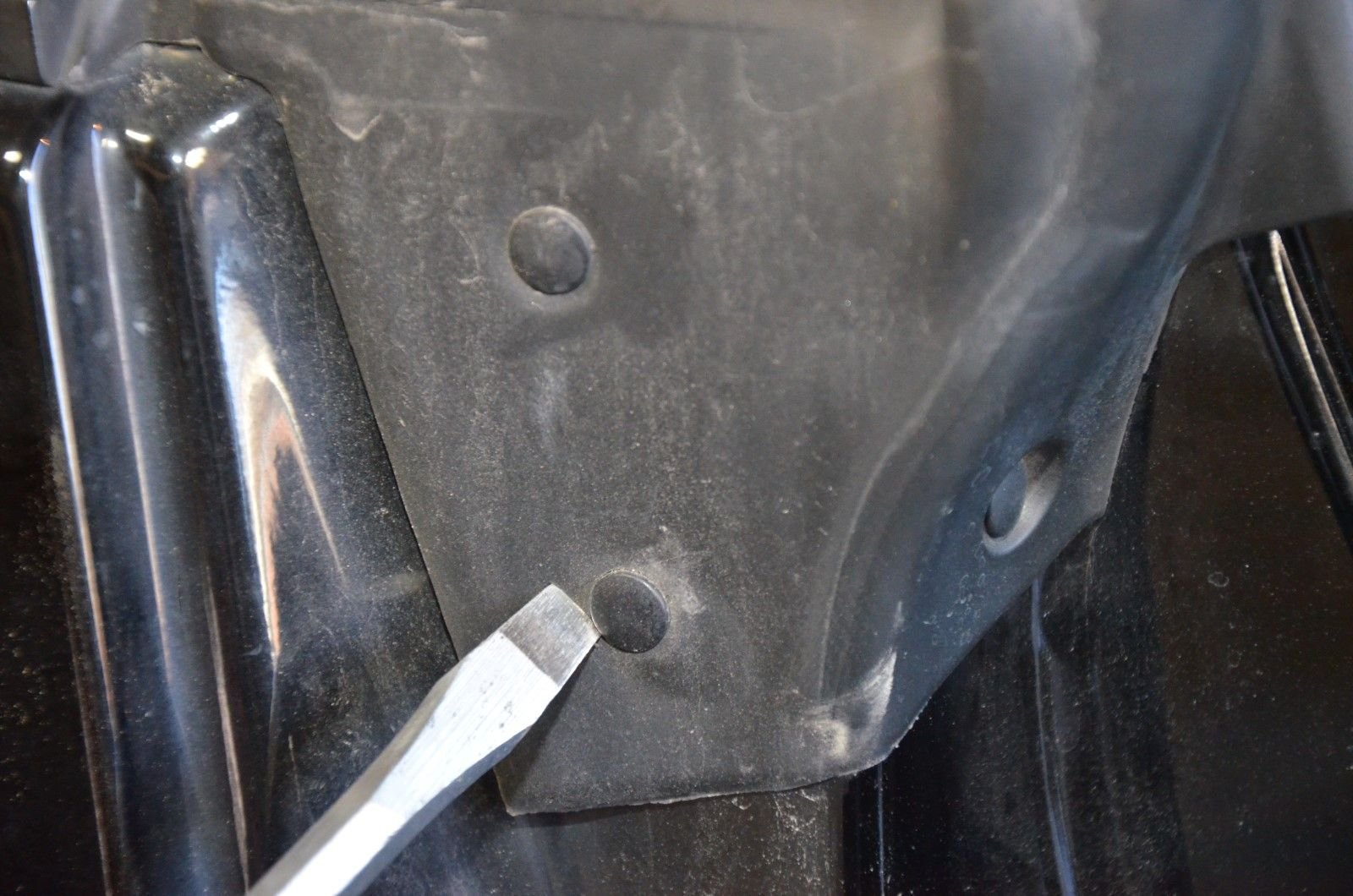

With that rubber seal out of the way, we can pull back the upper rubber seal to reveal... drumroll... A row of Philips screws that mount this exterior trim panel!
Failing to remove these screws (and being very careful for the rest of this tutorial) is the perfect way to pull the mounting lip clean off of your trim pieces.

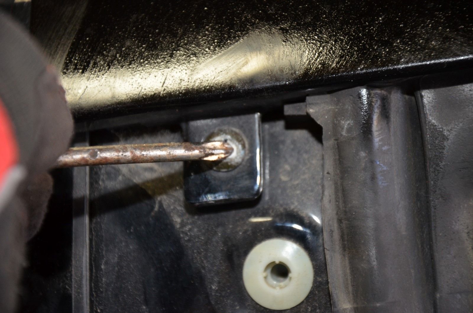

Remove all of these screws and the plastic tab in the center.
Want to break your trim? Leave these screws in.
Leaving in this clip will also break your trim.
Once all the screws and clips are in, you can remove this silver bracket.
This piece secures the roof trim to the vehicle.

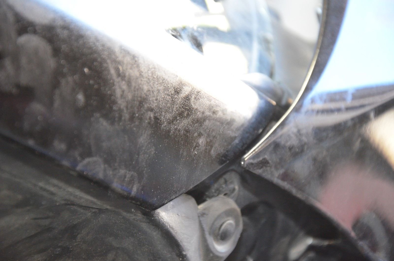

Once all the clips have been popped up, the last thing to do is to pull the trim piece towards the back of the vehicle and off of the last mounting point.
Slide the trim off this mount, DO NOT LIFT IT OFF.
Told you.
There you have it... There's a couple of small parts of the upper rubber seal that you will have to pull off of the vehicle (as the rest of it is sealed to the trim piece.
One RH passenger roof trim panel.... For sale.
And here is the lip on back that we are trying not to break.
You can see the upper rubber seal is actually apart of this trim piece.
If you wanted to remove the trim without the upper door seal, it's possible, but be aware, you will have to rip your door seal. Before you remove the silver bracket, tear the rubber seal out of the door. This will tear it off of the trim panel and the screws will not allow it to break the mounting lip.....
TRYING TO REMOVE THE RUBBER SEAL FROM THE TRIM OFF OF THE VEHICLE WILL BREAK THE MOUNTING LIP.
