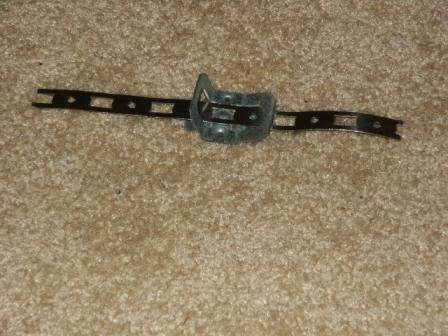

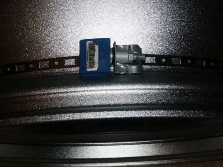

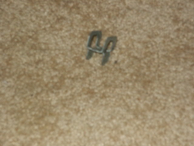

Originally Posted by Integrity
I did use a heavy duty double sided tape as well as the straps. Hopefully that'll be enough. Do you have any pics of the plywood method?
Attached Thumbnails How to make your own APS tire bands...-tps-bracket-1.jpg   How to make your own APS tire bands...-tps3-compressd.jpg   How to make your own APS tire bands...-tps-compressd.jpg   How to make your own APS tire bands...-tps-bracket-compressd.jpg

what peice is that and where can I find it?
plywood spacer. home depot.

That is a brilliant idea Z Boy.
thanx, but i can't take credit for this idea. i borrowed it from another member. i'm just passing it on.
