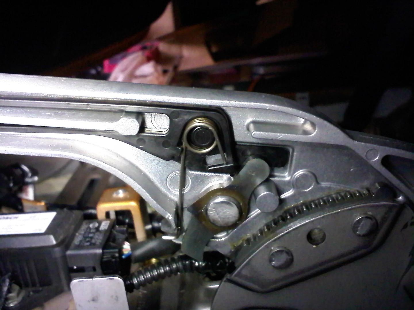

This is what it looks like all taken apart.
With the e-brake button is pushed, it moves the catch lever away from the teeth, thus releasing the rear drums. The spring keeps tension on the button, always keeping the catch lever on the teeth, hence the reason it "clicks" when you pull the handle.
This is the spring that some have removed. Ok, it's the same pic as above, but look at the spring this time!
When the stock spring is removed, the button arm and catch lever just hang free. The idea to wire the catch lever to the button arm is to keep the connection without spring tension, rendering the clicker disabled. I'm sure this works well enough, but basically the catch lever is now just kinda floating there. My rule of thumb has always been to avoid any potential problem, even if it is "just in case". The way I saw it was that a sudden jar or mishap could cause the catch lever to grab a tooth when you don't want it to. That would be a sucky surprise. So I stared at it for about 10 min, then a light bulb went off.
I flipped the stock spring around.
This allows the spring tension to keep the catch lever far away from the locking teeth. I thought I was so smart! Now, I still needed a way to attach the catch lever to the button arm. I tried wire, but then the catch lever would only move about 1-2mm away from the teeth. The angle was goofy and the wire didn't have enough allowance. So now I'm back to square one. I almost gave up here, then another light bulb went off.
