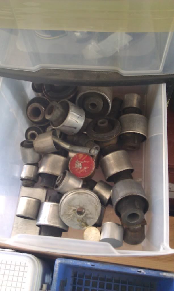

Old Jul 19, 2012 | 03:58 PM
  #157
JasonZ-YA's Avatar
JasonZ-YA
iTrader: (60)
Posts: 11,204
Likes: 32
Originally Posted by JasonZ-YA
I welded mine together to be a quick shop tool.....i have installed i swear about 30 of these whiteline bushings on peoples 350z's...
-J
lol, i ran across this pic...and these are the oem bushings i saved for whatever reason.....
IMAG0671.jpg?t=1342728628
-J
