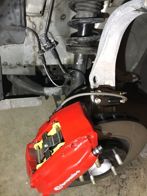

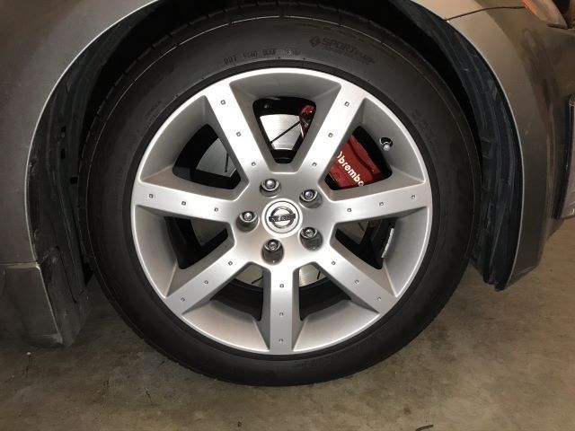

So here are the before and after pictures.
These calipers are not real Brembos. They are pretty much the same visually, 4 pistons and everything, and are not Reman. They are new. It seems the same thing, time will tell.

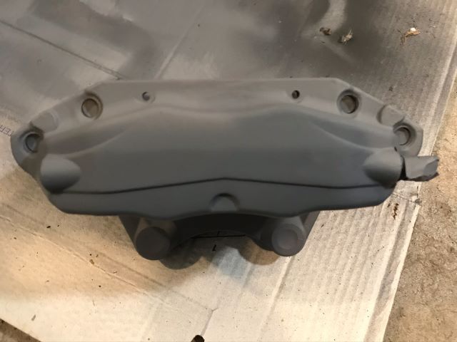

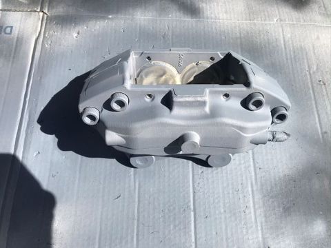

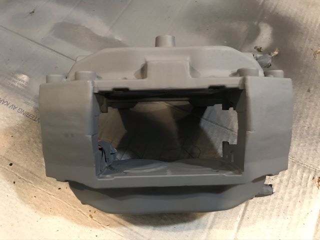

First step was to paint them. And I had the great idea of grinding one of them to make it smoother on the edges. My suggestion: don’t waste your time. Lot of work, spent >50 bucks on Dremel bits, grinder, etc. And you can’t say the difference. And the final result doesn’t look that good either. Forget it.

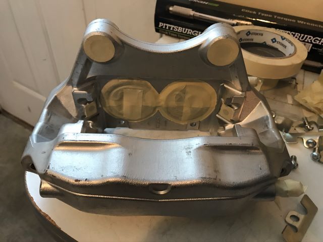

Now, to the paint process. Step 1, masking.

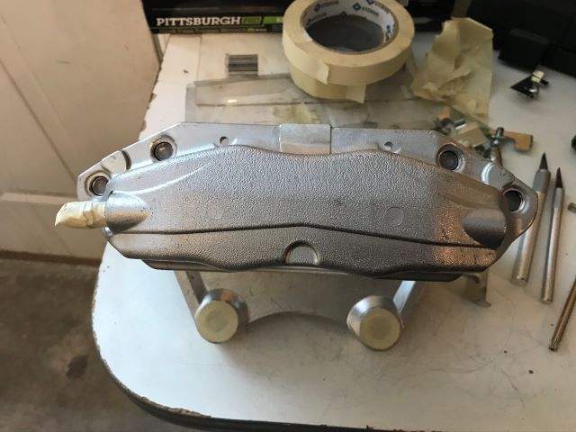

Step 2, primer.

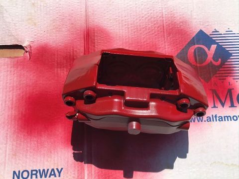

Step 3, the color. Step 4, add Brembo labels, you can find them on e-bay.
Step 5, clear coat. Here are the results.

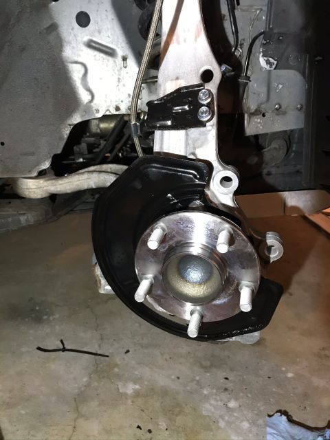

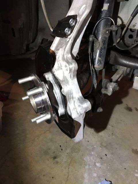

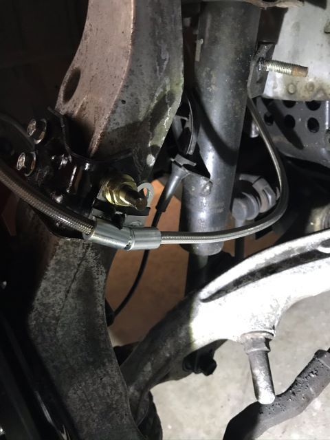

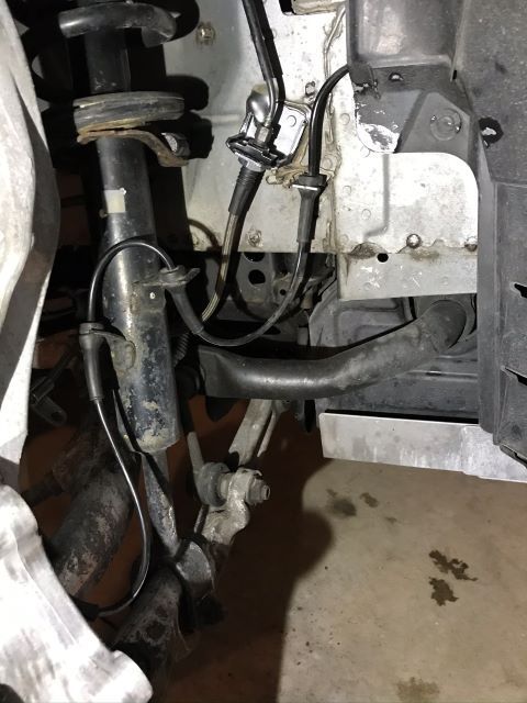

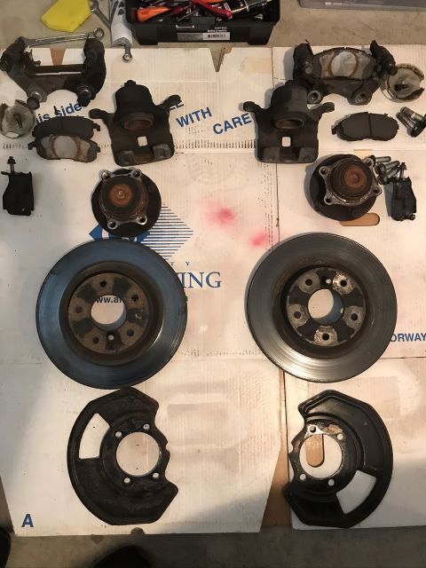

Below, some pictures of the old and new parts. Changed wheel hub and brake lines. Bought Z1 SS brake lines and Z1 Brembo brake rotors (slotted only).

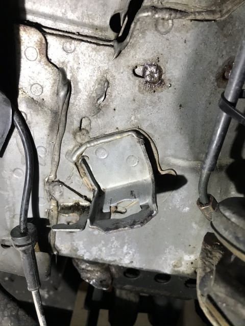

Reused the brake line bracket, but gave it some anti rust paint.
The wheel hubs are Nissan advantage, 78 bucks each. Brake pads are EBC yellow stuff.
Dust shields were sand blasted and painted (with high heat primer, black caliper paint and caliper clear coat). For the front brakes conversion, no need to change the heat shields. The rear ones you need to, though.

The brake feeling is pretty much the same. It looks nicer, yes, but maybe I would get that nicer bite on the track, not sure.

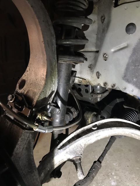

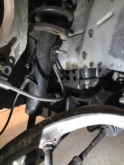

The SS brake lines, not really to my taste; I think it's better to use the OEM or a similar one with the correct bracket (for Brembo brakes, mine is still the single piston one, re-purposed). It came with 2 brakets, but if you use both, I’m afraid you don’t have enough slack for both turning and suspension travel. So I only used one, and tied both together with a zip tie.
Now, since I was going to change the brake lines and calipers, I let all brake fluid drain out, dry, to a bucket. It then took me a while to flush, bleed, then flush, then bleed, then recirculate, then flush, then bleed, then test drive, then bleed again. Not recommended. I still think there are some tiny bubbles in there, I've dreaming about it.
