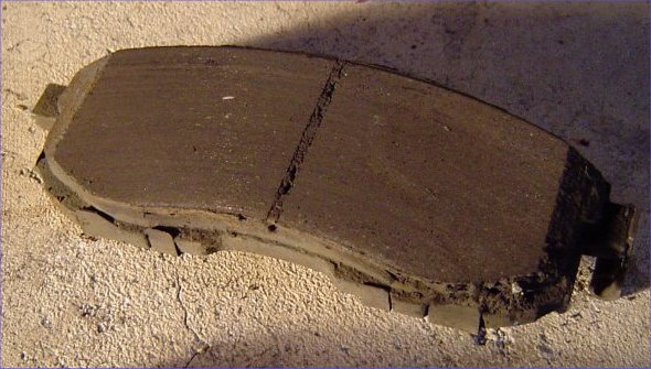

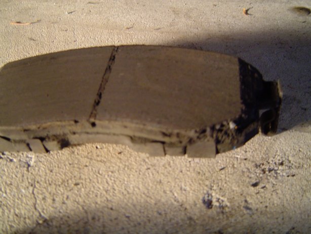

I just spent a few hours inspecting and cleaning all four brakes. Everything looked OK - no cracks, no warping (that I could see). There was a lot more dust on the inner pads, both on the fronts and rears. I knocked the dust off the pads and cleaned everything up.
I put everything back together and took it for a short drive. THe brakes are stopping the car just fine, but I swear I still feel a low rumble that wasn't there before.
Take a look a these pics. The first two are the dust build-up on the inner front pad.

Attached Thumbnails Time for Bigger Brakes?  Did I Fry My Stockers?-brake_3.jpg

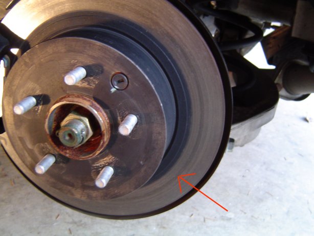

Here you can see a dark line that was on both rear calipers. I never saw it there before - and I just spent some quality time with the rotors a few weeks ago painting the calipers.

you really heated them up, they look like they turned bronze colored. That dark line is proably excess pad material. Thats proably whats causing your rumble. Not a safety issue just a comfort issue. I have heard that you can take a high grit sand paper to the rotors and rub off a layer of pad material but you need to rebed the pads( only something I have heard somewhere)
