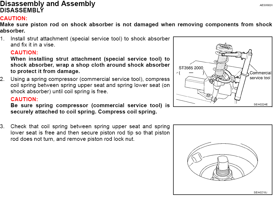

You can take these guys advice, or you can go by the 350Z Factory Service Manual.
Attached Thumbnails Spring Compressor?? and installing springs....-springs.gif

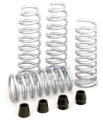

I just ordered springs too (hotchkiss). But I like to know the type of tools needed to install this suckers.
Also, what is the "rubber" like in the picture. I know its some kind of dampening (noise). How does it go in or what will hold it? Please be specific.

That black piece looks like a bump stop. It helps the strut not fully compress when hitting bumps. The 350Z set probably won't come with any. You do have to completely remove the front strut assemblies like in the picture above to remove the OEM spring and replace it. The back is just a couple bolts and the spring comes out and you put in the new one.

just got my teins today... they hint about these rubber things. They supply a chart with how much of a rubber thing should be cut but for the Z, there is nothing listed.
