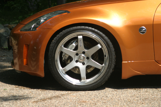

Just a quick note that the 14" kit is truly a show piece and yes it does perform in braking, but if you want to track the car or put smaller rims on for any reason, you will be in trouble. Also the larger rotors add additional unsprung weight to the car and actually hinder performance moreso than the 13" kit. I was happy with the 13'" kit because it:
1. Filled the gap much more so than stock
2. Provided dramatic improvement in braking performance
3. Still allows a 17" rim on the car for tracking, winter tires, drag setup etc...
4. Cheaper than 14" kit
If it is only for looks then this information is not for you. Just an FYI
Do you have more pics of your Stop Tech's on your car that you could post?

Finally took a pic for you
