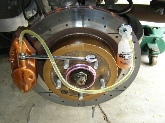

atlsupdawg#2, your shortcut will not work. You will fight a loosing battle with gravity. Just put some rubber caps on the brake lines to prevent leakage. You WILL will still need to bleed the brakes though. It's easy! I use a "One-man" bleeder bottle I picked up at AutoZone. Just open the bleeder about 1/2 a turn, let gravity fill the hose, then get in the car and pump the brake pedal 4 times. Get out and tighten the bleeder. If there are no air bubbles in the clear line, you should be done.
I've bled all 8 of my bleeders over 30 times using this method with great success!
