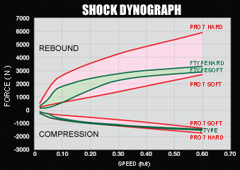

i will say this I am super impressed with the dampning. These have the 12kg spring rates front and rear which is 2kg higher then my JICs. It's crazy but the ride quality is much smoother! stiff and smooth=goodness. I think I'm going to buy the TEAS, for conveinece and I found that the suspension is 12way adj with manual ***** and the full 16way with TEAS

i didn't buy them for road comfort, but that was a huge bonus!! can't say enough of the dampning and I've driven on Tein and JIC coilovers, these=sex (once I get the ride height and noise figured out).
