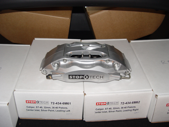

This pic is from a thread that a member posted here a long time ago.
Attached Thumbnails Stoptech ST-40 Piston Sizes for 350Z Front Kit-brakes-stoptech-pistons.jpg
Old Apr 30, 2006 | 02:17 AM
dklau33's Avatar
dklau33
Posts: 516
From: Bay Area
Thanks! If those are the calipers that come with the front 13" 350Z kit then I have my answer.
