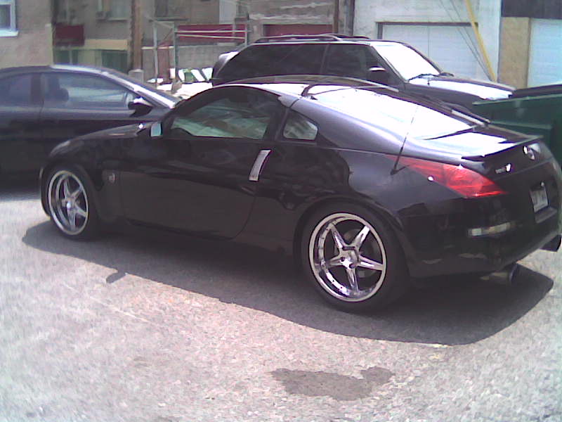

Ok guys start bashing away. Here s my problem. Nissan told me because of my new mags, after driving my rotors cool off too quick causing them to bend.lol. I ve had them grinded to shape twice costing 160$ each time. Any one recommend any good rotors that won t cause this problem?Preferably cross drilled????thanks guys.

your wheels had NOTHING to do with your rotors warping...the fact that you cut them twice did.
Most times, stock rotors can be cut once, though as Jason said, it depends what matters is what thickness they were before you cut them.
There are lots of good rotors out there for the car. I recently swapped over the DBA's on my car, and they've been terrific

given his picture though, I think I know the wheel he is running, and they are lighter than many wheels people run on these cars.
the cutting of the rotor 2 x caused the issue, not the wheels
