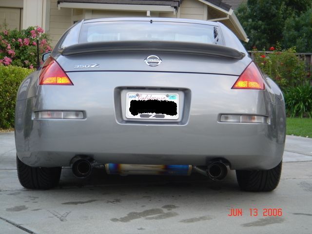

does it look cambered though drifter23?

The rear tires have a slight angle to them. I have attached a pic of my car for your viewing pleasure. But, I don't know if the picture will help you out.
