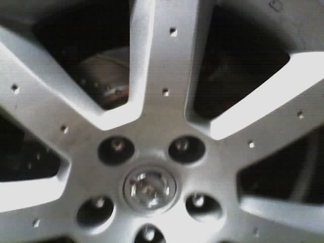

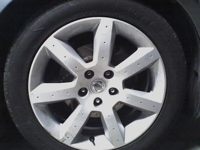

Me and my dad struggled to get my new rotors on the front tonight, took us quite a bit of time. But hey, father son time eh?
We were kinda worried when we took it out for a test drive and heard very weird slipping noises. It only occured at low speeds, but it definatly wasnt normal and not tolerable.
It ended up only being the "gold" surface of the rotors wearing off (they look MUCH better now)
I took a few pics and the quality is horrible, but I thought I'd share. (I took them with my razr)
PS We plan to install rear rotors/pads tomorrow, and get this behind us.
On a side note, We are pretty sure that Firestone (tire shop) installed my pads incorrectly. They put the wrong pads on the inside (the same pads as the outside), it didnt slide over the little metal spring part. We will be making a pass back to the firestone to have a chat with them.
Attached Thumbnails 2003 Brake Kit-10-11-06_2047.jpg   2003 Brake Kit-10-11-06_2049.jpg   2003 Brake Kit-10-11-06_2050.jpg

Great !!!! And u put the fronts on facing the right direction ( the drill holes ) Congrats !!!!!
