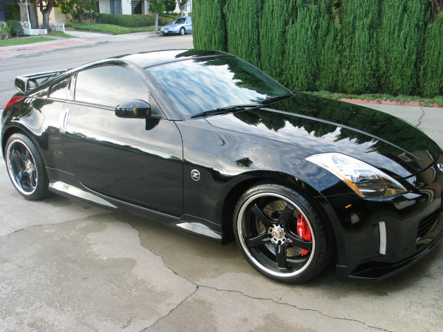

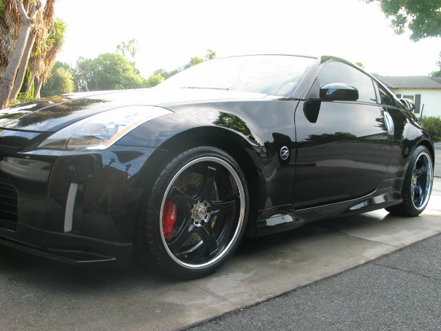

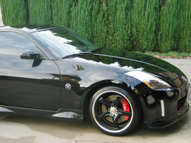

Once I got the right parts installation was an ease. Total time for installation: 2.5 hours. Total wait time, for parts,corrections,running around town,almost 1 month. But in the end they are worth the pain and suffering. Almost gave up on entire process. Thanks djparis!!

You may want to check your rotor direction. It looks like they may be installed backwards. Heres some comparisons to other installed Brembo drilled kits:
Brembo rotors are directional like ours and can for the most part be installed with the same regard to internal vane direction as listed here:

Yeah, looks like your rotors are on backwards.

Yes, rotors are backward. Here's mine w/ same exact kit:

Check the way the cooling fins face to see if they are on backwards.

Thanks guys!! Being switched as I type!!
