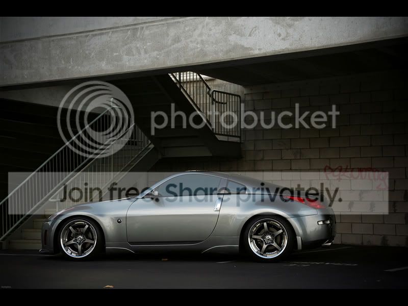

You can tuck the front...but with the back, you're going to have to modify the bumpstop or shave it down a bit.
Here is my rear at full drop: (front can go another inch or so)

Man your ride looks sexy
It's not the bump stop that you shaved (though I understand why the part could be mistaken for that), they are the upper spring seats. Your bumpstops are located inside the shock dust shields front and rear.
Great looking pics btw, well done.
Thanks for clearing that up!
That's what I meant, the "spring seats" where the rear spring's coilover sleeves sit.
My rear is lowered all the way without modifying the spring seat yet.
>>>"so if all intent is to tuck the wheels, would TEIN Basics be adequate?"
No, you would have the shave a little off the rubber spring seat. The Basics at full-lower, still hover about a quarter inch off the wheel with the 275/35/19 on a 19 by 10.5 wheel.

great pic!
