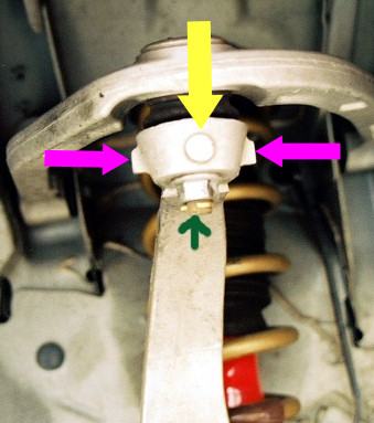

Not normally, and whatever anyone does, do not use a generic pickle fork, the boots will get trashed.
If it is in good shape it will pop just by removing the bolt. If not, a single sharp hammer blow on the outward facing edge on the flat spot of the top arm should do it (at the yellow arrow). Although I have not seen it on the Z, if that still does not work, two hammers hitting the sides of the arm simultaneously on the flat spots should make it pop (pink arrows). There is no need to beat the crap out of it though and if it is really stuck, you'll need the proper service tool.
+1. I've done this before. Once the boot is severed, all the inner grease oozes out.
