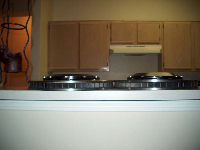

Well, some of you may have read my post about the shock mount being backwards on the front Nismo S-tune, and now I am installing the Stoptech Front BBK.
One of the hats on the rotors is incorrect (too tall by about 1/4"-1/2") and it rubs against the caliper bracket adapter. So, my car will have to sit on jack stands for a while longer while I wait for the part .
The good news is that I contacted Stoptech last night via email and I already recieved a response, and the guy said they would contact me on Monday and get me the correct part (hat).
For those that care, the incorrect part does not have a part # on the hat (left side rotor), and correct hat has part # 646-54-1 (it is on the right side). Here is a pic (low res. because I emailed them).
The rotor on the right is incorrect (left side rotor).....
Attached Thumbnails Ahhh....  More install problems: Stoptech-rotor1.jpg

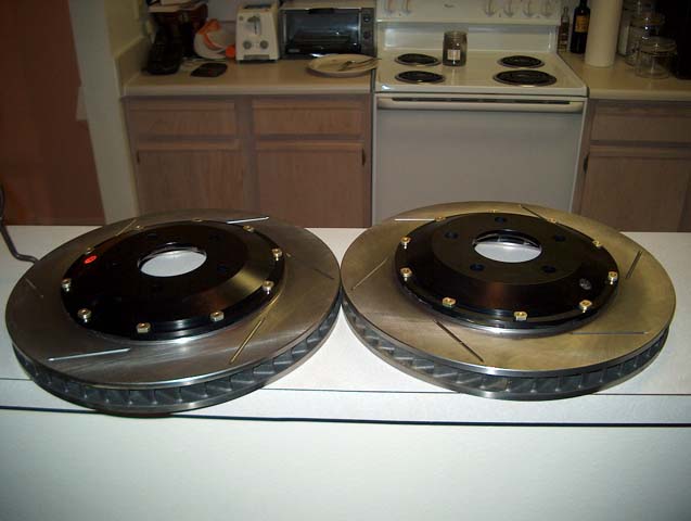

One more....
Attached Thumbnails Ahhh....  More install problems: Stoptech-rotor2.jpg
