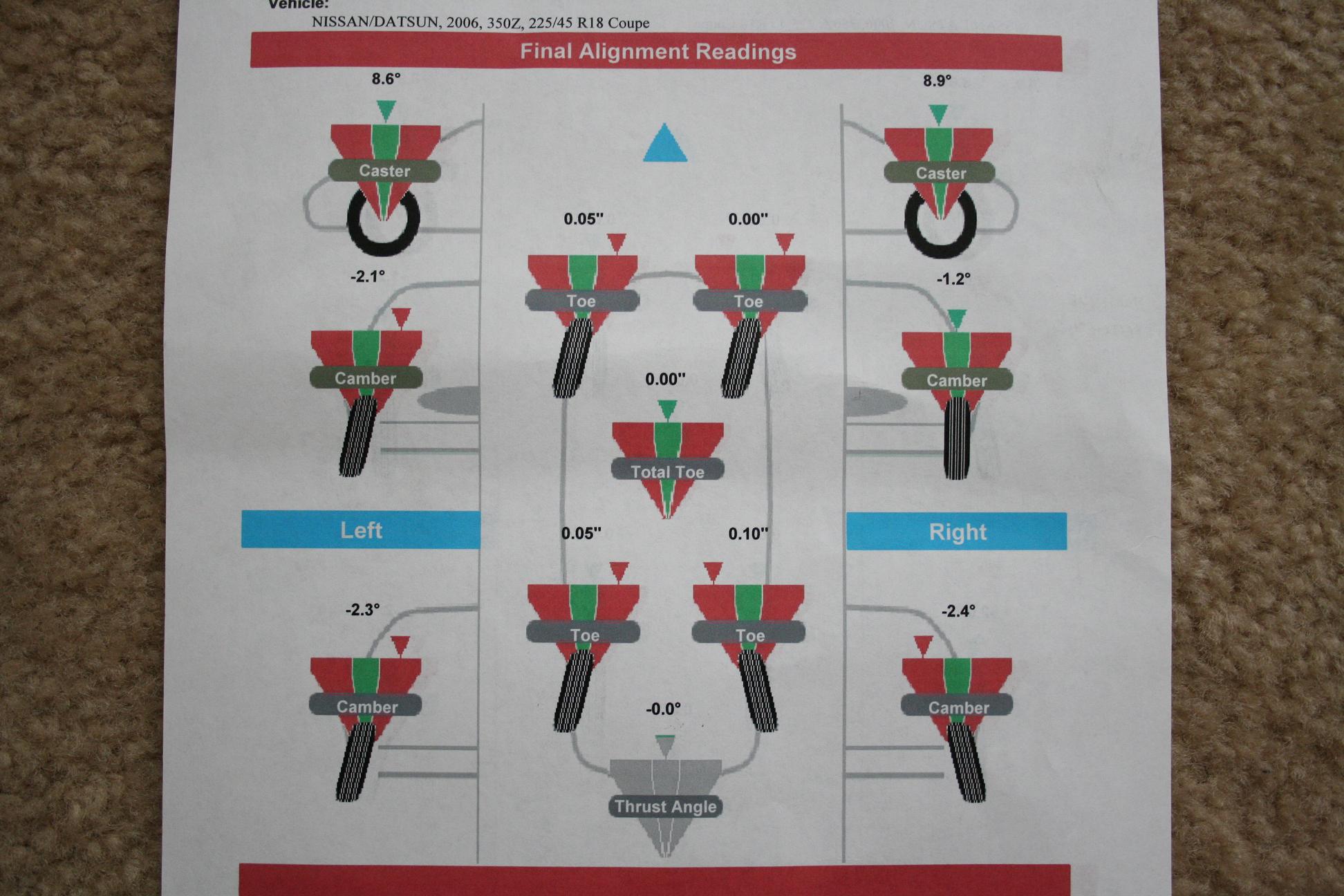

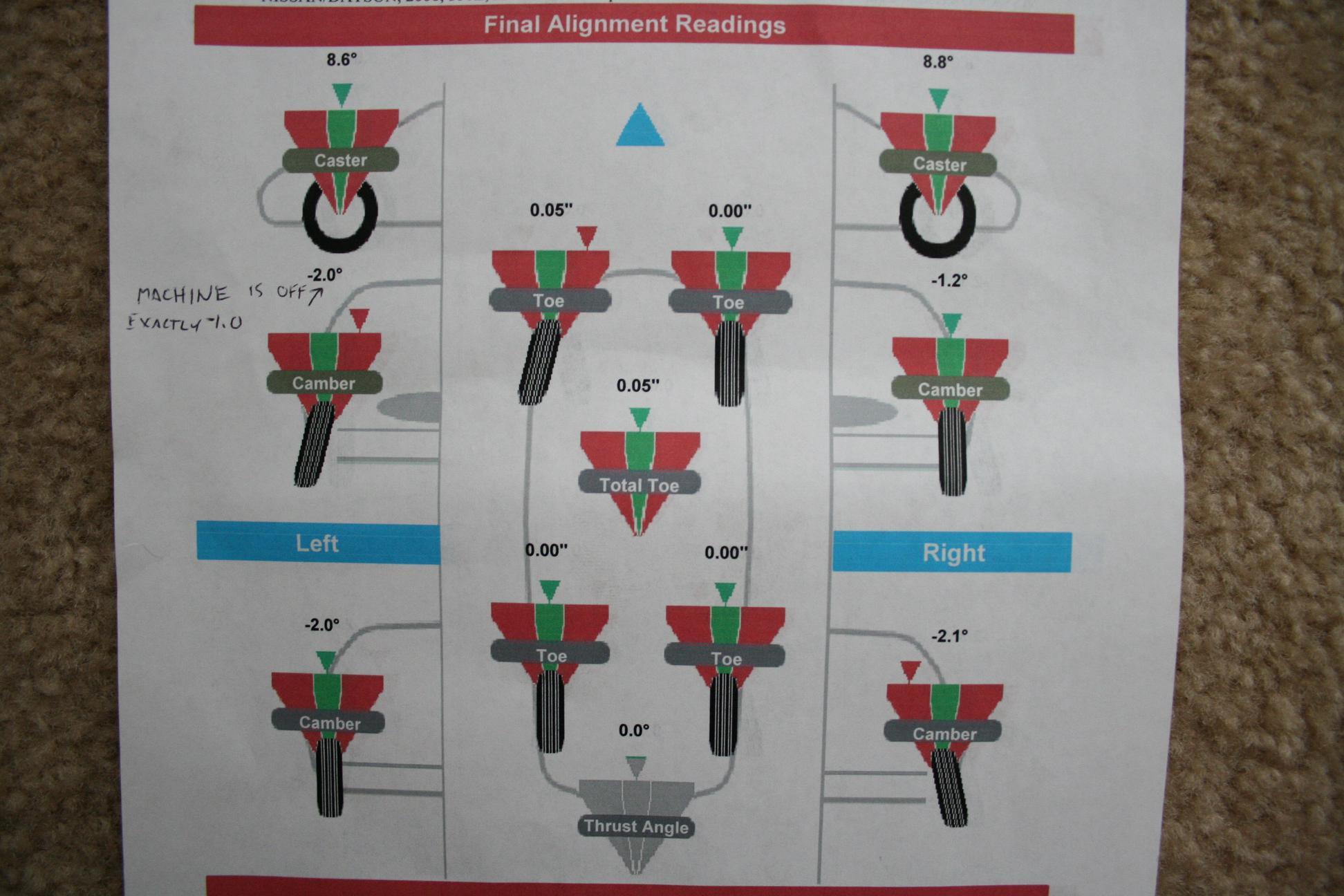

Before and after alignment
Attached Thumbnails Alignment after Tanabe GF 210 installed-before.jpg   Alignment after Tanabe GF 210 installed-after.jpg

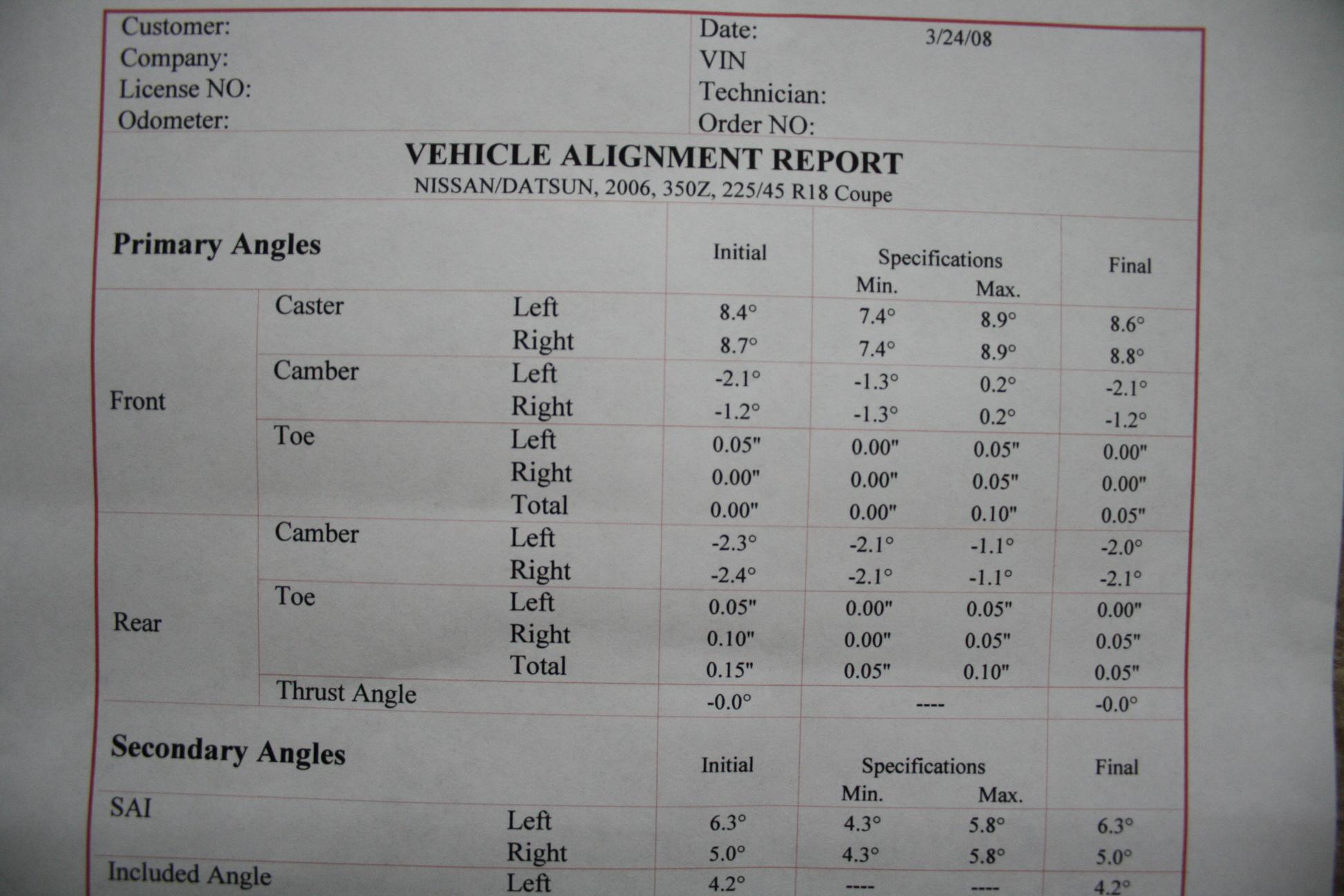

This is the specs for 06 I'm not sure if its the same with yours.

Originally Posted by Spoiled Z
dutchboy350Z - show me the specs for our cars and I'll gladly have them realign it again.
The bottom photo ARE @ stock specs. In the front .04 toe. In the back 0.08 toe and -1.6 degrees of camber.
That alignment sheet looks highly suspect. Did you actually see them perform the alignment? It looks like the may have fudged the numbers and charged you for something they didn't perform.
For example: if your left and right rear toe was 0.05 and 0.10. Why did they adjust one from 0.05 to 0.00. They basically went from one end of the spectrum to the other. For a near perfect toe shouldn't it have been 0.025 for each?
BTW I've never heard or read that having 0.00 is an acceptable setting for toe.
LOL no I was there standing right outside. He even made me go under the car cuz I wanted him to show me what we was doing. I had it done at tire king and I purchased 3 years unlimited alignment. I can go back everyday if want to. But you can admit I am within specs right?
Barely ... having -2.1 degrees of rear camber (unless you autocross your Z) is IMO not acceptable. Also running 0.00 toe doesn't seem correct. Others can chime in for that.
You might have to bite the bullet and get a rear camber/toe kit installed.

Originally Posted by johzp
How adjustable are the fronts? I know the rears are about .5 degree.
A 350Z's stock front end camber and caster can NOT be adjusted. You'll need aftermarfet front camber arms installed.
As for what OEM specs should be, no offense to the OP but I'll trust PTuning's (A shop that strictly deals with performance vehicles) specs over Tire King's.
If you look at my alignment specs. Front toe should be between 0.00 and 0.08. Rear toe should be between 0.04 and 0.12, and rear camber should be between -1.1 and -2.1.
