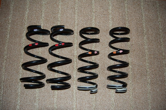

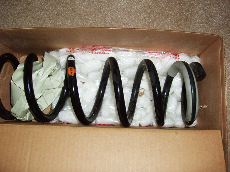

Can you tell me if the front spring rates for 2007-2008 are still 314?
2003-2006 have front spring rates of 314.
they can come in one white dot(rare--2003?)
1 pink and 1 orange dot 2004-2006
1 white and 1 orange dot 2007-2008
I'm wondering if the WHITE dot (instead of pink dot) means the 2007 and 2008 fronts had a "revision"
the only revision I know of was for the REARS in 2004.5 from 342 to 427
thanks so much for your help.

fronts still 314 spring rate for 2007-2008
Old Mar 30, 2008 | 09:13 PM
Texan1's Avatar
Texan1
Joined: Mar 2008
Posts: 52
From: Houston
Ok, I think I have my answer.
Originally Posted by Gsedan35
In case this helps you, here's a list.
Oem spring rates
350Z 2003/2004
Front:314 Rear:342
350Z 2004.5 to 2008
Front:314 Rear:427
https://my350z.com/forum/brakes-and-suspension/342435-shocks.html
