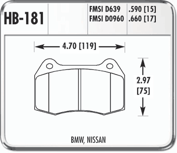

anyone have a nice link or illustration showing the pad dimensions of the front brembo brake pads?

From the Hawk website...

i love you man. if you're ever in kc i owe you a beer.
i looked at a ton of pad manuf websites, but never tried hawk.
edit. same pad as used on the e31 8 series w/ brembos. hmmmmmm
edit, edit. same rotor diameter/thickness between the two--obviously the hub bolt pattern is diff, but thats not what i am getting at. i will see what my cost is on a caliper. i think there is one laying around the shop.

remember too that there are other cars that use that same shape pad - but not necessarily the same caliper. Mounting can differ, as well as piston diameter.
